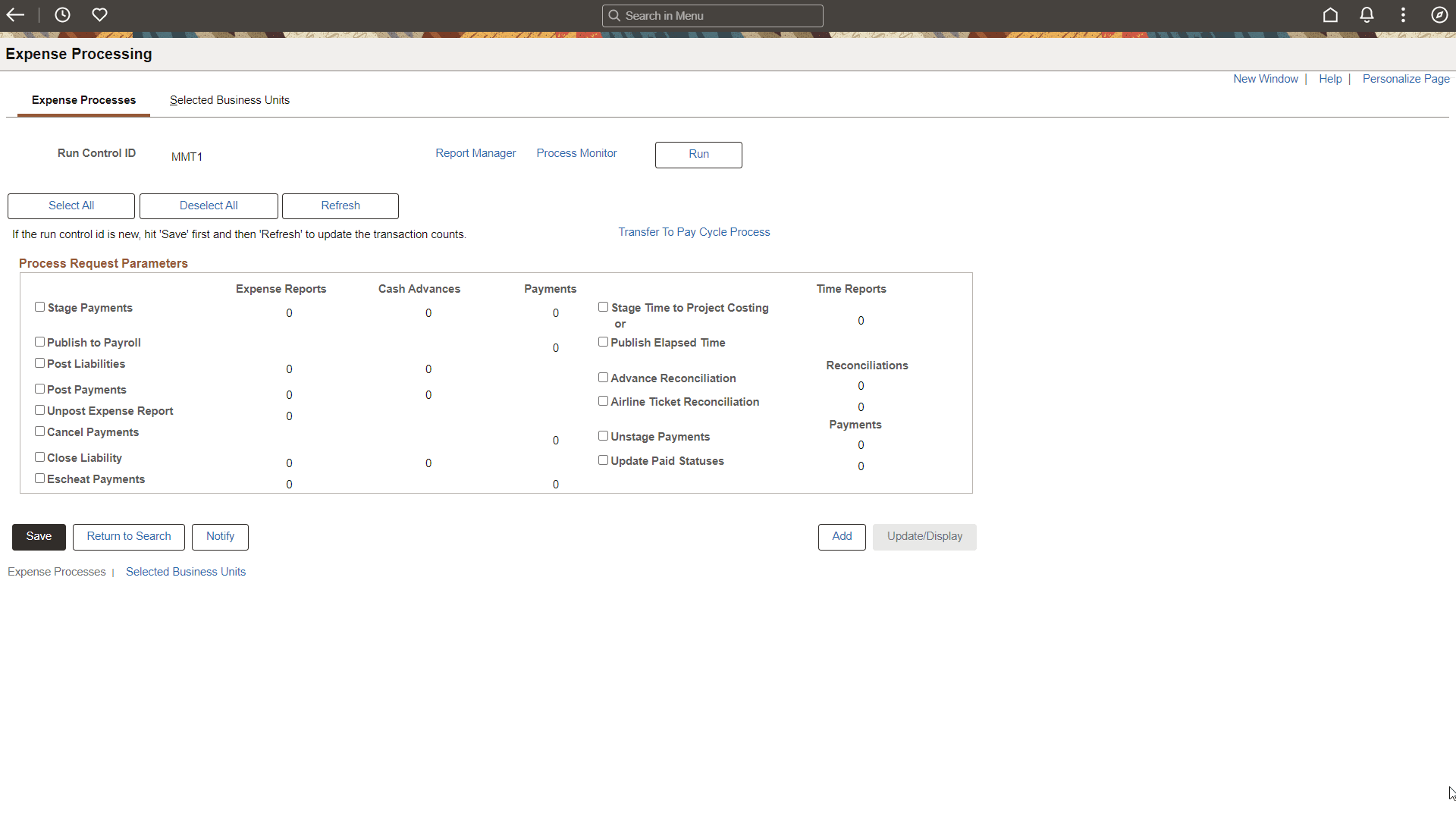

Expense Processes Page
Use the Expense Processes page (RUN_EXTRNPRC) to run jobs that are integral to the expense process. The Process Scheduler runs the EX_TRAN_PRCS process, which drives other programs, depending on the options selected.
Navigation:
Travel and Expenses, and then Process Expenses, and then Expense Processing, and then Expense Processes
This example illustrates the fields and controls on the Expense Processes page.
Expense Processing
Field or Control Description
Refresh
Click to re-display the Expense Processes page and update the number of expense reports, cash advances, payments, time reports, reconciliations, and payments that await processing. Save a new run control before clicking Refresh to update the transaction counts.
Transfer to Pay Cycle Process
Click to access the Pay Cycle Manager in PeopleSoft Payables.
Stage Payments
Select to move expense transaction data into staging tables for payables or payroll processing.
Publish to Payroll
Select to trigger an application message that publishes expense data to your payroll system for employee reimbursement.
Post Liabilities
Select to create rows in the EX_ACCTG_LINE table for the journal generator to send to PeopleSoft General Ledger to post liabilities. The Post Liabilities process generates accounting entries for expense reports, cash advances, and reconciled cash advances.
The system adds accounting entries for expenses and for cash advances that you reconciled on the Cash Advance Reconciliation page.
OR: The system adds accounting entries for expenses and reconciled cash advances.
Post Payments
Select to create rows in the EX_ACCTG_LINE table for the journal generator to send to PeopleSoft General Ledger to post payments.
Unpost Expense Report
Select to reverse accounting liability entries for expense reports that are marked for unposting. You can edit and resubmit unposted expense reports.
Cancel Payments
Select to reverse accounting entries for payments that you canceled in PeopleSoft Payables.
Note: If you selected the Do Not Reissue/Close Liability option on the PeopleSoft Payables: Cancel Payment Page, the Cancel Payments process in PeopleSoft Expenses performs the close liability step and reverses the amounts. If you use PeopleSoft Commitment Control, you must manually run budget checking on the Request Budget Check page and select Cancel Void Expense Reports as the transaction type. If you selected the Re-Open Voucher(s)/Re-Issue option on the PeopleSoft Payables: Cancel Payment Page, the Cancel Payments process in Expenses will not perform the close liability step.
Close Liability
Select to reverse liability entries for cash advances and expense reports that are marked for closure.
Stage Time to Project Costing (Stage Time and Expense to Project Costing)
Select to run the EX_PC_TM_STG process to move time report data to staging tables for processing by PeopleSoft Project Costing.
If PeopleSoft Project Costing is installed and you selected the Enable One Step Staging check box in the Installation Options - Expenses page, the EX_PC_TM_STG process automatically calls the PC_EX_TO_PC process. If you have not selected the Enable One Step Staging check box, you must manually run the PC_EX_TO_PC process after the EX_PC_TM_STG process completes.
Note: To use the one-step staging process, use the EX_TO_PC run control ID that PeopleSoft Expenses delivers. A corresponding run control ID also exists in the PeopleSoft Project Costing Cost Collection process. The one-step staging process runs properly only if matching run control IDs exist in both PeopleSoft Expenses and PeopleSoft Project Costing.
Publish Elapsed Time
Select to trigger an application message that publishes elapsed time reporting data to PeopleSoft Time and Labor for billing purposes.
Select to update expense tables to indicate that cash advances are reconciled against corresponding expense reports.
Airline Ticket Reconciliation
Select to update expense tables to indicate that airline tickets reconciled against expense reports.
Unstage Payments
Select to move expense transaction data out of staging tables that have not been selected by the payables or payroll systems.
Update Paid Statuses
Select to change the status of cash advances or expense reports to Paid. Run this process to mark transactions as Paid prior to posting payments without generating accounting lines.
Note: Posting payments also changes the status of cash advances or expense reports to Paid.
Escheat Payments
Select to run the Escheatment process for PeopleSoft expense reports. This process changes the status of the expense report to Escheated Payment and creates accounting entries to reverse the liability.
Note: Do not run any other Expense process while running the Escheatment process. The Escheatment process applies to only expense reports. It does not apply to cash advances.
For additional information about the Escheatment process, see Processing Escheated Payments.

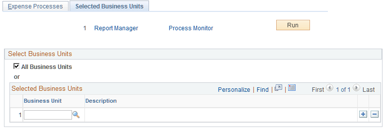

Selected Business Units Page
Use the Selected Business Units page (RUN_EXTRNPRC_BU) to specify business units for expense processing.
Navigation:
Travel and Expenses, and then Process Expenses, and then Expense Processing, and then Selected Business Units
This example illustrates the fields and controls on the Selected Business Units page. You can find definitions for the fields and controls later on this page.
Select All Business Units or a specific business unit to process, as defined on the Expense Processes page. Add or delete rows to create a list of business units for processing.
