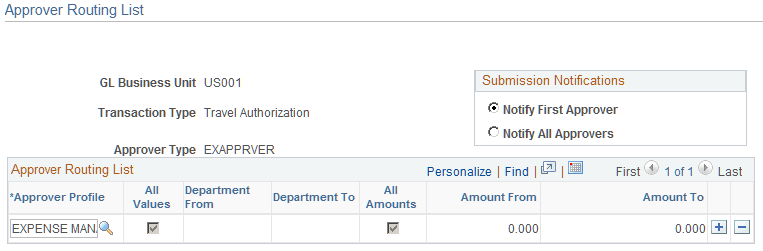

This example illustrates the fields and controls on the Approver Routing List page. You can find definitions for the fields and controls later on this page.
Field or Control Description
Submission Notifications
Select how you want the system to send out approver notifications. Options are:
  • Notify First Approver: Select to notify the first approver in the list when an employee submits a transaction.
    As each approver makes an approval action, the system sends a notification and routes the transaction to the next approver on the list. The sequence of approvers is top down, meaning that the system notifies the first approver on the list, then the second approver, and so on until all approvers process the transaction.
  • Notify All Approvers: Select to notify and route transactions to all approvers in the list when an employee submits a transaction. This option allows any approver to access and approve the transaction at any time.
Approver Profile
Select an approver profile. PeopleSoft Expenses determines the approval order based on the order that you enter the approver profile lines. The approval process starts with the first row, regardless of the values in the From and To columns. If you insert a new row between two existing rows, PeopleSoft Expenses updates the order of the approvals.
For example, if an approval sequence starts with Department Manager on the first row, then Director on the second row, when you insert a row for Vice President between the two, the Vice President in the new row now becomes the second approver.
Note: Only users who are assigned to profiles supporting the same routing ChartFields may be selected.
All Values
Select to use the full range of ChartField values for the assigned routing ChartField. If you select the All Values check box, PeopleSoft Expenses disables the [ChartField] From and [ChartField] To fields.
Enter a range that corresponds with the routing ChartField that you selected on the Define Approver Types page for the approver type. For example, if you selected Department as your routing ChartField, PeopleSoft Expenses displays Department From and Department To headings.
If you use amount-based rules for the transaction and want to apply different rules for different departments or any other ChartField that you selected for routing on the Define Approver Types page, you can enter a range that corresponds with the routing ChartField, then enter the from and to amounts for the rule. This is the only time that you can enter routing ChartField values.
These fields are not available if you selected the All Values check box.
All Amounts
Select to use the full range of monetary amounts or hours, depending on the transaction type. If you select the All Amounts check box, PeopleSoft Expenses disables the Amount From and Amount To fields.
If you selected Monetary Amount Based as the unit of measure for the transaction type on the Transaction Definition page, PeopleSoft Expenses displays the Amount From and Amount To headings where you can enter a monetary range.
