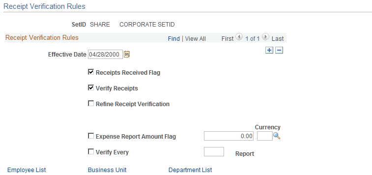

Use the Receipt Verification Rules page (EX_RCPT_VER_RULES) to create criteria to track receipts.

This example illustrates the fields and controls on the Receipt Verification Rules page.
Field or Control Description
Receipts Received Flag
Activates a check box on the expense report when the report is audited. Auditors select this option to indicate that all receipts for the expense report are submitted.
Verify Receipts
Requires that receipts are validated on all expense reports by having employees or someone in your travel and expense department check off transactions as they are matched with employee receipts.
Refine Receipt Verification
Select to require receipt verification for specific circumstances.
When you select this option, the system activates other options in this section. You may require receipt verification to occur when only one or both of the following conditions exist:
Expense Report Amount Flag: The expense report exceeds a specified total. Enter the maximum amount in the space provided and select the appropriate currency. Any expense report that exceeds the specified maximum will require verification of receipts.
Verify Every Report: Enter a number to specify how often to select an expense report to verify receipts.
Employee List, Business Unit, and Department List
Select to build the appropriate receipt verification lists.
