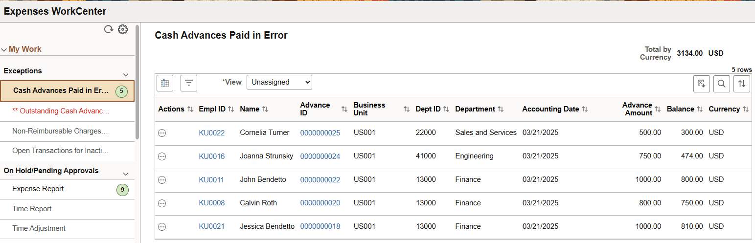

This example illustrates the fields and controls on the Expenses WorkCenter - Cash Advances Paid in Error page when using Work Management.
Expenses WorkCenter - Cash Advances Paid in Error (Work Management Enabled)
When Work Management is enabled for an exception, there are two changes on the WorkCenter page:
  • The View drop-down box appears above the grid.
  • Additional action options are added to the Actions button.
    The original action options remain. The additional (Work Management) action options depend on the View option selected.

Work Management Example for Outstanding Cash Advances
The following example explains how you might approach a long list of outstanding cash advance transactions.
Upon enabling Work Management for outstanding cash advances you have a list of nine transactions:
Your first step might be to inactivate all transactions that are NOT true outstanding cash advances. For example, you notice Sonya Vincent (row 2) is no longer with your company. You've verified that the $400 advance was deducted from her final paycheck.
To do this:
  1. Select the Actions icon from the Unassigned view.
  2. Select Mark as Inactive.
  3. In the Exception Comments window, enter text to indicate why you are inactivating the exception, such as, "Sonya Vincent is no longer with the company and the $400 advance was deducted from her final paycheck."
  4. Select Done.
    When you change the View to Inactive, you see this exception.
Now you're left with eight exceptions in the Unassigned view. There are two transactions where you want to notify the employee's manager. To do this:
  1. Select the Update Selected Rows icon.
  2. Select the check box for the last two rows (William Scott and Fred Sherwood).
  3. Select the Actions button.
  4. Select Notify Manager.
  5. In the Exception Comments window, verify the Follow Up Date, which defaults from the Work Management page.
  6. Enter a comment that describes your action, such as, Notified manager that this cash advance is overdue. Follow up in seven days.
  7. Select Done.
  8. Click OK to the verification message.
    These transactions move to the Assigned to Me view until the follow up date is reached. When the follow up date is reached, the system moves the transaction into the Unassigned view.
You now have six exceptions that appear in the Unassigned view.
