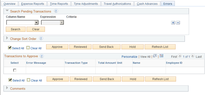

This example illustrates the fields and controls on the Approve Transactions - Errors page. You can find definitions for the fields and controls later on this page.
Field or Control Description
Description or Transaction ID
Click the link to access one of the following pages, depending on the transaction type:
  • Expense Report Summary page.
  • Approve Cash Advance Report page.
  • Travel Authorization Summary page.
  • Time Report Summary page.
