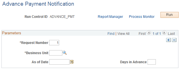

Advance Payment Notification Page
Use the Advance Payment Notification page (ADVANCE_NOTICE) to send remittance advice for SEPA direct debit collections.
Navigation:
Financial Gateway, and then Process Payments, and then Advance Payment Notification, and then Advance Payment Notification
This example illustrates the fields and controls on the Advance Payment Notification page.
Advance payment notifications are sent for future collections to satisfy the SEPA requirement to send prior notification of intended collection instructions to the bank. You can choose to send the notification on a specific date or a specified number of days in advance of payment. Processing instructions are sent to the ADV_NOTICE Application Engine program.

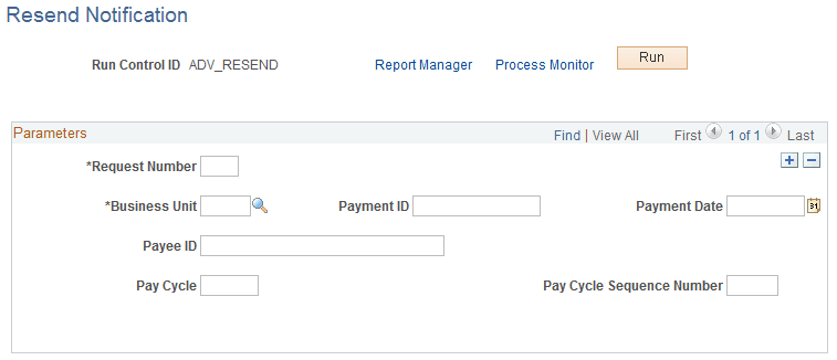

Resend Notification Page
Use the Resend Notification page (RESEND_NOTICE) to resend advice notification.
Navigation:
Financial Gateway, and then Process Payments, and then Resend Advice Notification, and then Resend Notification
This example illustrates the fields and controls on the Resend Notification page. You can find definitions for the fields and controls later on this page.
Enter the parameters and click Run.
