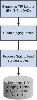

Using the Expenses Transaction in Progress (EX_TIP_LOAD) Application Engine Batch Process
The Expenses Transaction in Progress Loader application engine (EX_TIP_LOAD) enables users to run a batch process to load a large amount of transaction in progress data from PeopleSoft Expenses. Using this process decreases the amount of time it takes to load the transactions in progress from the feeder systems to the TIP staging tables and display them in the Project Costing Transaction in Progress page.
When the EX_TIP_LOAD application is run, it deletes the staging tables, inserts any new TIP exceptions, and populates the EX_TIP staging tables so that you can search for and display these PeopleSoft Expenses transactions in progress on the Transactions in Progress page in PeopleSoft Project Costing.
This diagram describes the Expenses TIP Loader process flow to the staging tables.

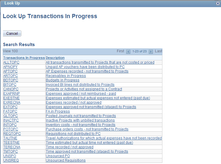

Understanding How to Search for Transactions in Progress
To view PeopleSoft Expenses TIP pagelets, you must add a TIP stage type for each of the 6 expense reports and time reports. Select Travel and Expenses, Real-Time Analysis, Review Transaction in Progress and click the Add a New Value link. Click the Look up icon to obtain the search results. After selecting a TIP stage type, you can specify your search criteria defaults in the Transactions in Progress - Expenses (Details) page.
TIP stage types for PeopleSoft Expenses are:
  • EXESTNE
  • EXRECNA
  • EXAPRNP
  • TEESTNE
  • TERECNA
  • TAUTNE
This example illustrates the fields and controls on the Look Up Transactions in Progress search page.
Choose a TIP link, click the Add button, and select the link again from the search results to go to the (Details) Page and specify your default search criteria.
Although there are 23 TIP stages listed; only 6 belong to PeopleSoft Expenses. If you select a PeopleSoft Project Costing TIP stage, the Project Costing TIP inquiry page appears.

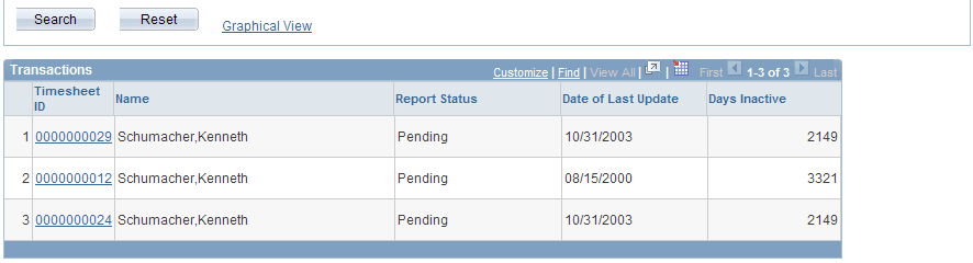

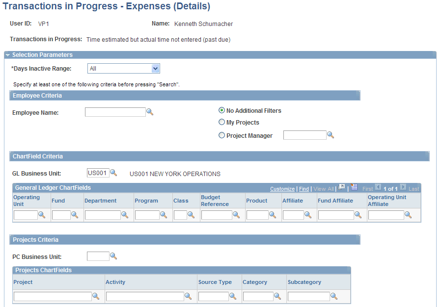

Transactions in Progress - Expenses (Details) Page
Use the Transactions in Progress - Expenses (Details) page (EX_TIP) to add transactions in progress, specify criteria, and click Search to display a list of expense and time report transactions in progress.

This example illustrates the fields and controls on the Transactions in Progress - Expenses (Details) page (1 of 2). You can find definitions for the fields and controls later on this page.
This example illustrates the fields and controls on the Transactions in Progress - Expenses (Details) page (2 of 2). You can find definitions for the fields and controls later on this page.
This page uses fields that are common to other pages discussed in this topic. Refer to the beginning of the topic to review descriptions of these common elements.
You must specify at least one of the following fields in order to process your search: GL Business Unit, Project Costing Business Unit, My Projects, Project Manager, or Employee Name.

Enter the remaining search criteria to filter transactions in progress. Click the Search button for PeopleSoft Expenses to retrieve and display a list of transactions in progress.
Note: PeopleSoft Expenses saves your selection criteria (by User ID and TIP stage) so you do not need to re-enter the criteria each time you access this page.
Graphical View
Click to see the Transactions in Progress - Expenses (Graphical) page. This link only appears if there is data in the Transactions grid.
Report ID
Click to drill down to the Expense Reports or Time Reports Detail page. Click the Return to TIP Inquiry Page link to return to the TIP Inquiry page.

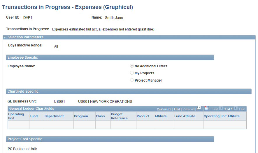

Transactions in Progress - Expenses (Graphical) Page
Use the Transactions in Progress - Expenses (Graphical) page (EX_TIP2) to display a graphical view of expense and time report transactions in progress.
Navigation:
Travel and Expenses, and then Real-Time Analysis, and then Review Transaction in Progress, and then click the Graphical View link
Manager Self-Service, and then Travel and Expenses Center, and then Analysis, and then View Transactions in Progress, and then click Search, and then then the Graphical View link.
This example illustrates the fields and controls on the Transactions in Progress - Expenses (Graphical) page (1 of 2). You can find definitions for the fields and controls later on this page.
This example illustrates the fields and controls on the Transactions in Progress - Expenses (Graphical) page (2 of 2). You can find definitions for the fields and controls later on this page.
Expand Selection Parameters to display the filtering options that were used to select the transactions in progress for the chart. Note that those parameters are now read-only.
Click the Detail View link to go back to the Transactions in Progress - Expenses (Details) page.

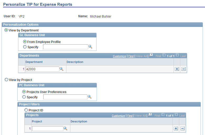

Personalize TIP for Expense Reports Page
Use the Personalize TIP for Expense Reports page (EX_PE_TIP_PRS) to define default display information for TIP pagelets for expense reports.
Navigation:
Click the Customize icon on a TIP pagelet for expense reports.
To access the administrator pages, go to Set Up Financials/Supply Chain, and then Pagelets, and then Enterprise Service Automation, and then Portal Pack Defaults, and then Expense Report TIP

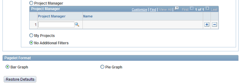

This example illustrates the fields and controls on the Personalize TIP for Expense Reports page (1 of 2). You can find definitions for the fields and controls later on this page.
This example illustrates the fields and controls on the Personalize TIP for Expense Reports page (2 of 2). You can find definitions for the fields and controls later on this page.
This page automatically populates with defaults provided from the system administrator personalization page. The parameters specified on this page filter and define the default data that PeopleSoft Expenses displays on a TIP pagelet.
Field or Control Description
Bar Graph
Select to view search results as a bar graph.
Pie Graph
Select to view search results as a pie graph.
The administrator sets the defaults for displaying TIP pagelets as a Bar Graph or a Pie Graph.
If a user personalizes a time report pagelet and changes the default selection for Bar Graph or Pie Graph, the two time report pagelets will be displayed the same way. That is, both time report pagelets can be displayed either as a bar graph or as a pie graph, not one of each.
Similarly, if a user personalizes an expense report pagelet and changes the default selection for Bar Graph or Pie Graph, the three expense report pagelets will be displayed the same way. That is, the three expense report pagelets can only be displayed either as a bar graph or as a pie graph, not one of each.

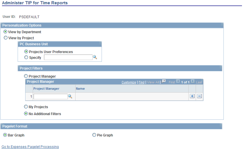

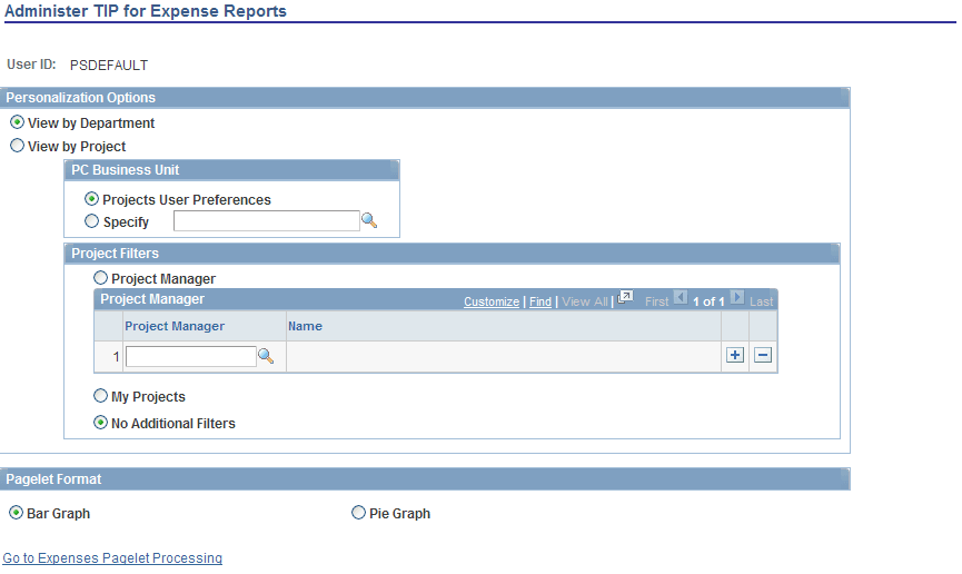

Administer Expense Report and Time Report Pagelets
Use the Administer TIP for Expense Reports or the Administer TIP for Time Reports page to obtain data for PeopleSoft Expenses and Time pagelets .
To obtain data for PeopleSoft Expenses pagelets, an administrator must define filter criteria and then run the Expenses Pagelet Processing process. This process converts expense data to various currencies so that the Total Expense Costs Operational Threshold Alert (OTA) and Transactions in Progress pagelets can provide data in a currency that is meaningful to each user and render data more rapidly. This process is scheduled by navigating to Travel and Expenses, Real-Time Analysis, Update Expenses Pagelet Info.
The administration and processing functionality is the same for Expense Report pagelets and for Time Report pagelets.
This example illustrates the fields and controls on the Administer TIP for Expense Reports page. You can find definitions for the fields and controls later on this page.
This example illustrates the fields and controls on the Administer TIP for Time Reports page. You can find definitions for the fields and controls later on this page.
In the Administer TIP for Time Reports page, users will only see the View by Project and No Additional Filters options.
Go to Expenses Pagelet Processing (Travel and Expenses, Real-Time Analysis, Update Expenses Pagelet Info, Expenses Pagelet Processing)
Click to run the process that populates the tables that enable you to view transactions in progress data and pagelets.
When you run Expenses Transaction in Progress Loader application engine (EX_TIP_LOAD), you can run a batch process to load a large amount of transactions in progress data from PeopleSoft Expenses. This decreases the amount of time it takes to load the transactions in progress from the feeder systems to the TIP staging tables and display them in the Project Costing Transaction in Progress page.
