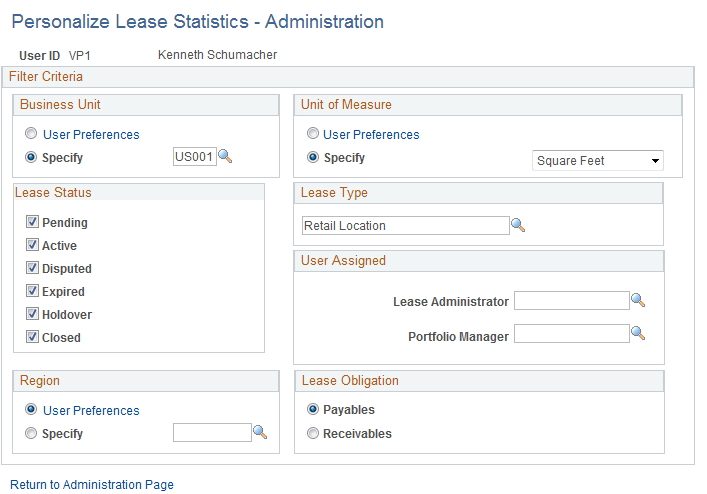

Personalize Lease Statistics - Administration Page
Use the Personalize Lease Statistics - Administration pagelet (RE_LEASEOPT_PRS) to define default information for the Lease Statistics pagelet.
Navigation:
Set Up Financials/Supply Chain, and then Pagelets, and then Asset Lifecycle Management, and then Lease Administration, and then Portal Pack Defaults, and then Lease Statistics, and then Personalize Lease Statistics - Administration
This example illustrates the fields and controls on the Personalize Lease Statistics - Administration page. You can find definitions for the fields and controls later on this page.
Business Unit
Field or Control Description
User Preferences
Select to have the system display the area for only those leases with the business unit that is specified in your user preferences on the Lease Administration - User Preferences page.
Specify
Select to have the system display the area for leases from a business unit other than the business unit that is specified in your user preferences on the Lease Administration - User Preferences page. If you select Specify, you must enter a business unit value.
Unit of Measure
User Preferences
Select to have the system display the area in the unit of measure that is specified in your user preferences on the Asset Management - User Preferences page. Click the link to review or adjust the value.
Specify
Select to have the system display the area in a unit of measure other than the unit of measure that is specified in your user preferences on the Asset Management - User Preferences page. If you select Specify, you must select a unit of measure value.
Lease Status
Select to filter by one or more lease statuses. If you do not select any statuses, then no data appears in the pagelet.
Lease Type
Select to filter by lease types. The values are user-defined and established at implementation.
User Assigned
Lease Administrator and Portfolio Manager
Select to filter by specific lease administrator or portfolio manager.
Region
User Preferences
Select to have the system display the area for the region that is specified in your user preferences on the Lease Administration - User Preferences page. Click the link to review or adjust the value
Specify
Select to have the system display the area from a region other than the region that is specified in your user preferences on the Lease Administration - User Preferences page. If you select Specify, you must enter a region value.
Lease Obligation
Select Payables or Receivables to display the total, rentable, and usable area in the pagelet for the payables leases or the receivables leases.
