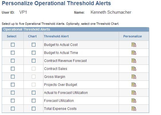

Personalize Operational Threshold Alerts Page
Use the Personalize Operational Threshold Alerts page (PC_PE_OTA_PRS) to select the OTAs to appear on the Operational Threshold Alert or Operational Threshold Chart pagelets.
Access the page to personalize individual OTA tolerance levels.

This example illustrates the fields and controls on the Personalize Operational Threshold Alerts page. You can find definitions for the fields and controls later on this page.
Field or Control Description
Select
Select up to five OTAs that you want to appear on the Operational Threshold Alert pagelet.
Chart
Select one OTA to appear on the Operational Threshold Chart pagelet.
Personalize
Click the Personalize icon to access the corresponding OTA's personalization page, where you can specify the tolerance level parameters for the OTA.
