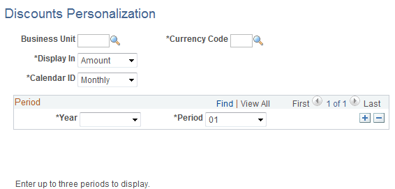

Discounts Personalization Page
Use the Discounts Personalization page (AP_CFOP_DSCNT_PERS) to define default display information for the Payables Discounts pagelet.
Navigation:
Click the Customize icon on the Payables Discounts pagelet.
This example illustrates the fields and controls on the Discounts Personalization page. You can find definitions for the fields and controls later on this page.
Field or Control Description
Business Unit
Enter a business unit or leave the field blank to view discounts lost and taken for all business units. Leave the field blank to view all business units on the Discounts by Business Unit page.
Display In
Select Amount or Percentage.
Calendar ID
Select Annually, Monthly, or Quarterly. This will affect the type of period that appears in the Period field.
Year and Period
Define up to three accounting periods to display on the Payables Discounts pagelet.

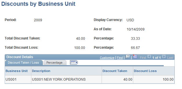

Discounts by Business Unit Page
Use the Discounts by Business Unit page (AP_CFOP_DSCNT_DTLS) to view details on discounts and vouchers.

Click a bar on the graph displayed on the Payables Discounts pagelet.
This example illustrates the fields and controls on the Discounts by Business Unit page.
The Business Unit field on the Discounts Personalization page must be blank in order to access this page.
On the Discount Taken / Loss tab, view the total discounts taken and lost for each business unit. Click the Percentage tab to view the percentage of vouchers taken and lost.
