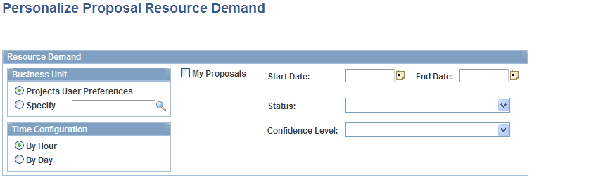

This example illustrates the fields and controls on the Personalize Proposal Resource Demand page. You can find definitions for the fields and controls later on this page.
Business Unit
Field or Control Description
User Preferences
Select to display resource demand information based on the business unit that you set up in the user preferences profile.
Specify
Select to use a specific business unit to display resource demand information.
Time Configuration
By Hour
Select to display resource demand information in hours.
By Day
Select to display resource demand information in days.
Resource Demand
My Proposals
Select to display resource demand information from proposals that you have designated as your own by clicking the My Proposals button on the Maintain Proposal page or by adding proposals to the My Proposal Page in PeopleSoft Proposal Management.
Start Date and End Date
Select the beginning and ending dates that you want the system to use to graph resource demand information. If the target due date on the proposal falls within the date range, then its resource demand information is included in the graph. If you do not enter any dates, the system uses the current date and then adds three months.
Status
Select a status if you want to view resource demand information from proposals with a specific status only. If you do not specify a proposal status, the system displays resource demand information from proposals with all proposal statuses.
Confidence Level
Select a confidence level if you want to view resource demand information from proposals with a specific confidence level only. If you do not specify a confidence level, the system displays resource demand information from proposals with all confidence levels.
