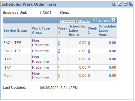

Scheduled Work Order Tasks Pagelet
Use the Scheduled Work Order Tasks pagelet (EPWM_PE_SCHEDULED_ GBL) to view work orders grouped by general work type and service group that are scheduled.
This pagelet is similar to the Unassigned Work Orders Tasks pagelet displaying the task view and lists work order tasks that are scheduled. The pagelet lists tasks grouped by general work type and service group.

This example illustrates the fields and controls on the Scheduled Work Order Tasks page. You can find definitions for the fields and controls later on this page.
Field or Control Description
Work Type Group
Displays the scheduled work as either preventive or corrective (non-preventive).
Week 1 and Week 2
Displays the number of tasks that are scheduled to start that week. By clicking the Count link, the system displays the Work Order Workbench page.
Scheduled Labor Hours
Displays the total hours of the tasks scheduled for that week.
See the Personalizing Backlog by Work Order Type section of this topic for information on personalizing this pagelet.
Work order scheduling and shop configuration settings for scheduling labor are required so labor assignments can be made. Labor assignments are required to provide estimated labor hours.
The work order Scheduled Start Date field is required and is within fourteen days of the run time of the pagelet.
