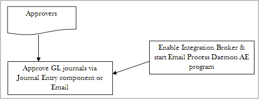

The following diagram shows the approval request routed to approvers by worklist or email using approval framework. This approval process uses the Journal Entry Component:.
Approval Flow Using Journal Entry Component or Email
Approval flow using the Journal Entry component or email

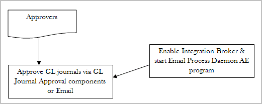

The following diagram shows the approval request routed to approvers by worklist or email using the GL Journal Approval component (or Manage GL Journal Approval component for mass journal approval):
Approval Flow Using GL Journal Approval Components or Email
Approval flow using the GL Journal Approval components or email
