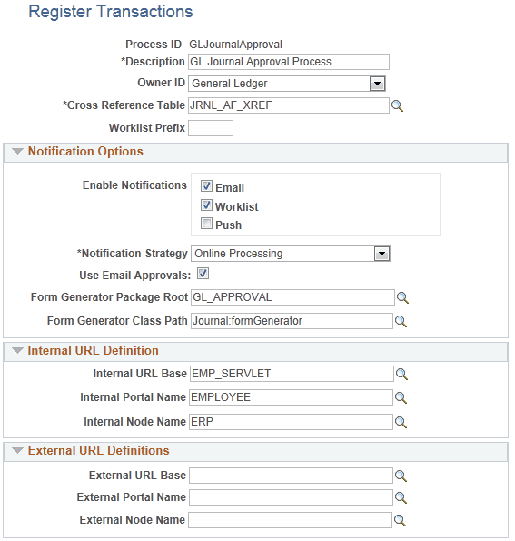

Register Transactions Page
Use the Register Transactions page (EOAW_TXN) to manage the integration between General Ledger and the Approval Framework (AF) by process ID, which is delivered with system data.
Navigation:
Enterprise Components, and then Approvals, and then Approvals, and then Transaction Registry, and then Register Transactions
This example illustrates the fields and controls on the Register Transactions page (1 of 2).
Register Transactions page: GL_JournalApproval (1 of 2)

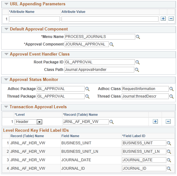

This example illustrates the fields and controls on the Register Transactions page (2 of 2).
Register Transactions page: GL_JournalApproval (2 of 2)
The Register Transactions page provides the integration between General Ledger and AF, and is delivered with system data. Most of the fields on this page should not be changed.
However, if you plan to use the GL Journal Approval components rather than the Journal Entry component for approvals, you should replace the following values (on this page and in any other setup pages throughout the topic:
Field or Control Description
Approval Component
If using GL Journal Approval component rather than the Journal Entry component, change this value to JOURNAL_APPROVAL. This enables the approval process for the Journal Approval component instead of the Journal Entry component.
Thread Package
If using GL Journal Approval component rather than the Journal Entry component, change this value to GL_APPROVAL to control the title display on the Approval Status Monitor.
Thread Class
If using GL Journal Approval component rather than the Journal Entry component, change this value to Journal.threadDescr to control the title display on the Approval Status Monitor.

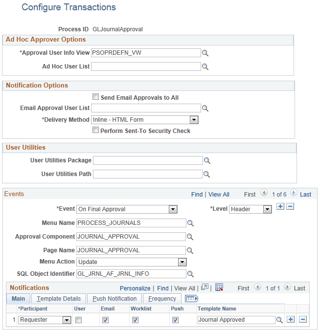

This example illustrates the fields and controls on the Configure Transactions page - (Event: On Final Approval).
Configure Transactions page (1 of 3)

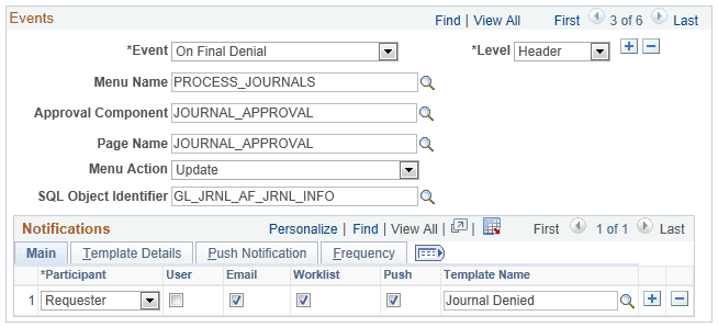

This example illustrates the fields and controls on the Configure Transactions page - (Event: On Final Denial).
Configure Transactions page (2 of 3)

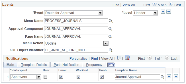

This example illustrates the fields and controls on the Configure Transactions page - (Event: Route for Approval).
Configure Transactions page (3 of 3)
This definition provides the details of GL integration with AF, and is delivered as system data. However, you can modify certain values on this definition to better meet your approval requirements. For example, you can replace the Approval User Info View, Email Approval User List, and delivery method. You can also add more participants to receive the notification, change the notification channel and priority, replace the template, and add more events to trigger the notification generation.
Approver User Info View
Enter the name of the view that provides the details that the user sees when using the approval monitor.
Note: Data in this view dictates what is displayed in the approver links.
Specify which users are to be allowed to do their approval by using email.
Note: If the user receiving the notification also falls into the email approval user list, then he or she receives an email approval rather than a standard email notification.
Note: This field must be populated; otherwise, no one will receive the approval emails.
Delivery Method
Define whether users are to receive their email approvals as text within the email or as attachments.
Use the Notifications section to define whom to notify and how to notify them in addition to the defaults determined in the Events section of this page.
Participant
Define the user who is notified when this event takes place:
Admin
Approver
A-Delegate: Delegate approver to which the approval was originally assigned.
R-Delegate: Requestor who created the request for someone else.
Dynamic
A-Proxy: Approver who performed the actual approval.
R-Proxy: The person who requested the transaction be created.
Requester
Reviewers
User List
Channel
Defines how the participant will be notified.
Both
Email
None
User
Worklist
Priority
Select High, Medium, or Low.
SQL Object Identifier
To support the delivered demo notification templates, the SQL Object GL_JRNL_AF_JRNL_INFO is defined as:
SELECT A.BUSINESS_UNIT
, A.JOURNAL_ID
, %DateOut(A.JOURNAL_DATE)
, A.BUSINESS_UNIT_LN
FROM PS_JRNL_AF_XREF A
WHERE A.BUSINESS_UNIT=:1
  AND A.JOURNAL_ID=:2
  AND A.JOURNAL_DATE=%DateIn(:3)
  AND A.BUSINESS_UNIT_LN=:4
You must keep the delivered journal-related template variables, unless you create your own SQL objects that are referenced on the configuration definition.
In the first instance, the SQL Object Identifier is generic to the specified event. Whereas, the first SQL Object Identifier in the Notifications grid indicates SQL Object Identifier for the template name, which is specified for the participant. This SQL Object Identifier is generally used to transfer the metadata to the template in use. If the template does not have the SQL Object Identifier defined, the SQL Object Identifier specified for the event is defaulted.
The last instance of the SQL Object Identifier in the Notifications grid is used for the Push notifications.
