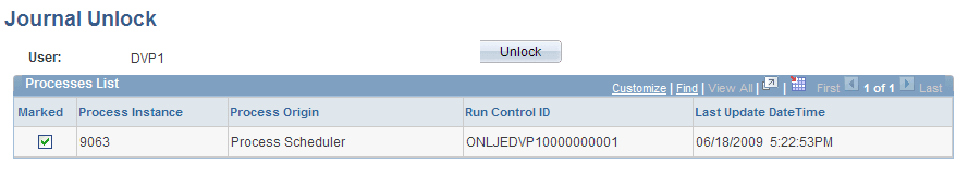

Journal Unlock Page
JRNL_EDIT_LOG
Unlock journals in a process instance that terminated abnormally.

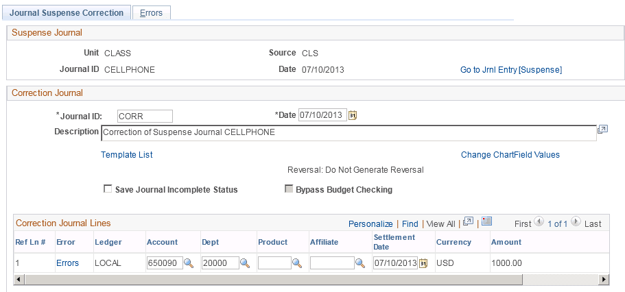

Journal Suspense Correction Page
Use the Journal Suspense Correction page (JRNL_SUSP_CORR) to create a suspense correction journal to correct and reverse the suspense lines on a posted suspense journal.
Select a suspense journal from the list of all suspense journals that have a journal status of Posted to Ledger(s). The process does not allow you to select an unposted suspense journal.
Navigation:
General Ledger, and then Journals, and then Suspense Correction, and then Correct Suspense Entries, and then Journal Suspense Correction
This example illustrates the fields and controls on the Journal Suspense Correction page. You can find definitions for the fields and controls later on this page.
Select the suspense journal that you want to correct. Click the Go to Jrnl Entry [Suspense] link, which opens a new window where you can review the original Journal Entry - Lines page of the posted journal entry.
To correct the suspense journal, complete the following fields in the Correction Journal group box:
If you correct a journal using another method, such as creating a new journal entry, the corrected journal appears on this page. To correct this, use the Update Suspense Reconciliation Status Page to change the status to Corrected Using Journal Entry. Journals that have the status of Corrected Using Journal Entry do not appear on this page.
Field or Control Description
Journal ID
Defaults to NEXT and generates the next available journal number when you save the journal. If you do not want to use the default, enter a unique journal ID for the correction journal.
Date
Defaults to the date of the suspense journal. Only authorized users can change the correction journal date as well as the reversal information if the suspense journal has a reversal code other than Do Not Generate Reversal.
Description
Defaults to Correction of Suspense Journal followed by the journal ID of the suspense journal you are correcting. You can change this description if desired.
Template List
Click to open the Journal Line Template page that enables you to select a template that specifies which columns you want to display in the Correction Journal Lines grid. Alternatively, you can change the columns that appear within your suspense correction journal lines by clicking the Customize link and hiding the columns that you do not want to display in your entry.
Correct ChartField Errors
Click to open the Journal ChartField Errors page where you change the ChartField values in error.
Change ChartFields Values
Click to open the Change ChartField Values page where you can change a ChartField value globally on multiple edit correction lines.
Reversal
Click the link to open the Journal Suspense Correction Reversal page where you can change the reversal information for correction journals.
The Correction Journal Lines grid displays the journal lines for the suspense journal that need to be corrected. The system generates edit and amount correction lines with the ChartFields and amounts from the journal lines marked in error. Use these correction lines to correct ChartField and amount errors.
Correction journal lines for secondary ledgers are not displayed in the grid if the suspense journal is created with the KLS (Keep Ledgers in Sync) option selected.
When you first open the Journal Suspense Correction page, one or more amount correction lines are at the top of the scroll area, followed by one or more balance correction lines and edit correction lines. No references exist in the suspense journal for the balance correction lines.
Ref Ln # (reference line number) displays the line number that contains an amount error or an edit error in the suspense journal. The reference line number is always blank for the balance correction lines.
Click the Errors link for any line to open the Journal Suspense Correction - Errors page that shows the error log for the line.
When you save your work, the system creates a correction journal that contains the new correction lines. The system also generates the reversing suspense lines for the suspense journal. You won't see these lines in the grid.
Important:
When you create a correction journal, you must determine whether the lines are correct or incorrect. If necessary, you can make further changes to the corrected journal before you run the Journal Edit process (Application Engine process GL_JEDIT) and the Journal Post process (GL_JP). But, you must make these changes from the Journal Entry - Lines page because the system changes the suspense status of the suspense journal to 2 when you save your correction journal. The Journal Suspense Correction page does not let you reenter the page for a suspense journal if its correction journal already exists.
If you have not run the Journal Post process (GL_JP) for the correction journal, and you decide that you want to start over, select the Delete Journal option in the Process field on the Journal Entry - Lines page to delete this correction journal. The system updates the suspense status of the suspense journal back to 1, and you can return to the Journal Suspense Correction page to create a new correction journal for the same suspense journal.
A correction journal is a non-interunit journal when created. Like journals created by the Journal Entry - Lines page, the system still populates correction journal's IU System Transaction Code (IU_SYS_TRAN_CD) and IU Transaction Code (IU_TRAN_CD) but based on the suspense journal's values.  If the suspense journal does not have these two values, interunit lines are not generated for the correction journal even if it is modified using the Journal Entry - Lines page to an interunit journal.

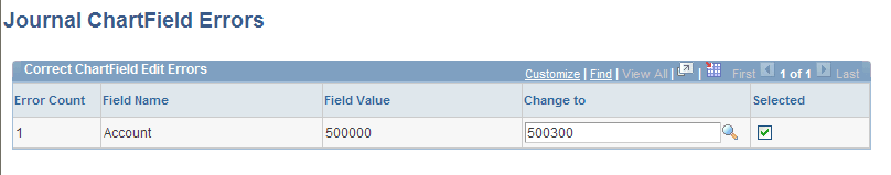

Journal ChartField Errors Page
Use the Journal ChartField Errors page (JRNL_SUSP_CFE_SEC) to correct individual ChartField values that are in error.
Navigation:
General Ledger, and then Journals, and then Suspense Correction, and then Correct Suspense Entries and click the Correct ChartField Errors link.
(The link appears only if the suspense journal has edit suspense lines.)
This example illustrates the fields and controls on the Journal ChartField Errors page. You can find definitions for the fields and controls later on this page.
This link appears on the Journal Suspense Correction page only if the suspense journal has edit suspense lines.
Error Count
Indicates the number of lines that contain the ChartField value in error.
Field Name
Indicates the ChartField whose value is in error.
Field Value
Displays the incorrect ChartField value.
Change to
Enter the correct ChartField value.
Selected
Click to select the ChartField values that you want to update on the Journal Suspense Correction page.

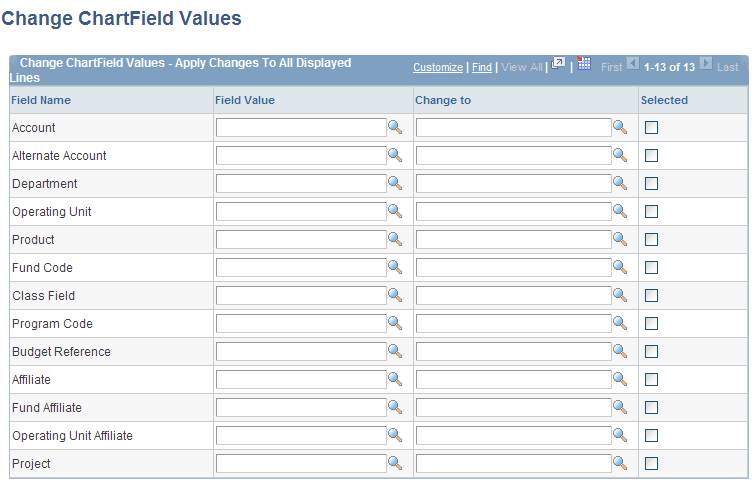

Change ChartField Values Page
Use the Change ChartField Values page (JRNL_SUSP_CF_SEC) to change a ChartField value for multiple edit correction lines globally on the Journal Suspense Correction page.
Navigation:
Select General Ledger, and then Journals, and then Suspense Correction, and then Correct Suspense Entries and click the Change ChartField Values link.
This example illustrates the fields and controls on the Change ChartField Values page. You can find definitions for the fields and controls later on this page.
Field Name
Displays the name of each ChartField.
Field Value
Enter the ChartField value that you want to change.
Change to
Enter the new ChartField value.
Selected
Select to replace all occurrences of the ChartField value on the Journal Suspense Correction page.

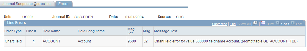

Journal Suspense Correction - Errors Page
Use the Journal Suspense Correction - Errors page (JRNL_SUSP_ERRS) to review the error message for a journal line.
Click the Errors link for any line on the Journal Suspense Correction page.
Navigation:
Select General Ledger, and then Journals, and then Suspense Correction, and then Correct Suspense Entries, and then Errors
This example illustrates the fields and controls on the Journal Suspense Correction - Errors page. You can find definitions for the fields and controls later on this page.
This page displays information about the ChartFields and Amount errors on the suspense journal.
Error Type
Indicates the type of error, which can be ChartField error, Combo Edit error, Amount error, or Unknown.
Line # (line number)
Indicates the number of the reference line number on the Journal Suspense Correction page with the error. It shows the field name for the ChartField in error. It also displays the message set number that contains the error message, the message number, and the message text. Click the line number to return to the Journal Suspense Correction page and place your cursor where you need to make the correction.

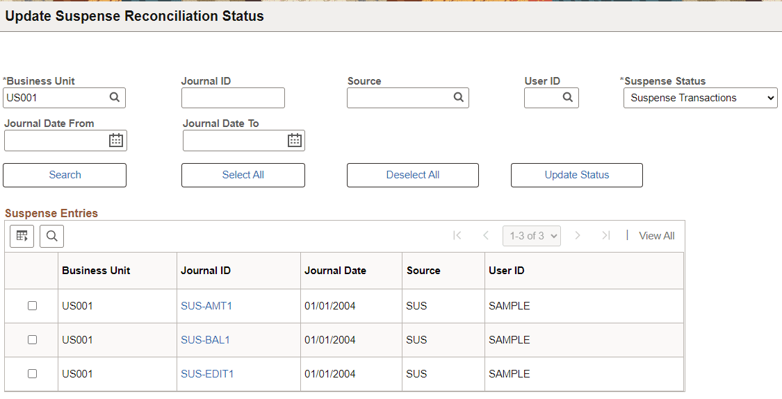

Use the Update Suspense Reconciliation Status page (JRNL_SUS_UPD) to update the suspense reconciliation status of a journal header for journals that are corrected outside of the Journal Suspense Correction Page and to change the status back to Suspense Transactions.
Navigation
General Ledger, and then Journals, and then Suspense Correction, and then Update Suspense Recon Status
To access this page, used these permission lists: ALLPAGES and EPGL9000.
This example illustrates the fields and controls on the Update Suspense Reconciliation Status page. You can find definitions for the fields and controls later on this page.
Use the ALLPAGES or EPGL9000 Permission List to access this page.
Suspense Status
Select on of these values:
  • Suspense Transactions: Displays journals that have suspense entries.
  • Corrected Using Journal Entry: Displays journals where the suspense reconciliation status is updated to Corrected Using Journal Entry.
Update Status
After selecting the journals in the grid use this button the update the suspense recon status to Suspense Transactions or Corrected Using journal Entry. The system determines the correct values based on the value selected in the search criteria.
Note: The operator ID and date time stamp are also updated with the suspense reconciliation status in the journal header table.

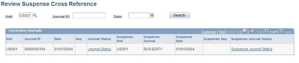

Review Suspense Cross Reference Page
Use the Review Suspense Cross Reference page (JRNL_SUS_CROSS_REF) to view the connection between the suspense journal and its corresponding corrections journal.
You can review the status of both journals by clicking the Journal Status and Suspense Journal Status links. General Ledger uses the Journal Header Sibling table (JRNL_HDR_SIBL) to link the suspense journal and its corresponding corrections journal.
Navigation:
General Ledger, and then Journals, and then Suspense Correction, and then Review Suspense Cross Ref, and then Review Suspense Cross Reference
This example illustrates the fields and controls on the Review Suspense Cross Reference page. You can find definitions for the fields and controls later on this page.
Specify a combination of unit, journal ID, and date for the correction journal search criteria or just search on a unit.
Search
Click to view the correction journals that meet your search criteria and its corresponding Suspense Journal. Click Journal Status/Suspense Journal Status link to transfer to the Review Journal Status - Journal Lines page. It opens a new window, and from there you can view suspense/correction journal line information.
Journal Status
Click the link to transfer to the Review Journal Status page for the correction journal ID.
Click the link to transfer to the Review Journal Status page for the suspense journal ID.

Journal Unlock Page
Use the Journal Unlock page (JRNL_EDIT_LOG) to unlock journals in a process instance that terminated abnormally.
Navigation:
General Ledger, and then Monitor Background Processes, and then Journal Unlock
This example illustrates the fields and controls on the Journal Unlock page. You can find definitions for the fields and controls later on this page.
Journal Unlock page
General Ledger uses application locking when you run batch processes. When a general ledger process is processing a journal, it locks the journal so that no other process can access it. A process automatically turns the journal lock flag on and off to lock and unlock the journal during the process. If a process terminates abnormally, the journal may remain locked. You can unlock journals from a failed process by using the Journal Unlock page.
The page displays the ID of the user who ran the process that terminated abnormally.
The Processes List grid displays a list of processes that the user has run.
For each run of a process, it displays the process instance number and the run control ID. The Process Origin column indicates how the process was initiated, and it has the following possible values:
Other GL Application
Another General Ledger process, such as Allocations (FS_ALLC), called the process to start it.
Other
The process was initiated from an operating system command line.
Process Scheduler
A process scheduler definition initiated the process.
Remote Call
The process was initiated by an individual taking an action on a page.
The Last Update DateTime column indicates the last date and time that the process made an update to the message log.
Select Marked for each process instance whose journals you want to unlock, and click the Unlock button.
