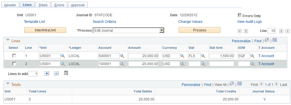

This example illustrates the fields and controls on the Journal Entry - Lines page (statistics code entry). You can find definitions for the fields and controls later on this page.
Enter the data for this journal line, including monetary data, and use the following information to select a statistics code and its relevant data.
Field or Control Description
Stat (statistic)
Select a code.
Stat Amt (statistical amount)
Enter the total number of units that are involved in the transaction.
