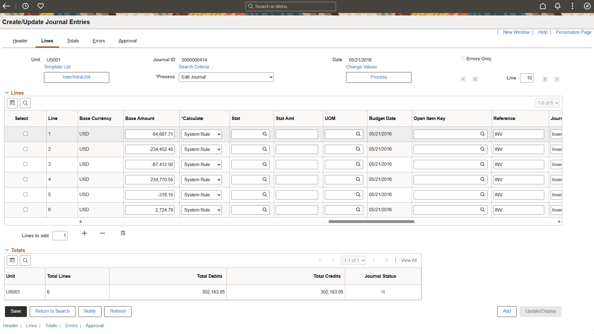

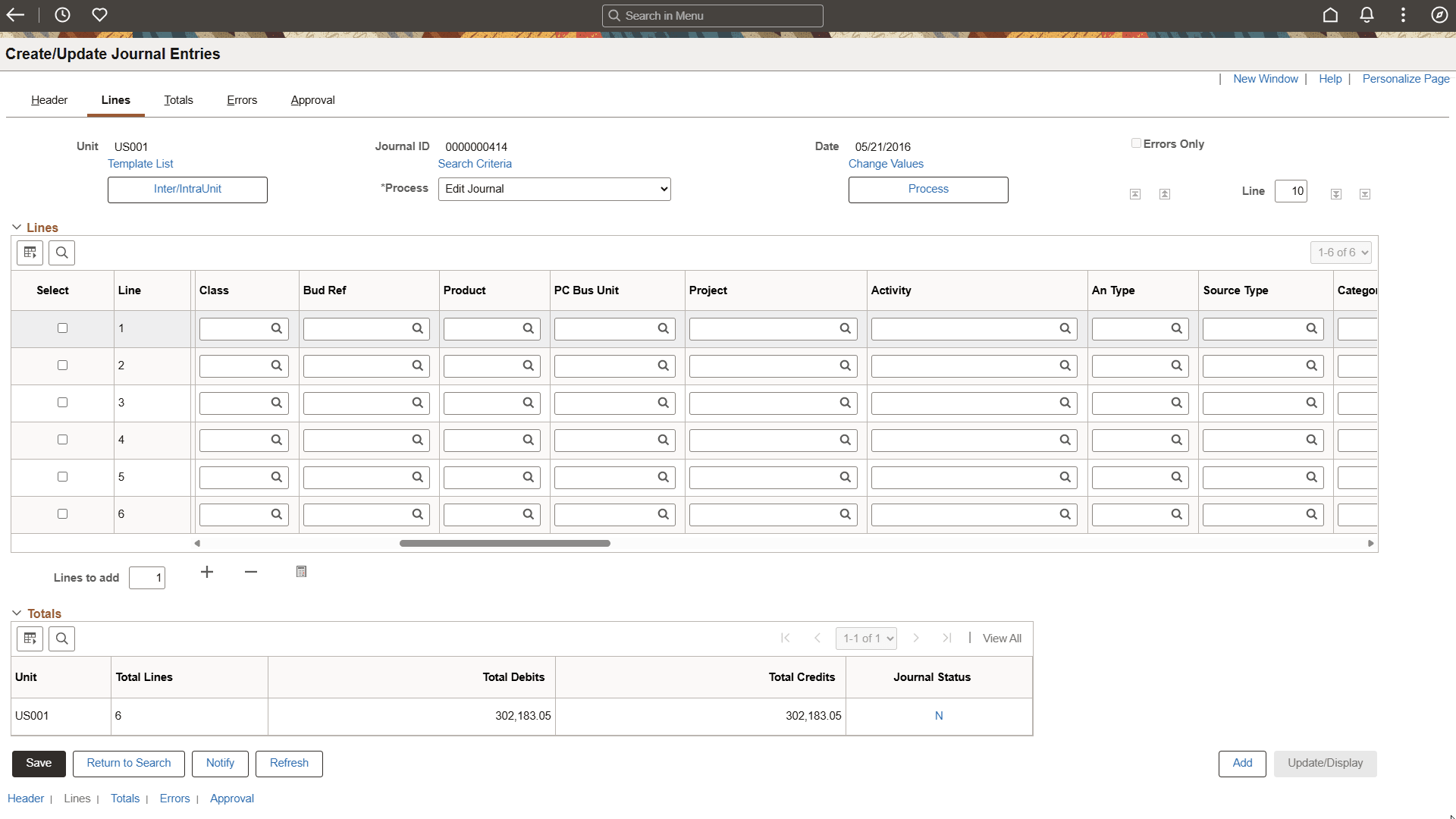

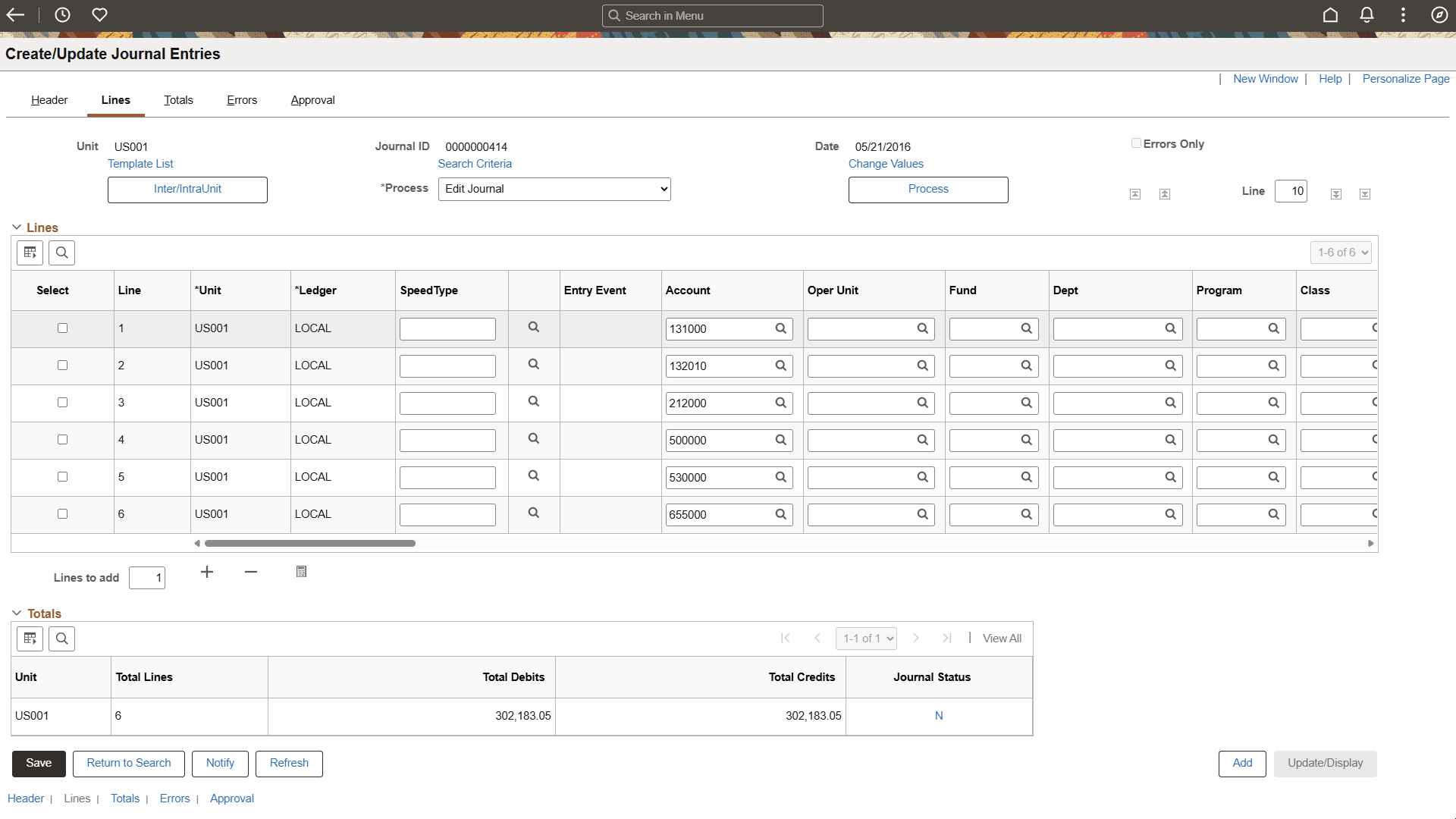

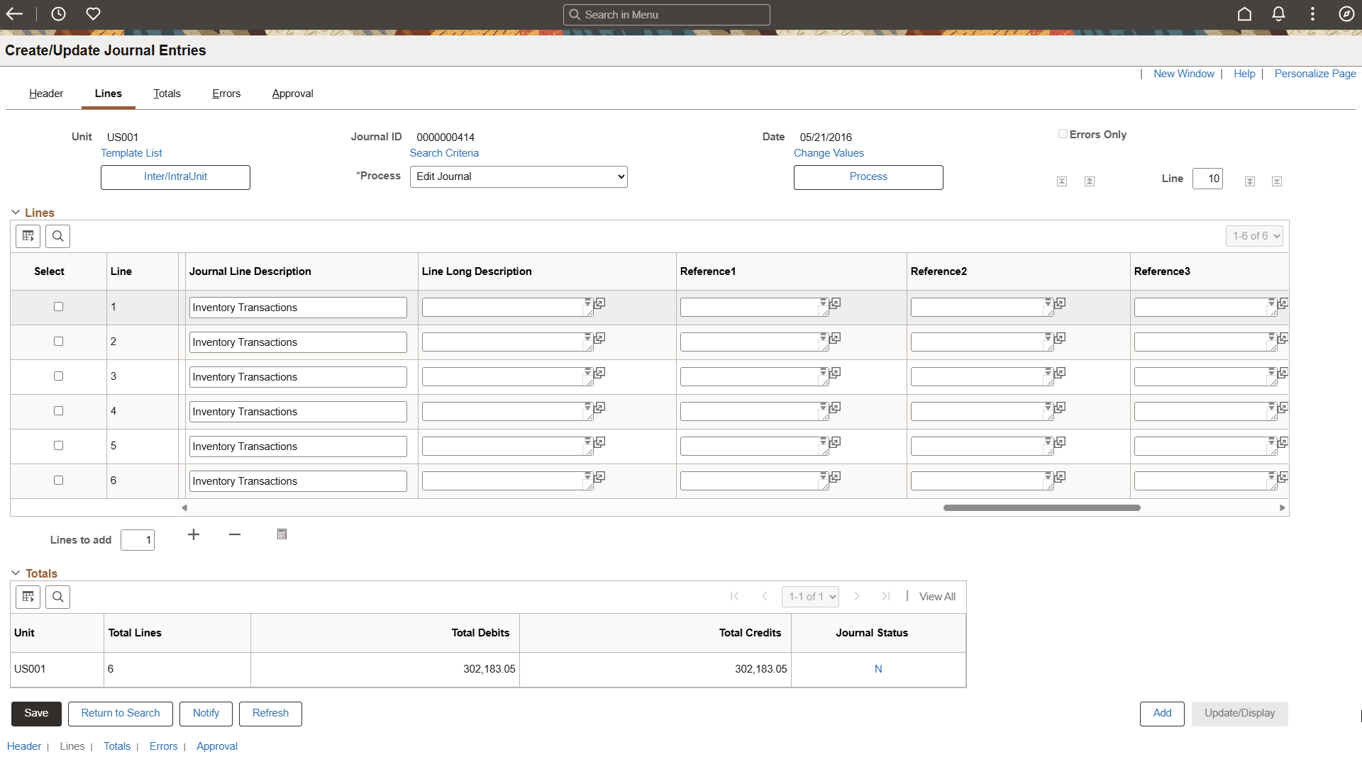

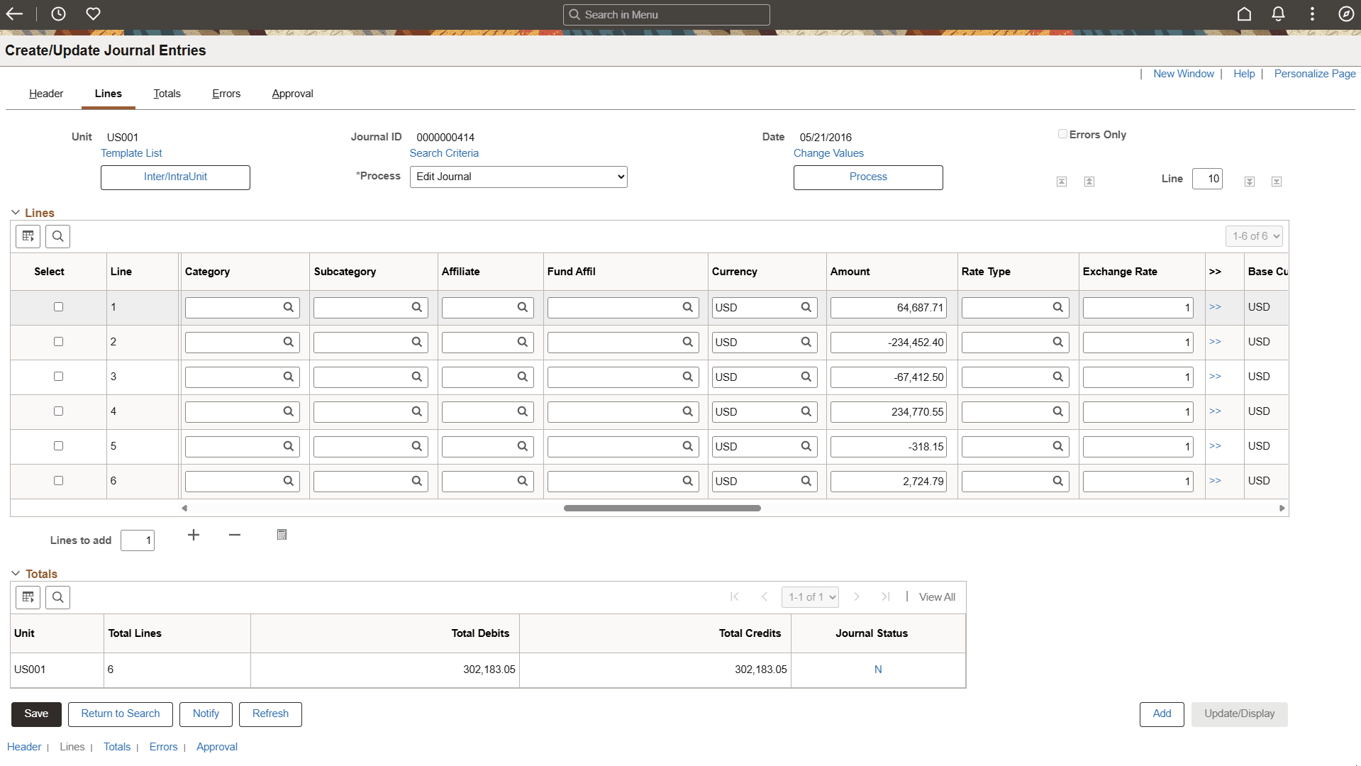

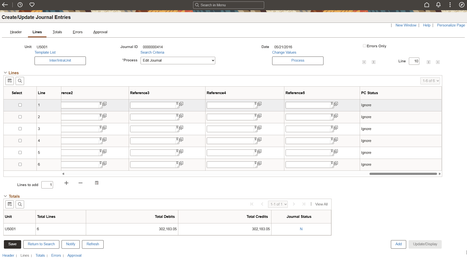

Create/Update Journal Entries - Lines Page
JOURNAL_ENTRY2_IE
Record the transactions making up the journal—the debit and credit entries. Once you enter the header and lines, you can request further processing on the page.

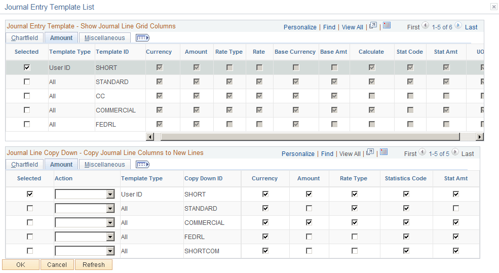

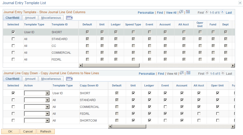

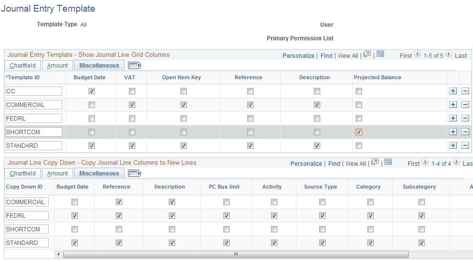

Journal Entry Template List Page
JOURNAL_ ENTRY_TMP
Select the template that defines which columns appear in the lines scroll area. Also specify the field values to be copied down to new lines when you click the Insert Journal Lines button.

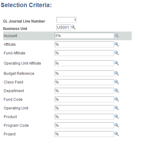

Selection Criteria Page
JRNL_SRCH_SEC
Specify search values for any or all fields listed.

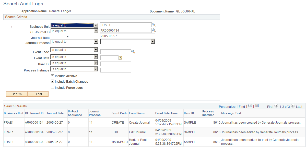

Search Audit Logs Page
FS_AUDITLOG_SEARCH
View the audit trail for the journal entry.

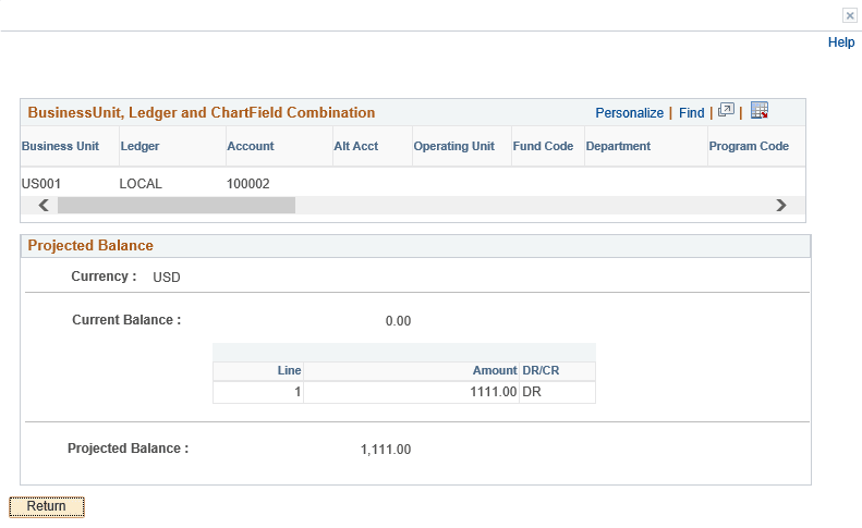

Projected Balance Page
TACCOUNT_VIEW_SEC
Check the effect of a particular line on the relevant balance (same ChartField combination) directly from the Journal Entry - Lines page. Enable the Projected Balance field to appear on the Lines page by selecting a Journal Entry Template that includes that field. The Projected Balance field is located on the Miscellaneous tab of the Journal Entry Template page for selection.

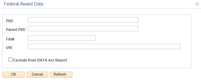

Federal Award Data Page
JRNL_LNFED_SEC
View values for Procurement Award and Financial Assistance elements in the PeopleSoft purchase order staging tables

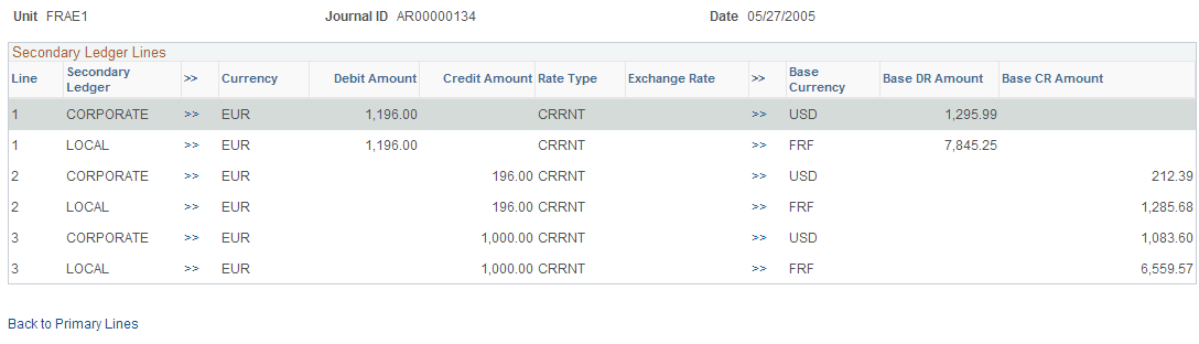

Secondary Ledger Lines Page
JOURNAL_ENTRY_SEC
View secondary ledger lines.

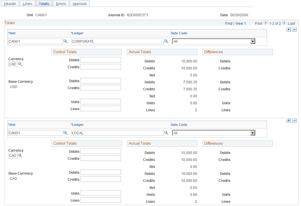

Journal Entry - Totals Page
JOURNAL_ENTRY_T_IC
Specify control debit and credit amounts, unit value of statistical entries, and the number of lines. These controls enable you to enforce a greater degree of control over the journal entry process.

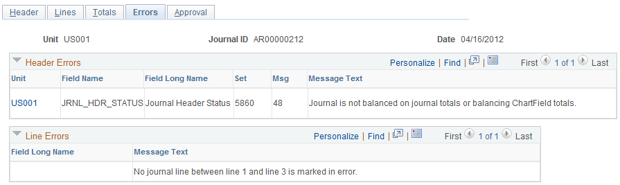

Journal Entry - Errors Page
JOURNAL_ENTRY_E_IC
Determine which errors the system encountered.

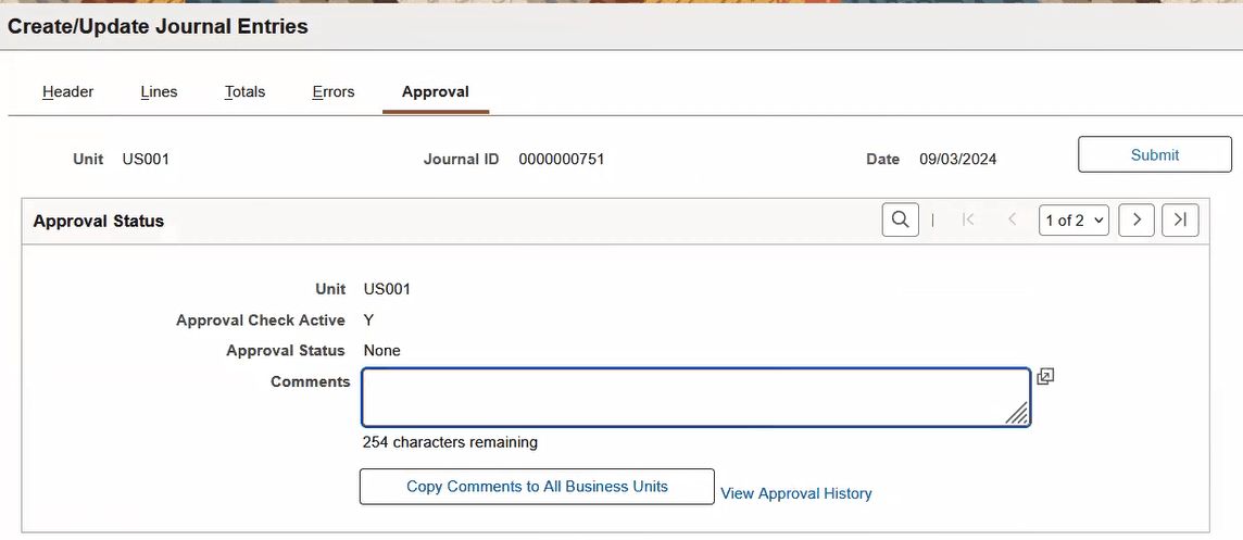

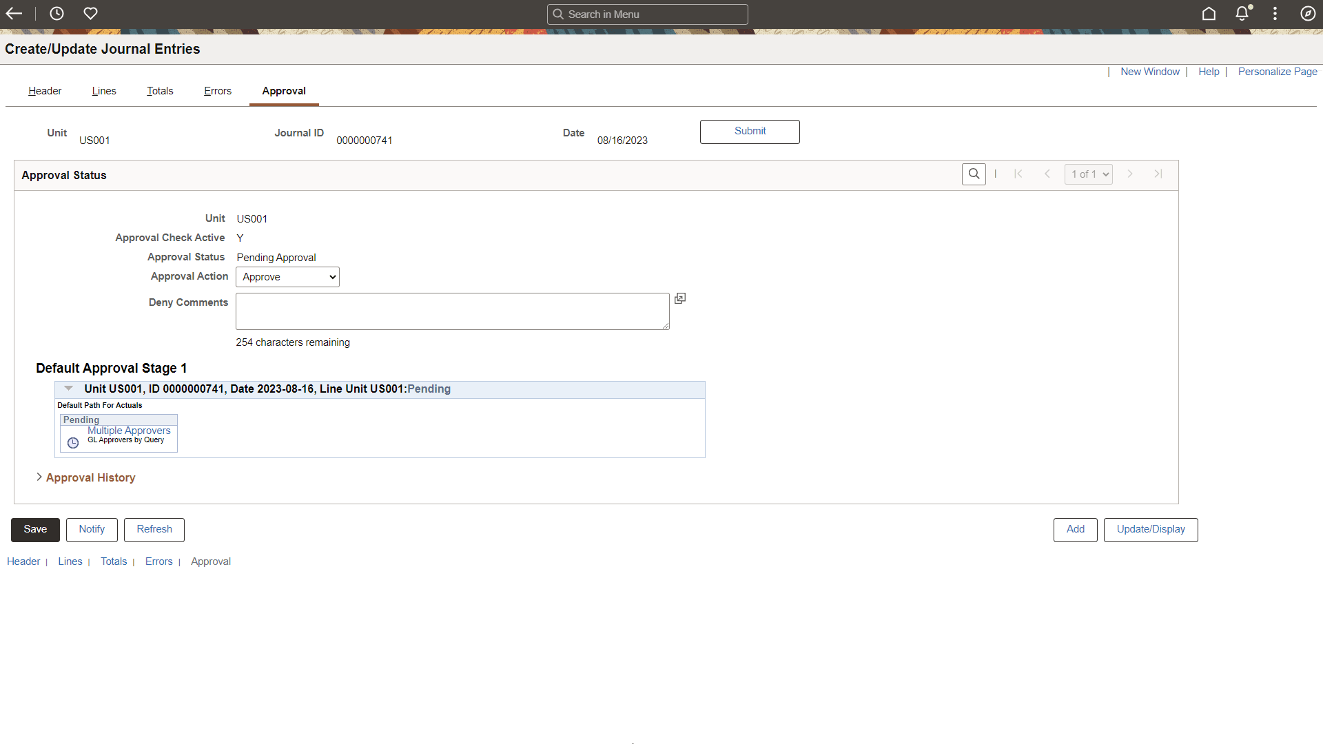

Create/Update Journal Entries - Approval Page
JOURNAL_ENTRY_A_IC
Select the current journal for approval if you use PeopleSoft Workflow to approve journals for posting.

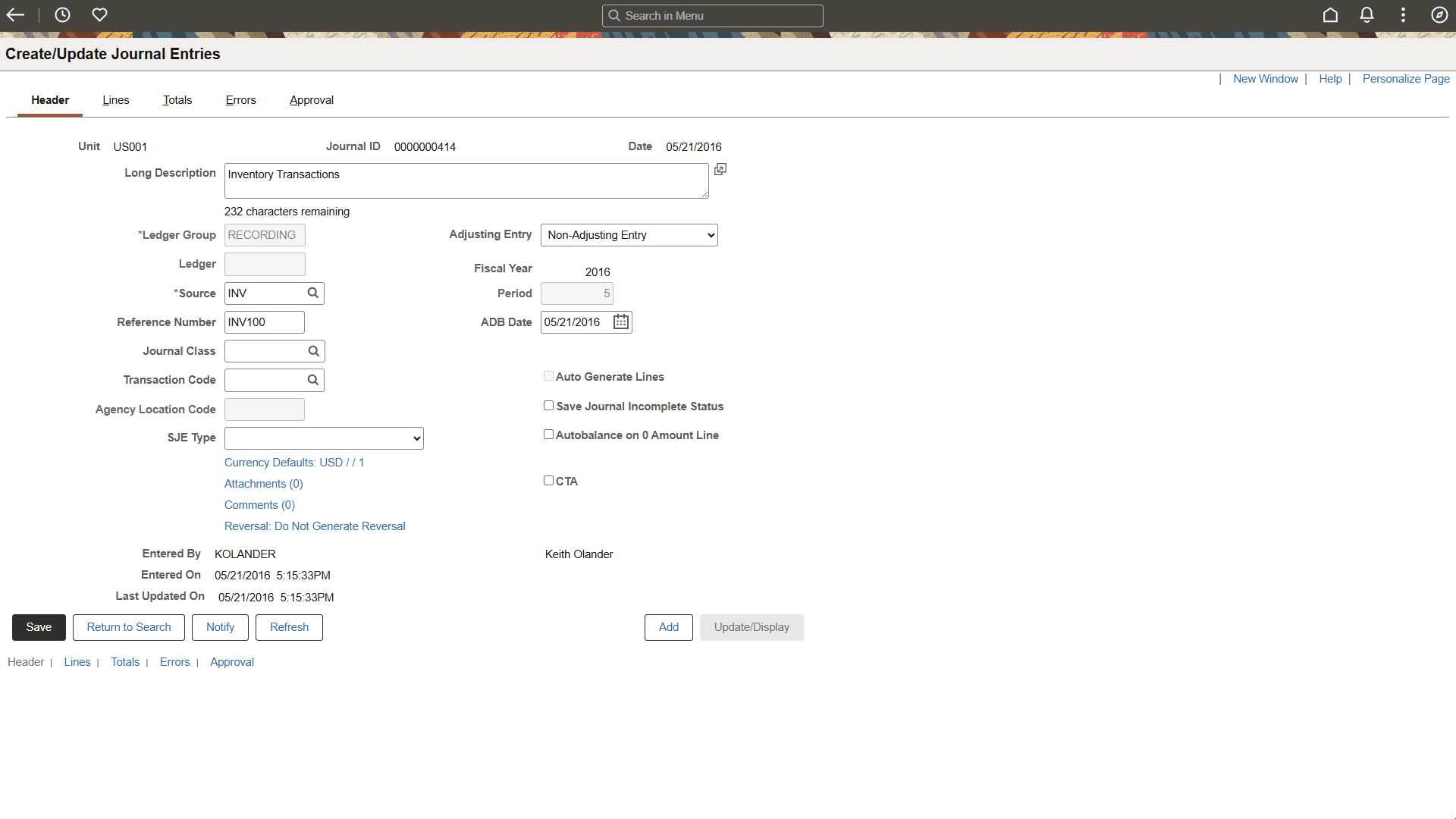

Create/Update Journal Entries - Header Page
Use the Create/Update Journal Entries - Header page (JOURNAL_ENTRY1) to enter journal header information that uniquely identifies the journal by business unit, journal ID, and journal date. Journal cannot be edited if the user does not have journal source access.
It also contains options for setting, adjusting, and reversing entries and foreign currencies.
Navigation:
General Ledger, and then Journals, and then Journal Entry, and then Create/Update Journal Entries, and then Header
This example illustrates the fields and controls on the Create/Update Journal Entries - Header page.
This page or related pages operate in deferred processing mode. Most fields are not updated or validated until you save the page or refresh it by clicking a button, link, or selecting a tab. This delayed processing has various implications for the field values on the page—for example, if a field contains a default value, any value that you enter before the system updates the page overrides the default. The system updates quantity balances or totals only when you save or click the Calculate Amount button.
Field or Control Description
Journal ID
If the Use Next Journal ID option is selected for your user preference, the Journal field is unavailable and automatically changes to NEXT.
When you save the journal, the system automatically assigns the next journal ID to the journal.
Date
Determines the period to which the system posts the journals, unless it is an adjusting entry. For business units using a holiday list ID, the journal entry page requires that journal date be a working day, regardless of the accounting period. If you initially enter a date on a non-working day, you'll receive an error message suggesting the next working day. You must manually enter this or another working date before entering journal entry pages.
Long Description
Enter text that describes the purpose of the journal or explain any anomalies in the transaction. The first 30 characters of your description appear in prompt lists for this journal.
Ledger Group
Select the ledger group to which this journal posts.
Auto Generate Lines
Select this check box if the ledger group contains multiple ledgers.
If the Keep Ledgers in Sync (KLS) option for MultiBook ledgers is selected on the Ledger Group - Definition page, the Auto Generate Lines check box should always be selected, which enables the system to generate journal lines automatically to support transaction detail for each ledger in the group. For example, suppose that you enter a two-line journal entry for a ledger group that contains three ledgers, the journal entry or edit process generates two lines for each ledger.
Ledger
Enter a ledger within the ledger group to indicate that all the journal lines must be posted to that ledger, or leave this field blank to indicate that the journal lines can be distributed to secondary ledgers. Use this field only if the ledger group contains multiple ledgers, KLS is off, and the Auto Generate Lines option is not selected. If the ledger group is a commitment control ledger group, you must select a ledger.
Once you start entering journal lines, you cannot change the values in the Ledger Group, Auto Generate Lines, or Ledger fields. Otherwise, your journal lines would be out of sync with your journal header.
Adjusting Entry
Select Adjusting Entry if this is an adjusting entry. When you select to create an adjusting entry, the Period field becomes available and you can select the adjustment period to which you want the entry to post. The periods (and fiscal year) from which to select are prompted from the adjustment periods and adjustment years as defined in the Open Period Update page that is associated with the ledger group for the anchor business unit of the journal.
If this is a Non-Adjusting Entry, you cannot change the accounting period value. The journal date determines the accounting period to which the entry posts based upon the calendar that is defined within the Ledgers For A Unit page for the primary business unit of the journal.
Note: Year-end adjustments are segregated from the regular accounting periods to prevent the distortion of period-to-period results. They are recorded in special adjustment periods (as defined on the detail calendar). They are posted to the target ledger in the adjustment year and period that are designated as the default on the Open Period Update page. (You can override the default adjustment period on the Journal Header page.) You can post prior year adjustments while processing the current year activity, as long as you have associated that prior year with the adjustment period on the Open Period Update page. If the adjustment period and associated fiscal year are not designated as open on the Open Period Update page, a warning message notifies you that the journal cannot post to the closed period.
Note: When journals are loaded from an external source, there may be a discrepancy between the fiscal year on the Journal Header page and the fiscal year that is open for the corresponding adjustment period on the Open Period Update page. By default, the Journal Edit process selects the fiscal year from the Open Period Update page that is associated with the open adjustment period, changes the fiscal year on the header and processes the journal as valid. You can specify the journal edit handling on the General Ledger Definition – Journal Options page for the Adjustment Year Not Exist field value to control this behavior. The Override field value is the default option, which allows the Journal Edit process to change the fiscal year on the header to the fiscal year that is associated with the open adjustment period (Open Period Update page), thereby passing validation. The Recycle option assumes that the original fiscal year on the adjustment journal header is correct, but since it is not the year that is associated with the open adjustment period, the journal will be in error.
See Defining Journal Processing Options for a Business Unit.
See Application Fundamentals: Open Period Mass Update Page.
Source
Determines various options for entering and editing journals. Select a journal source that best represents how the journal should be processed. Once you start entering journal lines, however, you cannot change the journal source selection if the journal is originally created using the Journal Entry component. Journal sources available for selection is based on the user access that is defined in the Journal Source Security by User Page and Journal Source Security by Role Page.
Note: Journals for a source cannot be posted beyond the cutoff date defined in the Period End Cutoff Definition Page for that particular journal source, unless the user or role has override exception.
Reference Number
Refers each journal back to a document, person, invoice, date, or any other piece of information that helps you track the source of the transaction.
Fiscal Year
For a non-adjusting journal entry, this field is populated based upon the journal date and the calendar that is associated with the ledger group on the Ledgers For A Unit page of the anchor business unit of the journal. For a journal that you designate as an adjusting entry, this field value default is based upon the adjustment year that is defined on the Open Period Update page, which is associated with the adjustment period that you select on the Journal Header. You can change the adjustment year for posting on the Open Period Update page.
Note: The adjustment year that is populated on the journal header is derived from its associated adjustment period (as defined on the Open Period Update page) that you selected on the journal header. If the adjustment year on the header is not designated as open on the Open Period Update page, you receive a warning that the journal cannot be posted.
Period
For a non-adjusting journal entry, this field is populated based upon the journal date and the calendar that is associated with the ledger group on the Ledgers For A Unit page of the anchor business unit of the journal. For a journal that you designate as an adjusting entry, this field becomes available and is populated based upon the adjustment period that is designated as the default on the Open Period Update page. You can change the adjustment period by clicking the prompt that displays a list of valid adjustment periods (as defined on the detail calendar). Select the one to which you want the adjusting entry posted. The fiscal year associated with the selected adjustment period (on the Open Period Update page) is the journal header fiscal year.
SJE Type (standard journal entry type)
Leave this field blank if this is not a standard journal. Select Model if this is a model journal that you use to create other standard journals. There are several process restrictions on a model SJE journal. It cannot be budget checked, posted, or submitted to workflow approval, and journal edit does not calculate value-added tax (VAT) or subtract inclusive VAT amounts from the journal line. In addition, once validated by the journal edit process, the model journal cannot be changed or deleted.
Note: Model journals must be edited and if it is valid the system assigns it a status of M.
Note: Attachments can be added to the model journal. However, these attachments do not transfer to the standard journal.
ADB Date (average daily balance date)
Enter the date that you want to use for calculating average balances. (Enter this only if the ledger to which this journal posts supports ADB reporting.) Normally, the ADB date is the same as the journal date. The ADB date determines the period for which the average balance is calculated. If you have selected the Maintain Regulatory Balances option for the ledger on the Ledgers For a Unit - Definition page, the system calculates the average balance for both periods.
Journal Class
Select this field for General Ledger journal entry transactions only. Journal classes enable you to categorize journal entries for reporting, as well as for journal entries loaded from non-PeopleSoft systems.
This field also appears for SJEs and copy journals. And both of these options enable you to copy the journal class entered in the source journal to specified target journals.
The journal suspense correction journal contains the same journal class value as the journal in error.
The Journal Import process (GL_JRNL_IMP) supports importing a journal class field value from a flat file.
Save Journal Incomplete Status
Select this check box when you are unable to enter all journal transactions and anticipate finishing the entries at a later time. When selected, you can enter incomplete journal transactions and save them with a status of T - Journal Entry Incomplete. If you use the batch edit, posting, or budget checking process, the journal is bypassed until you complete your entries and deselect the check box; it is not bypassed if the process is run online.
The Save Journal Incomplete Status check box matches the value of the same check box on the User Preferences - General Ledger page.
Autobalance on 0 Amount Line
Select this check box to enable control of the balancing behavior of journals when the balancing ChartField value is modified and when the line has a zero amount. When selecting this option, balancing occurs on the balancing ChartField (as defined for the ledger group or the activated account balancing attributes, Book Code or Balance Sheet Indicator) and the system assigns the journal balancing amount to the journal line with a zero amount upon saving the journal. If there is more than one line with a zero amount, the autobalancing will occur for the zero amount line of the ChartField value that you choose to modify. If the Autobalance on 0 Amount Line check box is not selected, the system does not update the zero amount line upon saving the journal.
See "PeopleSoft General Ledger 8.9 and 9.0 Documentation Update for Journal Header Autobalance Option" in MyOracleSupport.
Transaction Code
Select the code to indicate the appropriate interunit and intraunit payable or receivable account.
The journal suspense correction journal contains the same transaction code value as the journal in error.
Agency Location Code
Enter an ALC code to identify cash entries or adjustments made directly to the General Ledger by journal entry and to report them on the U.S. Federal Government SF224 reports.
Journal entries made directly to General Ledger are typically made to record small amounts of undeposited cash.
Currency Defaults
Click to open the Journal Entry Currency Default page where you enter the currency information that appears by default to the individual journal lines. The currency default that you select also appears as part of the link.
CTA
Select this check box to indicate that this journal is subject to CTA reporting.
When selecting this check box, the TAS and BETC fields appear on the Lines page, and the system requires the ALC, Entry Event, Fund, TAS, and BETC fields to be completed.
Reversal
You can generate a reversing entry (as with an accrual) when you post this entry. Click this link to select the date of the reversing entry on the Journal Entry Reversal page. This link also displays your reversal preferences.
Commitment Control
Click to access the Commitment Control page, where you specify the commitment control amount type for a control budget. This link is available only if you enabled commitment control for General Ledger from the Installation Options - Products page.
Click to access the Attachments page (JOURNAL_ATT_SEC) where you can attach one or more files that are related to the journal entry. The system displays and error message if you try to load more than the number of attachments specified on the Application Fundamentals: Installation Options - Multiple Attachments Page for the General Ledger product.
The Attachments link on the Journal Header page displays the number of attachments that are included with the journal entry. If you have enabled approval workflow, you can select to show or not show the attachments to the approvers.
Each attachment is assigned a unique attachment ID and attachment information is stored on a single cross reference table, PV_ATTACHMENTS.
See Application Fundamentals: Administer File Attachments Page.
Comments
Select to access the Journal Entry Comments page, where you can add, update, or delete comments associated with the journal entry. This action displays existing comment history for the journal and allows you to manage comments throughout the journal lifecycle, including posted or unposted journals.
Comments are timestamped upon creation or modification, but these actions do not update the journal’s last updated time-stamp.
System administrators can limit access to the Journal Entry Comments page using Page and Field Configurator, or using permission lists to implement role-based access controls, such as read-only access for auditors or restricting comment modifications.
Note: Comments are specific to the current journal and are not copied to any other journal created from the original.

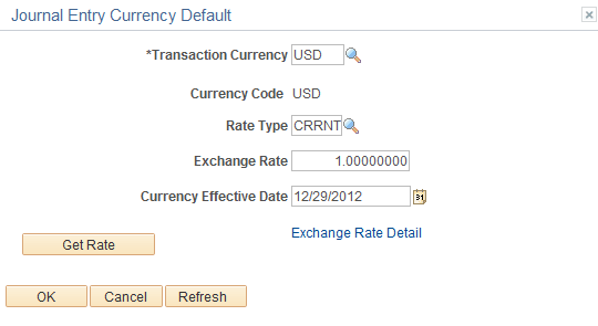

Journal Entry Currency Default Page
Use the Journal Entry Currency Default page (JOURNAL_ENTRY_CUR) to enter the currency information that appears by default in the individual journal lines.
Navigation:
On the Journal Entry - Header page, click Currency Defaults.
This example illustrates the fields and controls on the Journal Entry Currency Default page. You can find definitions for the fields and controls later on this page.
Transaction Currency
Override the default base currency by selecting a value. You can do this only if the Foreign Currency Per Journal option specified on Journal Source, Ledgers For A Unit, and General Ledger Definition, Currency Options page is not set to No Foreign Currencies.
If the Foreign Currency Per Journal option is set to Only One Foreign Currency, you must specify that foreign currency here. Later, when you are entering journal lines, their transaction currency values can be equal to the foreign currency or to the base currency.
Currency Code
Appears by default as the base code currency for the ledger group.
Rate Type
Enter the rate type, which is used to convert amounts.
Exchange Rate
Defaults to the current exchange rate based on your selections.
Currency Effective Date
Appears by default from the journal date, but you can override it.
Get Rate
After you change the transaction currency, rate type, and/or currency effective date on this page, click this button to get the new exchange rate retrieved from the system setup table based on the new information that you just entered.
Exchange Rate Detail
Click this link to access the page that displays exchange rate detail information.

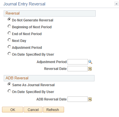

Journal Entry Reversal Page
Use the Journal Entry Reversal page (JOURNAL_ENTRY_RVR) to specify the date options for an automatic reversal entry.
Navigation:
From the Journal Entry - Header page, click the Reversal link.
This example illustrates the fields and controls on the Journal Entry Reversal page. You can find definitions for the fields and controls later on this page.
Select the appropriate reversal option:
Do Not Generate Reversal
Assumes no automatic reversal of this entry. This is the default.
Beginning of Next Period
Creates a reversing entry dated the first business day of the next accounting period. It uses the holiday list ID that you assigned to the business unit on the General Ledger Definition - Definition page to determine the first business day. If the business unit is not assigned a holiday list ID, the reversing entry is dated the first day of the next accounting period.
If the journal is an adjusting journal, the reversing entry is dated the first business day of the first accounting period of the next fiscal year.
End of Next Period
Creates a reversing entry dated the last business day of the next accounting period. It uses the holiday list ID that you assigned to the business unit on the General Ledger Definition - Definition page to determine the last business day. If the business unit is not assigned a holiday list ID, the reversing entry is dated the last day of the next accounting period.
If the journal is an adjusting journal, the reversing entry is dated the last business day of the first accounting period of the next fiscal year.
Next Day
Creates a reversing entry dated the next business day. It uses the holiday list ID that you assigned to the business unit on the General Ledger Definition - Definition page to determine the next business day. If the business unit is not assigned a holiday list ID, the reversing entry is dated the next day.
Adjustment Period
Creates a reversing entry to the adjustment period that you select. When you select this option, enter the adjustment period and reversal date. Enter these values in the corresponding Adjustment Period and Reversal Date fields. The system uses the reversal date to populate the journal date of the reversing entry.
If you enter a date on a nonworking day and there is a holiday list ID assigned to the business unit, you'll receive an error message. The system won't reset the reversal date, and you must reenter a date that is a working day.
On Date Specified By User
Enables you to select any date in the calendar. When you select this option, you must also enter the reversal date.
If you enter a date on a nonworking day, and there is a holiday list ID assigned to the business unit, you'll receive an error message. The system won't reset the reversal date; you must reenter a date that is a working day.
ADB Reversal
If the ledger group supports average daily balance reporting, you must select the method that is used to populate the ADB date of the reversal entry.
Same as Journal Reversal
Creates a reversing entry with the same ADB date as the one selected in the Reversal group box, so that the journal date and ADB date of the reversing entry are the same.
On Date Specified by User
Enables you to select any date in the calendar. When you select this option, you must also enter a value in the ADB Reversal Date field.
If you enter a date on a nonworking day, and there is a holiday list ID assigned to the business unit, you'll receive an error message. The system won't reset the ADB reversal date for you; you must reenter a date that is a working day.
If you specify an ADB reversal date that is on or before the ADB date, you will receive an error message.
Important:
Reversals are identified as valid and ready to post when the Post process creates them, and you do not need to edit them. When the journal date falls within the journal dates, fiscal year, and open periods specified on the Journal Post page, the system posts reversals as soon as they are created.
Use the Create/Update Journal Entries - Lines page (JOURNAL_ENTRY2_IE) to record the debit and credit transactions that make up the journal entry.
Navigation:
General Ledger, and then Journals, and then Journal Entry, and then Create/Update Journal Entries, and then Lines
This example illustrates the fields and controls on the Create/Update Journal Entries - Lines page (1 of 6). You can find definitions for the fields and controls later on this page.
CreateUpdateJournalEntries - Lines (1 of 6)
If you register Accounting Tags for General Ledger, the SpeedType column is replaced by one for Accounting Tag on the Journal Entry — Lines page.
This example illustrates the fields and controls on the Create/Update Journal Entries - Lines page (2 of 6).
CreateUpdateJournalEntries - Lines (2 of 6)
This example illustrates the fields and controls on the Create/Update Journal Entries - Lines page (3 of 6).
CreateUpdateJournalEntries - Lines (3 of 6)
This example illustrates the fields and controls on the Create/Update Journal Entries - Lines page (4 of 6).
CreateUpdateJournalEntries - Lines (4 of 6)
This example illustrates the fields and controls on the Create/Update Journal Entries - Lines page (5 of 6).
CreateUpdateJournalEntries - Lines (5 of 6)
This example illustrates the fields and controls on the Create/Update Journal Entries - Lines page (6 of 6).
CreateUpdateJournalEntries - Lines (6 of 6)
The columns that appear on this page are controlled by your choices on the journal entry template (click Template List link), as well as by clicking the Personalize link to hide or sort columns.

Template List
Click to access the Journal Entry Template List page in which you specify a previously created template that defines the columns that appear in the Lines scroll area. Fields are visible on journal lines unless you create specific journal entry templates to make them unavailable.
See Journal Entry Template List Page.
See Application Fundamentals: Journal Entry Template - ChartField Page.

View Audit Logs
Click this link to launch a new window, which accesses the Search Audit Logs page where you can view an audit trail of the journal events. This page includes information such as user ID, event code, event name, event date and time of the journal processes such as create, delete, edit, mark-to-post, mark-to-unpost, post, unmark-to-post, unmark-to-unpost, unpost and update.
Note: The Search Audit Logs page accesses journal events that are populated in the GL Journal Audit record (GL_AUD_JRNL) if the corresponding events are enabled for audit logging.
See Enabling Journal Audit Logging.
See Search Audit Logs Page.

Process
Select the task that you want to perform and click the Process button. Values are:
  • Budget Check Journal: Select to run the Commitment Control Budget Processor process (FS_BP) to check the journal lines for the control budget. The journal edit process must validate the journal before it can be budget checked.
  • Copy Journal: Select to access the Journal Entry Copy Page. Enter changes in journal information for the new journal.
    This is an online copy journal version of the journal copy process that is performed using Process Scheduler. Descriptions for the fields on this page are the same as those described in the section for the copy journal using PeopleSoft Process Scheduler.
  • Delete Journal: Select to delete the current journal. There are two journal deletion methods: Physical Delete or Logical Delete, which is determined on the Application Fundamentals: Installation Options - General Ledger Page.
    Note:If you select this option and then select the Process button for a journal that is entered by another user, the system performs a security check based on the roles defined in the Authorize Journal Delete section of the Installation Options - General Ledger Page. If your role is not authorized to delete another persons journal, the system displays an error.
  • Edit Chartfield: Select to initiate the journal ChartField Edit process (GL_JEDIT_CF0) to verify whether the journal has any ChartField-related errors, including ChartField edit, combo ChartField edit, and alternate account edit.
  • Edit Journal: Select to immediately initiate the Journal Edit process (GL_JEDIT_0). If the journal passes the edit check, you must select the journal to submit for approval.
    Note:When you select the Process button, an alert message displays, which provides the option to wait until the Edit process completes or exit the page. If you select to exit the page, another message is displayed with the details of the scheduled edit process. You can verify the journal edit process at a later time using the process instance number. Use the Display Confirmation Message check box on the Application Fundamentals: User Preferences - General Ledger Page to turn this option on or off by user .
  • Post Journal: Select to immediately initiate the Journal Post process (GL_JP). If the journal requires validation, the Journal Edit process automatically initiates prior to posting. If you are using PeopleSoft Workflow and require approval, you'll receive an error message if you select this option for unapproved journals. If the Enable Online Journal Post check box is not selected on the Application Fundamentals: User Preferences - General Ledger Page, then this option is not available.
    Note:When you select the Process button, an alert message is displayed. This message provides the option to wait until the Post process completes or exit the page. If you select to exit the page, another message is displayed with the details of the scheduled post process. You can view the Process Monitor using the process instance number. If you attempt to post a journal that is under the edit process, then a message is displayed. Use the Display Confirmation Message check box on the Application Fundamentals: User Preferences - General Ledger Page to turn this option on or off by user .
  • Print Journal: Select to create the Journal Entry Detail report (GLX7501, or GLX7502, for separate debit and credit transactions), which is a printed copy of the journal in BI Publisher format.
    Note:When you select this option and then select the Process button, the Report Manager and Process Monitor links become available.
  • Refresh Journal: Select to retrieve the journal from the database to the page again. You can do this when you think others may have changed the journal after you originally retrieved it.
  • Submit Journal: Select to initiate journal edit and journal approval through workflow processing.
    After selecting the Process button, the Journal Approval Comments window appears. Optionally, enter comments and select OK. These comments stay with the journal through the approval process even if the journal is denied. The entered comment is passed to all business units for InterUnit journal entries.
    If you are not using PeopleSoft Workflow, an error message is displayed. When submitted, the worklist items for the user who submitted the journal is marked as worked.
    Note:For the sake of efficiency, you can edit journals and post later using background processing. However, if you want to edit and post faster, you can select the options listed on this page.
  • Edit / Pre-Check: This selection only appears if Enable Budget Pre-check is selected for General Ledger on the Application Fundamentals: Installation Options - Commitment Control Page. When you select this option, the journal is edited and processed through the Budget Processor. However, the Budget Processor only checks the journal and the funds are not reserved. For example, Commitment Control amounts are not posted to LEDGER_KK.
Errors Only
Select to refresh the Line scroll area with only journal lines that contain errors. To move sequentially through all journal lines that have errors, click the first row arrow to the left of the chunking text box to move to the first line of the journal before selecting the Errors Only check box.

Award
Click the Award Data link in the Federal column to open the Federal Award Data Page, where you can enter Financial Assistance and Procurement Award numbers, or the system populates the data imported from a third party.
To enable this link, you must enter Federal Award Data options on the Application Fundamentals: Installation Options - Federal Processing Options Page. The link is available when you select the Enable Procurement Fields check box and/or the Enable Financial Assistance Fields check box.
Use the Selection Criteria page (JRNL_SRCH_SEC) to specify search values for any or all fields listed.
Navigation:
On the Journal Entry - Lines page, click the Search Criteria link.
This example illustrates the fields and controls on the Selection Criteria page. You can find definitions for the fields and controls later on this page.
When you enter the search criteria, the GL Journal Line Number field displays the starting line number for your search. For example, if you enter 1 here and 10 in the number of lines text box next to the Errors Only check box on the Journal Entry - Lines page, the system retrieves journal lines 1 through 10. Enter the selection criteria, including any wildcards. These wildcards assist you in finding the exact information that you need. Unless you enter one of the following wildcards, General Ledger assumes that you want an exact match:
Match one or more characters. For example, to look for all accounts beginning with a "2", use "2%".
Match one or more characters. For example, use "2*".
_
Match any single character. For example, use "20000_".
Match any single character. For example, use "20000?".
If first character, negate the user (not equal or not like). For example, "!5%" retrieves all values that do not begin with a "5".
Tilde—represents a blank character—this should not be used with any other characters or wildcard symbols.
Escape character—do not treat the next character as a wildcard.
For example, you could search for a blank in the Account, Operating Unit Department, Product, Project ID, Affiliate and Foreign Currency Code fields by entering a tilde (~) in each field.
Return to the journal Lines page.

  5. If it is a MultiBook ledger group with auto-generate lines turned on, the system also reflects the changes to the corresponding secondary ledger lines.

Encountering Errors in the Calculate Amount Process
The Calculate Amount process performs various checks, including separate debit and credit amount checking, as well as exchange rate checking. When the process encounters an error, an error message appears and the Error field changes to red. The process does not necessarily stop on an error. If the Calculate Amount process has been automatically initiated, the process may behave differently. In some instances, the process stops, and in other instances, it continues. Here are various scenarios:
  • When you save a journal, the save process stops, an error message appears, and the journal cannot be saved until you correct the error.
  • When you click the Insert Journal Lines button to insert new lines, the insert process stops, an error message appears, and new lines cannot be inserted until you correct the error.
  • When you click the Delete Selected Journal Lines button, the lines identified as deleted are first deleted and then the Calculate Amount process is initiated. If the process encounters an error, those identified lines are deleted.
  • When you click the Secondary Lines (>>) button to access a secondary lines page, the Exchange Rate Detail (>>) button to view the exchange rate detail, or the VAT link to access the VAT page, you cannot transfer to the pages until you correct the error.

If the base currency for the business unit differs from your entry transaction currency (foreign currency), enter the rate type and/or the exchange rate to convert to the appropriate base amount. If you want the system to retrieve a defined exchange rate, enter only the rate type. As a result, the system automatically populates the exchange rate, base amount (or base DR amount and base CR amount if using the Separate DR/CR option) fields.
The Exchange Rate field value must always be 1, and the foreign Amount field must equal the base amount when the journal line is a base currency line.
Journal entries loaded to your system using spreadsheet journals import or flat file journal import must be edited using batch edit only. Imported journals do not yet have all values populated and should not be edited online. After importing journals if you open them online you get a warning message stating that they must be edited first. It is only after the batch edit that the journals display complete and correct information regarding separate debit credit reversals and the appropriate monetary amount sign.
Retrieving a System Rate
To retrieve a system rate, the from currency, to currency, rate type, and currency effective date values are all required. Without any one of them, the system-derived exchange rate cannot be retrieved. Usually, the from currency is the foreign currency, the to currency is the base currency, and the currency effective date is specified as the currency default on the Journal Header page.
The system uses the following rules when retrieving the system rate to be used as the exchange rate for the journal line:
  • The system uses the rate type value specified on the line to retrieve the system rate.
    However, this does not ensure successful retrieval of a system rate. If there is no market rate defined for the transaction currency, the retrieved system rate may be zero. In this case, a message is issued to alert you to the zero exchange rate value.
  • If there is no rate type specified on the line, the system rate is zero.
See PeopleSoft Global Options and Reports: Defining Market Rates.
Entering an Exchange Rate Manually
When you manually enter an exchange rate on a foreign currency line, the rate that you enter overrides any automatically generated system rate. This occurs even if you enter a rate type.
The Rate Type field is clear when you manually enter values. However, the manual rate may not be accepted by the system.
The system performs the following two tests for manually entered exchange rates:
  • The system checks the currency quotation method. If the method is defined as Triangulation, Cross Rate as the Primary Visual Rate, and Do Not Allow Cross Rate Override, you cannot enter a manual rate. If you try to enter a manual rate, an error message appears, and the system ignores the manual rate. This currency quotation method requires the rate type to retrieve the system rate and issues an error message requiring you to enter a rate type to continue.
  • The variance between the system rate and the manual rate is calculated, and if it is over the tolerance that you defined for maximum variance on the Rate Definition page, a stop error type or a warning message appear, depending on the setting. You cannot enter a manual rate if you receive a stop error type. A warning message allows you to continue.
The system must use slightly different rules to retrieve the system rate when it is to be used as the base rate for variance checking. The reason is because if the rate type specified on the line is blank, the system cannot use a zero value for variance checking.
The system must find a nonblank rate type to retrieve the system rate to use as the base rate for variance checking. The system is subject the following hierarchy of rules:
  • Use the rate type specified on the journal line if it is not blank.
  • Use the rate type specified on the journal header if it is not blank.
  • Use the rate type specified for the ledger on the Detail Ledger Group Definition page.
  • Use the required default rate type specified for the ledger on the Detail Ledger Group Definition page.
To use exchange rate variance checking functionality, define the market rates.

Calculating Using the Calculate Rules
The calculate value determines how and which of the foreign amount, exchange rate, and base amount fields are calculated for the line item. The default calculation rule is system rule.
If the values generated for foreign amount, exchange rate, or base amount by the system rule are different from those that you want, you can change them using other calculate rules.
When you change any of these values, you must be aware of the possible actions and select the correct calculate value to achieve your proposed change. For example, if you want to change the foreign amount and not the base amount, but you expect the system to calculate and change the exchange rate to result in the original base amount, the system rule does not calculate the exchange rate but does calculate the base amount.
Changed means the new value is different from the prior value. The new value can be zero or nonzero. The prior value can also be zero or nonzero. If you change a field to a new value but then change it back to the prior value before you initiate the calculation process, the field is treated as unchanged. The system tracks changes by comparing the prior value stored in the buffer with the new value when the calculation process is initiated.
Here are the calculate rules and their actions:
System Rule
This is the default value and uses the following rules to calculate values:
  • When two of the three values change, the unchanged value is calculated.
  • When only the foreign amount changes, and if the exchange rate is not zero, the base amount is calculated.
    If the exchange rate is zero, the exchange rate is calculated.
  • When only the base amount changes, and if the exchange rate is not zero, the foreign amount is calculated.
  • When only the exchange rate changes, and if the foreign amount is not zero, the base amount is calculated.
    If foreign amount is zero, the foreign amount is calculated.
  • When you change all three values, make sure that the values are correct.
    The system calculates the base amount and compares it with the base amount that you entered. If they are unequal and if none of the three values is zero, an error message appears, and you must correct the values. If one of the three values is zero, its value is calculated.
Amount
Calculates the foreign amount when you provide the exchange rate and base amount.
Base Amount
Calculates the base amount when you provide the foreign amount and exchange rate.
Exchange Rate
Calculates the exchange rate when you provide the foreign amount and the base amount.
You can use the journal entry template to make the Calculate field unavailable just as you can do this with other fields. For example, you can define a base currency journal entry template that can be used for entering base currency lines only.
Checking When the Exchange Rate is Calculated
The exchange rate is calculated based on the foreign amount and monetary base amount when the following are true:
  • The Calculate field value on each journal line is set to Exchange Rate.
  • The Calculate field value on each journal line is set to System Rule, and both the foreign amount and monetary base amount change.
  • The Calculate field value on each journal line is set to System Rule, the foreign amount (or monetary base amount) changes, the exchange rate doesn't change, and the exchange rate value is zero.
  • The Calculate field value on each journal line is set to System Rule; the foreign amount, monetary base amount, and exchange rate all change; the monetary base amount is not equal to foreign amount multiplied by exchange rate; and the exchange rate value is zero.
The system also performs two exchange rate tests to:
  • Check the currency quotation method.
    If it is defined as Triangulation, Cross Rate as the Primary Visual Rate, and Do Not Allow Cross Rate Override, a system rate must be used, because the exchange rate cannot be calculated.
  • Check the variance between the system rate and the calculated exchange rate to determine whether its over tolerance.
    The calculated exchange rate cannot exceed the tolerance if the error type is stop.
The Journal Entry process uses deferred processing, which reduces the number of trips to the server. For example, when you enter a department ID, the system won't validate your entry until the next trip to the server is requested.
Open Item Key
This field is only required in the case of open item transactions, such as deposit accounts or employee draw accounts. In such cases, enter the open item key against which the journal line is applied. For example, suppose that US001 has an open item account for employee advances, where the open item key is the employee's social security number. When you debit or credit this account, you would be required to enter the appropriate employee social security number in the Open Item Key field. In this way, journal lines containing open item transactions are matched to the individual open items being tracked within General Ledger.
This field is available unless you exclude it from the journal line using the Journal Entry template. If you enter an open item account, you must also enter an open item key or you'll receive an error message when you save. Also, if you enter an open item key for an account that is not an open item account, you'll receive an error message when you save.
Suspended Line
This column references the edit (or amount) suspense line to the line in error (Line 1) and vice versa. The Suspended Line column is always be equal to its journal line for balance suspense lines.
Budget Date
Enter the date used to determine the budget period of the control budget if you use the commitment control option. The budget date value appears by default as the journal date, but you can override it.
Reference
The field enables you to refer each line back to a document, person, invoice, date, or any other piece of information that helps you track the source of the transaction.
Journal Line Description
Defaults to the description defined for the account ChartField value; you can change this to better describe the transaction. The description appears in prompt lists for this journal line.
Note: If you use journal line copy down on this field, the default value of the field is copied from the previous line instead of from the account ChartField.
VAT
When you click this link, an error message appears if the account is a non-VAT account or VAT processing is not applicable. You can use the journal entry template to make the VAT link unavailable or on journal lines.
TAS (Treasury Account Symbol)
This field is displayed only when the CTA check box is selected. The TAS that is associated with the Fund code for the line appears by default.
BETC (business event type code)
Select the BETC for the journal line. This field is displayed only when the CTA check box is selected. Only BETCs associated with the TAS are displayed.
The Journal Entry process uses the columns selected in the journal entry template to display the values in the line scroll area. If any columns listed above do not appear in your journal line, it is likely that these columns are not selected in your journal entry template. You must modify your journal entry template to select these columns or choose another journal entry template that has these columns selected.
Totals
To aid in balancing the journal, a running total of the number of lines, the total debits, total credits, journal status, and budget status of the journal appear at the bottom of the Journal Entry - Lines page. Only balanced entries can post to balanced ledgers.
Journal Status
If the journal contains errors, you can click the status to go directly to the Journal Entry - Error page. The cursor is positioned on the journal header error.
D: Deleted - Anchor Journal Unposted.
I: Posting Incomplete - Repost ASAP.
M: Valid SJE Model - Do not Post.
E: Journal has Errors.
N: No Status - Needs to be Edited.
P: Posted to Ledgers.
T: Journal Entry Incomplete.
U: Unposted.
V: Valid journal - Edits completed.
Z: Upgrade Journal - Can't Unpost.
Budget Status
Click this link if the budget status is Error or Valid (with warning), to access the Commitment Control page, where you can view the error or warning messages. You can also flag the journal to make it pass budget checking, even though it exceeds the budgeted amount. Values include:
  • E: Error - The entry failed budget checking.
  • N: Not Processed - The Budget Processor has not processed the entry.
  • P: Provisionally Valid - The entry passed budget checking but the Budget Processor has not committed the changes to the control budget (LEDGER_KK). This results when selecting the Budget Check Only option when processing the journal.
  • V: Valid - The entry passed budget checking with or without warnings and the Budget Processor has updated the control budget (LEDGER_KK).
Use the Journal Entry Template List page (JOURNAL_ENTRY_TMP) to select the journal entry template that defines which columns appear in the lines scroll area.
Navigation:
On the Journal Entry - Lines page, click the Template List link.
This example illustrates the fields and controls on the Journal Entry Template List page: Chartfield tab. You can find definitions for the fields and controls later on this page.
Select the template that includes the columns that you want to appear in the Journal Entry - Lines page scroll area.
Also specify the field values to be copied down to new lines when you click the Insert Journal Lines button on the Journal Lines page. The journal line copy-down settings for templates appear in Journal Line Copy Down group box at the bottom of the same page as the Journal Entry Template grid.
Chartfield Tab - Journal Entry Template
Select the Chartfield tab.
If a particular ChartField column is selected, it does not necessarily appear on the journal line grid. It appears only if the column is selected and it is one of the ChartFields for the current journal's ledger. For example, if scenario is not a ChartField for the current journal's ledger, it is not shown on the journal line grid even if it is selected on the template. Active project ChartFields, such as PC Business unit, Activity, Source Type, Category, Subcategory, and Analysis Type are available if Project ID is selected in the template.
Selected
Indicates the template you are currently using. This is the only field you can select on the Journal Entry Template - Show Journal Line Grid Columns page.
Template Type
Identifies who would use the template. For example, anyone could use an All template type.
Template ID
Displays the name for the template.
Default
This check box is selected if the template was designated as the default template on the Journal Entry Template - Template page. You can change the default only on the Journal Entry Template - Template page.
If you want to add or change a template definition, you must do so on the Journal Entry Template page (Set Up Financials/Supply Chain, Common Definitions, Journals).
Chartfield Tab - Journal Line Copy Down
When you add a journal line on the Journal Entry - Lines page, the fields that you selected on the Journal Entry Template - Journal Line Copy Down page are copied from the preceding line.
You define a variety of copy down templates on the Journal Entry Template page. You can select any of these copy down templates for your journal when you click the Template List link from the Journal Entry - Lines page. These predefined templates copy down the values for the fields that are selected on the template when you enter journals. For example, you can define one template to copy down all fields and another to copy down all fields except the amount fields.
You can temporarily change your copy down selections on the Journal Entry Template List page for the current journal. However, these changes are ignored after you exit the current journal. To save the changes, you must do so on the Journal Entry Template page, which is accessed under Set Up Financials/Supply Chain, Common Definitions, Journals, Journal Entry Template.
Action
Select to Check All or Uncheck All check boxes for a Copy Down ID.
Default
Select if the template was designated as the default template on the Journal Entry Template - Template page.
Amount Tab
Select the Amount tab.
This example illustrates the fields and controls on the Journal Entry Template List page: Amount tab. You can find definitions for the fields and controls later on this page.
This tab displays the amount-related columns that will appear on your journal for the Template ID that you select. From the Journal Line Copy Down group box, select the amount-related columns that you want to be copied down when you add a journal line.
Miscellaneous Tab
Select the Miscellaneous tab.
This example illustrates the fields and controls on the Journal Entry Template List page: Miscellaneous tab. You can find definitions for the fields and controls later on this page.
The Journal Entry Template List - Miscellaneous tab displays the miscellaneous columns that will appear on your journal for the Template ID that you select. From the Journal Line Copy Down group box, select the miscellaneous fields that you want to be copied down when you add a journal line.
Even if the Budget Date check box is selected, it does not necessarily appear as a column on the journal line grid. It appears only if you select it here and the current journal line has the Commitment Control process enabled. Similarly, if you select the VAT column here, it appears as a column on the journal line grid only if you select it here and the business unit of the current journal line has the VAT process enabled.
Use the Search Audit Logs page (FS_AUDITLOG_SEARCH) to view the audit trail for the journal entry.
Navigation:
On the Journal Entry - Lines page, click the View Audit Logs link.
Upon clicking the View Audit Logs link, a new window launches with the Search Audit Logs page, which displays the audit log data for the journal. You can enter search criteria and view audit log information for other journals as well.
This example illustrates the fields and controls on the Search Audit Log page. You can find definitions for the fields and controls later on this page.
The search results display journal audit data by event code, which is defined on the Register for Audit Logging page (this page cannot be accessed through the menu).
See Application Fundamentals: Setting Up Financials Audit Framework (Audit Logging).
Use the Projected Balance page (TACCOUNT_VIEW_SEC) to check the effect of a particular line on the relevant balance (same ChartField combination) directly from the Journal Entry - Lines page. Enable the Projected Balance field to appear on the Lines page by selecting a Journal Entry Template that includes the that field. The Projected Balance field is located on the Miscellaneous tab of the Journal Entry Template page for selection. Once you have enabled the Projected Balance field within a Journal Entry Template, make sure you have selected that particular template by clicking the Template List link from the Lines page.
The Projected Balance feature includes Multibook capabilities as well as Separate Debit and Credit functionality.
Navigation:
Click the Projected Balance link from the Lines page to access the page, which opens in a modal window:
This example illustrates the fields and controls on the Projected Balance page. You can find definitions for the fields and controls later on this page.
Project Balance page
Business Unit, Ledger and ChartField Combination
This section displays the combination of field values of the journal line for which you have selected when clicking the Projected Balance link to access this page.
Current Balance
This amount reflects the current ledger balance (prior to the posting of the selected journal line) of the selected line’s ChartField combination (in the example, Account 400000 for the PRNTRS product within Department 21000.
The second line reflects the selected journal line amount. It is displayed as a proposed addition to the current balance.
Projected Balance
This amount reflects what the ledger balance of the selected ChartField combination would be if the selected journal line is posted.
Use the Federal Award Data page (RNL_LNFED_SEC) to view values for Procurement Award and Financial Assistance elements in the PeopleSoft purchase order staging tables
Navigation:
Click the Award Data link on the Journal Entry - Lines page. Or, click the Federal Award Data link on the Purchase Order - Header page.
This example illustrates the fields and controls on the Federal Award Data Page
Data for the PIID, Parent PIID, FAIN, and URI fields can be supplied by third-party procurement and grants management systems, and uploaded into the PeopleSoft Purchase Order staging tables.
The PIID, Parent PIID, FAIN, and URI fields are displayed only if enabled on the Application Fundamentals: Installation Options - Federal Processing Options Page.
PIID
Displays the PIID (Procurement Instrument Identifier Data) based on the length defined on the Application Fundamentals: Installation Options - Federal Processing Options Page.
Parent PIID
Displays the Parent PIID data based on the length defined on the Application Fundamentals: Installation Options - Federal Processing Options Page. The PIID must be entered if the Parent PIID field is populated.
FAIN
Displays the FAIN (Federal Award Identification Number) data based on the length defined on the Application Fundamentals: Installation Options - Federal Processing Options Page.
URI
Displays the URI (Universal Record Identifier) data based on the length defined on the Application Fundamentals: Installation Options - Federal Processing Options Page.
Exclude from DATA Act Reporting
Select this check box to exclude the journal line from DATA Act reporting for File C.
If this check box is selected, the PIID, FAIN, or URI must be populated, depending on which fields are enabled at the installation level
The system returns an error if the Installation Federal Award Data display length for PIID, Parent PIID, FAIN, and URI as defined on the Application Fundamentals: Installation Options - Federal Processing Options Page is less than the actual value populated.
Use the Secondary Ledger Lines page (JOURNAL_ENTRY_SEC) to view secondary ledger lines.
Navigation:
Click the Secondary Lines button on the Journal Entry - Lines page.
This example illustrates the fields and controls on the Secondary Ledger Lines page. You can find definitions for the fields and controls later on this page.
This page or related pages operate in deferred processing mode. Most fields are not updated or validated until you save the page, refresh it by clicking a button or link, or selecting a tab. This delayed processing has various implications for the field values on the page. For example, if a field contains a default value, any value that you enter before the system updates the page overrides the default. Another implication to keep in mind is that the system updates quantity balances or totals only when you save or click the Calculate Amount button.
Displays the secondary ledger for the journal lines when they exist, as well as the other journal details. When you enter a primary journal line, the system automatically populates the secondary journal line's rate type, retrieves the exchange rate, and calculates the base amount.
Rate Type
This field is populated in the following order:
  • Rate type defined on the Ledger Group - Definition page.
  • Rate type entered for the primary journal line.
  • Default rate type defined on the Ledger Group - Definition page.
Rate Type, Exchange Rate, and Base Amount
You can override the values in the fields. When you are done, click the Back to Primary Lines button next to the secondary ledger field. The cursor is positioned at the primary line of the secondary ledger.
Calculate Amount icon
The Calculate Amount button is available on the Secondary Journal Lines page, and the process is similar to the calculation on the Journal Lines page; however, the foreign amount cannot be changed on the secondary page.
Click to return to the Journal Entry - Lines page.
Before making changes to the secondary lines, carefully review the calculate rules, options, and requirements for various changes that are detailed in the documentation for the Journal Entry - Lines page.
Use the Journal Entry - Totals page (JOURNAL_ENTRY_T_IC) to specify control debit and credit amounts, unit value of statistical entries, and the number of lines.
Navigation:
General Ledger, and then Journals, and then Journal Entry, and then Create Journal Entries, and then Totals
This example illustrates the fields and controls on the Journal Entry - Totals page. You can find definitions for the fields and controls later on this page.
This page or related pages operate in deferred processing mode. Most fields aren't updated or validated until you save the page, refresh the page by clicking a button or link, or selecting a tab. This delayed processing has various implications for the field values on the page—for example, if a field contains a default value, any value that you enter before the system updates the page overrides the default. Another implication to keep in mind is that the system updates quantity balances or totals only when you save or otherwise refresh the page.
Control Totals
Specify the total debits, credits, statistical units, and number of lines to be entered for each unique combination of business unit, ledger, transaction currency, and additional balancing ChartFields (like book code and balance sheet indicator if they are set to active at Installation Options - Overall page, and so on). As you enter the journal lines, the system displays a running total of the actual debits, credits, units, and lines, as well as the net difference between the amounts entered and the control totals. If you leave any of the control total fields blank, the system won't validate against the associated actual total.
For example, suppose that you have plans to allocate rent expense across several departments and know that the total rent expense is 50,000 USD for 2,000 square feet. Because you know how many departments are involved, you know that there will be 15 lines in the completed journal entry. You enter these amounts as control tables to ensure that when one of your staff members enters the journal lines, these figures match before the journal is posted.
Control totals are maintained by business unit, balancing ledger, balancing ChartFields (if any), and currency code. If you enter an interunit journal, for example, the system maintains a set of control totals for each business unit. Also, if additional balancing ChartFields are defined, the system maintains a separate set of control totals for each unique combination of the ChartFields entered.
Actual Totals
When the journal lines are entered, the system calculates the actual total and compares it against any entered control totals.
Differences
When the journal lines are entered, the system calculates the actual total and compares it against any control totals entered and notes any differences in amounts.
When you edit the journal and the control totals, and they don't equal the actual totals, the system flags the journal as having errors, and you must correct the errors before you can post.
Refresh the page after any changes.
Use the Journal Entry - Errors page (JOURNAL_ENTRY_E_IC) to determine which errors the system encountered.
Navigation:
General Ledger, and then Journals, and then Journal Entry, and then Create Journal Entries, and then Errors
This example illustrates the fields and controls on the Journal Entry - Errors page. You can find definitions for the fields and controls later on this page.
You can view journal header and line errors on the Errors page of the journal entry component. You can also view journal entry line errors on the Journal Entry - Lines page by clicking the X in the Error column. You are directed to the Journal Entry - Errors page to review explanatory text. When General Ledger encounters errors during editing, it marks the journal lines and either recycles or suspends the journal. It saves recycled journals but won't post them until you correct the errors. You can post entries to your suspense account that have invalid ChartFields, different signs on the transaction and base amount, or unbalanced debit and credit amounts. You define error-processing options at the business unit, ledger group, and journal source level. Access the Journal Entry - Errors page to determine which errors the system encountered. When you are finished, click the line number in error. This enables you to access the Journal Entry - Lines page. The cursor is positioned on the line and field in error, so that you can make corrections.
This page or related pages operate in deferred processing mode. Most fields are not updated or validated until you save the page or refresh it by clicking a button, link, or selecting a tab. This delayed processing has various implications for the field values on the page. For example, if a field contains a default value, any value that you enter before the system updates the page overrides the default. Another implication to keep in mind is that the system updates quantity balances or totals only when you save or otherwise refresh the page.
Field Name
Displays the field in error, as well as message sets that contain the error message, message number, and message text.
Unit
Click to access the Journal Entry - Lines page and position the cursor on the Journal Status link located in the Totals scroll area.
Line #
Click to access the Journal Entry - Lines page and position the cursor in the line and field with the error.
See Journal Error Processing.
Use the Create/Update Journal Entries - Approval page (JOURNAL_ENTRY_A_IC) to select the current journal for approval if you have enabled PeopleSoft workflow to approve journals for posting.
Navigation:
General Ledger, and then Journals, and then Journal Entry, and then Create Journal Entries, and then Approval
This example illustrates the fields and controls on the Journal Entry - Approval page when the Approval Status is Pending Approval.
Create/Update Journal Entries - Approval (Pending Approval)
This example illustrates the fields and controls on the Journal Entry - Approval page when the journal is reworked and the Approval Status is None.
If you have enabled approval workflow and validated the journal, you can submit it for approval from this page. You can configure the Approval Framework to enable journal approval using the Journal Entry component. With this configuration, approvers can access the journal entry for approval through their worklist. You can also enable the journal email approval process using Integration Broker and the Email Collaboration Framework (EMC).
You can also use the GL Journal Approval component (Manage GL Journal Approval component for mass journal approval).
Understanding Configurable Workflow
See Approving Journals Using the GL Journal Approval Components.
Submit
Select to record the option selected in the Approval Status field.
Approval Check Active
Displays whether there is an approval workflow process required for the journal.
See General Ledger Definition - Approval Options Page.
Approval Status
Select and Approval status:
  • Denied - Journal is denied.
  • Pending Approval - Journal is waiting for approval.
  • Approved to Post - Journal is approved and ready to post to the general ledger.
  • Pushed Back - Journal has been pushed back to previous approval step.
  • None - Not applicable.
Approval Action
Select the appropriate action for this journal:
  • Approve - Select to approve the journal for posting. If you have the authority to approve the journal, the system saves it as usual. If you do not have the authority, you are prompted to enter the journal into PeopleSoft Workflow.
  • Deny - Select to indicate that the Journal is not approved for posting. If you change the action to deny, the system sends an email to the previous user with a list of the journal identifiers and the reasons entered in the Comments field.
Comments
Optionally, enter comments and select Submit. These comments stay with the journal even if the journal is denied.
To enter individual comments for InterUnit journal entries, select the 1 of 2 and 2 of 2 button in the upper/right.
Copy Comments to All Business Units
Select to copy an entered comment to all business units for InterUnit journal entries.
View Approved History
Select to access the Approval Flow window, which displays the history of approvers and their comments. The link only appears when a journal is reworked and not submitted for approval.
Approval History
Displays the step and path, with the status and applicable date and time stamp and user ID for the various activities in the approval process.
