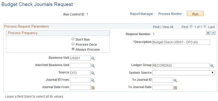

Budget Check Journals Request Page
JOURNAL_BGTCHK_REQ
Runs the Commitment Control Budget Processor to budget check all edit-valid commitment control journals.
To access this page, select General Ledger Journals Process Journals Budget Check Journals.

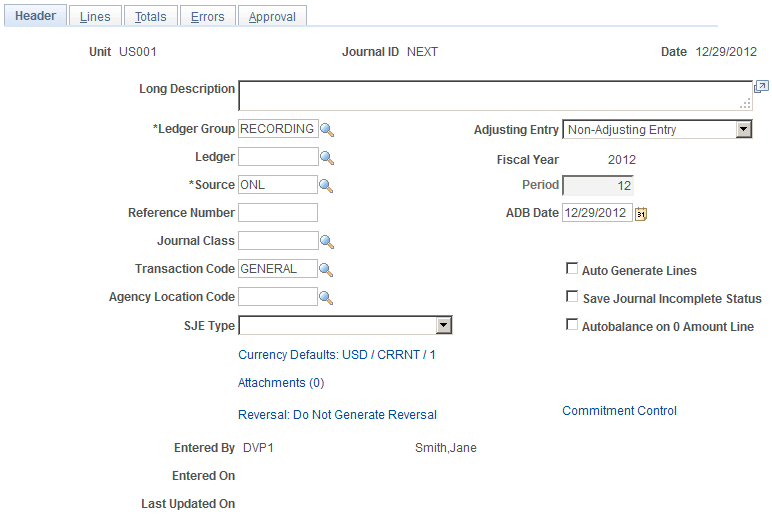

Entering Header Information for Commitment Control Journal Entries
Use the Journal Entry - Header page (JOURNAL_ENTRY1) to select the appropriate ledger and ledger group to apply to this journal entry.
Navigation:
General Ledger, and then Journals, and then Journal Entry, and then Create/Update Journal Entries, and then Header
This example illustrates the fields and controls on the Journal Entry - Header page.
An actuals ledger refers to a part of the RECORDING Ledger Group shown in the sample data and is used to distinguish the actual transactions ledgers from the commitment control budget ledgers. A detail ledger refers to ledgers that record actuals, preencumbrances, encumbrances, revenue, and collected revenue amounts at a detail account level rather than at a rolled up or summary account level.
Field or Control Description
Ledger Group
You can enter and post a journal directly against a commitment control ledger by selecting a commitment control expenditure or revenue ledger group.
Ledger
Select a ledger within the group. If you select a Commitment Control ledger group, you can create and post journals for the pre-encumbrance, encumbrance, recognize revenue, or collected revenue amounts against only the commitment control ledgers. However, these amounts are not posted to the actuals ledger. To post any of these amounts in the actuals ledger, you must create the journal entries that post to your actuals ledger.
If you select a specific Commitment Control ledger group and detail ledger, then the selected detail ledger is the only ledger updated. If you select an actuals ledger and then select the option to do a commitment control adjustment, all commitment control ledgers associated with this actuals ledger (the association is done on the Ledgers For A Unit page) are updated if the adjustment applies.
If you are only adjusting one specific commitment control ledger, select the commitment control ledger group and its ledger. This enables you to access the selected commitment control ledgers directly to create your adjustments. You do not have to click the Commitment Control link because the nature of the ledger group and ledger that you selected automatically identifies the type of adjustment. However, if you select commitment control ledger group, you cannot specify entry event on the journal line. This means that you have to manually create the corresponding budgetary accounting entry.

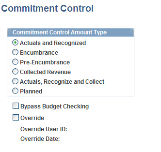

Commitment Control Page
Use the Commitment Control page (JOURNAL_ENTRY_KK) to select a commitment control amount type to determine the type of processing required for the journal entry lines.
Navigation:
Click the Commitment Control link on the Journal Entry - Header page.
This example illustrates the fields and controls on the Commitment Control page. You can find definitions for the fields and controls later on this page.
The Budget Processor (FS_BP) determines how to update the control budget based on the commitment control amount type that you select.
  • You can update the commitment control budget ledgers and also post the journal to the actuals ledger when you select the amount type Actuals and Recognized or Actuals, Recognize and Collect.
  • You must select the commitment control amount type Encumbrance, Pre-Encumbrance, or Collected Revenue to make commitment control budget adjustments to these ledgers without updating the actuals ledger.
    You can use entry events to generate the corresponding budgetary accounting entry and post to the actuals ledger.
  • You can also bypass commitment control budget checking or override commitment control budget exceptions by selecting the Commitment Control link and selecting the appropriate check box.
When you select this option, the journal records the transaction in the actuals ledger and also in the appropriate Commitment Control ledger (expenditure or revenue) based on the ChartFields used in the journal line. Selecting this type enables you to select the entry event codes on the journal line that use the GLJE Entry Event Process. Select the commitment control amount type that represents this journal. Budget Processor (FS_BP) determines which commitment control budget ledger to update.
Encumbrance
An encumbrance is an amount that you are legally obligated to pay based on a contract or a purchase order. You select this option when you want to adjust the Commitment Control encumbrance ledger that affects your budget amounts. After selecting this option, you return to the journal line, select the BUDJEADJ entry event code, which enables you to select the entry event codes on the journal line that use the GLJEADJ entry event process, which include GL_JENC, GL_JPRNC and GL_JCREV Entry Event source transactions. Enter the adjustments that you want to make to the Commitment Control budget journal. When you edit and budget check this transaction, the encumbrance amounts is updated in the associated Commitment Control budget journal ledgers. You run the Entry Event Processor for this journal entry in batch mode to generate the accounting lines that you want to update and post in the actuals ledger. Then you run Journal Generator to create the journals and post the journals to the actuals ledger.
See GLJEADJ Entry Event Process.
Note: If you specified a Commitment Control ledger group along with a Commitment Control ledger on the Journal Header page, the Commitment Control amount type is already determined, and the Commitment Control Amount Type page is not enabled.
Pre-Encumbrance
A pre-encumbrance is the amount that you intend to spend when you create a requisition. You select this option when you want to adjust the Commitment Control pre-encumbrance ledger that affects your budget amounts. After selecting this option, you return to the journal line, select the BUDJEADJ entry event code, which enables you to select the entry event codes on the journal line that use the GLJEADJ entry event process, which include GL_JENC, GL_JPRNC and GL_JCREV Entry Event source transactions. Enter the adjustments that you want to make to the Commitment Control budget journal. When you edit and budget check this transaction, the pre-encumbrance amount is updated in the associated Commitment Control budget journal ledgers. You run the Entry Event Processor for this journal entry in batch mode to generate the accounting lines that you want update and post in the actuals ledger. Then you run Journal Generator to create the journals and post the journals to the actuals ledger.
Selecting this type enables you to select the entry event codes on the journal line that use the GLJEADJ entry event process, which includes GL_JENC, GL_JPRNC, and GL_JCREV entry event source transactions.
Note: If you specified a Commitment Control ledger group along with a Commitment Control ledger, the Commitment Control amount type is already determined, and the Commitment Control Amount Type page is not enabled.
Collected Revenue
When you select this option, this journal records the amount of revenue collected based on a previously entered revenue transaction. This updates the Collected Revenue ledger of a Commitment Control Revenue Budget.
When you select this option, this journal records both the amount of revenue booked and the amount of revenue collected, and updates the Revenue Estimate Commitment Control Budget.
Note: You can select entry event codes for Planned Commitment Control amount type; however, the Entry Event Processor will not process this Commitment Control amount type.
Planned
Select this type to enable you to select the entry event codes on the journal line that use the GLJEADJ entry event process. However, the entry event processor does not run for the codes you select on the journal line. Instead, the journal amount that you plan to spend is recorded. This planned amount is only an estimate and is not yet an actual transaction and is updated in the Planned Commitment Control ledger in the Commitment Control ledger group.
Bypass Budget Checking
Select this option to allow the journal to bypass budget checking.
Note: If you select Bypass Budget Checking, the Entry Event Processor does not create accounting lines for the journal.
Override
Select this option to allow the transaction to pass budget checking if any overrideable exceptions exist for this journal, like the amount of the transaction exceeds the budget amount.
Override User ID
If you selected the Override option and you override the budget for a transaction, the system updates this field with your user ID.
Override Date
If you override a budget transaction, the system updates this field with the transaction date.
If the journal contains a journal line that has an account value that does not belong in the ledger represented by the selected Commitment Control amount type, the budget processor will not process the line nor update the commitment control ledger data table. For example, if one journal line contains a revenue transaction, and you selected pre-encumbrances as the Commitment Control accounting type, then budget processor will not process this line.
Use the Budget Check Journals Request page (JOURNAL_BGTCHK_REQ) to select the journals (or range of journals) for which to run the Commitment Control Budget Processor to budget check all edit-valid commitment control journals.
Navigation:
General Ledger, and then Journals, and then Process Journals, and then Budget Check Journals
This example illustrates the fields and controls on the Budget Check Journals Request page.
You can budget check individual journals by selecting the Budget Check Journals option from the Process list on the Create/Update Journal Entries - Lines Page.
