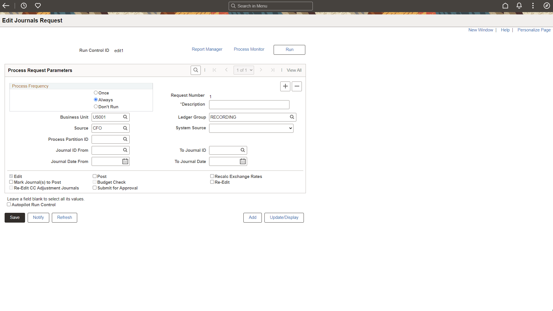

Edit Journals Request Page
Use the Edit Journals Request page (JOURNAL_EDIT_REQ) to edit journals and optionally post them.
Navigation:
General Ledger, and then Journals, and then Process Journals, and then Edit Journals, and then Edit Journals Request
This example illustrates the fields and controls on the Edit Journals Request page. You can find definitions for the fields and controls later on this page.
Field or Control Description
Edit
Select to edit the journals.
Post
Select to automatically post the journals that pass edit and budget checking (commitment control journals).
If a journal passes the edit and budget checking process, but needs to be approved, the system does not automatically post the journal when Submit for Approval is selected.
Re-Edit
Select to edit valid journals more than once. Edited journals are flagged as either having errors or as valid (edit complete). If you do not select this check box, the system ignores valid journals.
Re-Edit CC Adjustment Journals
This check box becomes available when you select the Re-Edit check box. Select the Re-Edit CC Adjustment Journals check box if you want to re-edit valid Commitment Control adjustment journals along with other journals. Leave the check box deselected to prevent the re-edit of these Commitment Control adjustment journals during re-edit processing.
Recalc Exchange Rates (recalculate exchange rates)
If your journals are recorded in multiple currencies, click to recalculate based on the most current exchange rate.
Mark Journal(s) to Post
Select to mark each valid journal with a posting request status. If PeopleSoft Workflow is activated, this option is not available.
Budget Check
Select to run the Commitment Control Budget Processor (FS_BP) process to check the journal against the control budget.
Submit for Approval
Select to have the system automatically submit journal entries for approval when they pass edit check from the Create/Update Journal Entries - Lines Page.
If this check box is selected along with the Edit, Post check boxes, and approval is required, the system does not post the journal. This process triggers approval for the journal.
If this check box is selected along with the Edit, Post check boxes, approval is not required for a journal, the journal is posted.
If this check box is not selected along with the Edit, Post check boxes, the system posts the journal independent of its approval status. This is to bypass approval for posting.
Autopilot Run Control
Select the check box to make the process available to the autopilot. When this check box is selected, the system issues a warning if the process frequency selected is other than Always. The Re-Edit option cannot be selected for an Autopilot run control.
Understanding Autopilot
See Configuring Journal Edit and Post Requests for Autopilot.
PeopleTools Documentation: PeopleSoft Process Scheduler, "Understanding PeopleSoft Process Scheduler"

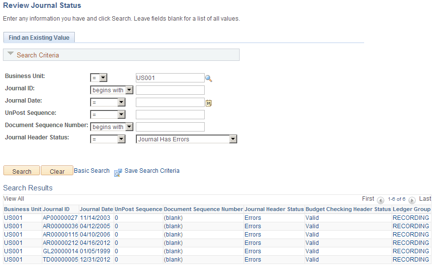

Review Journal Status - Find an Existing Value Page
Use the Review Journal Status - Find an Existing Value page (SEARCH) to search for journals with errors for a specific business unit.
Navigation:
General Ledger, and then Journals, and then Process Journals, and then Review Journal Status, and then Find an Existing Value
This example illustrates the fields and controls on the Review Journal Status - Find an Existing Value page. You can find definitions for the fields and controls later on this page.
Use the Review Journal Status - Find an Existing Value page to find journal entries with errors. When you enter your search criteria on the page, select Journal Has Errors in the Journal Header Status field to display a list of journal entries with errors.
If you track journals by document sequence number, you can enter that number on this page.
