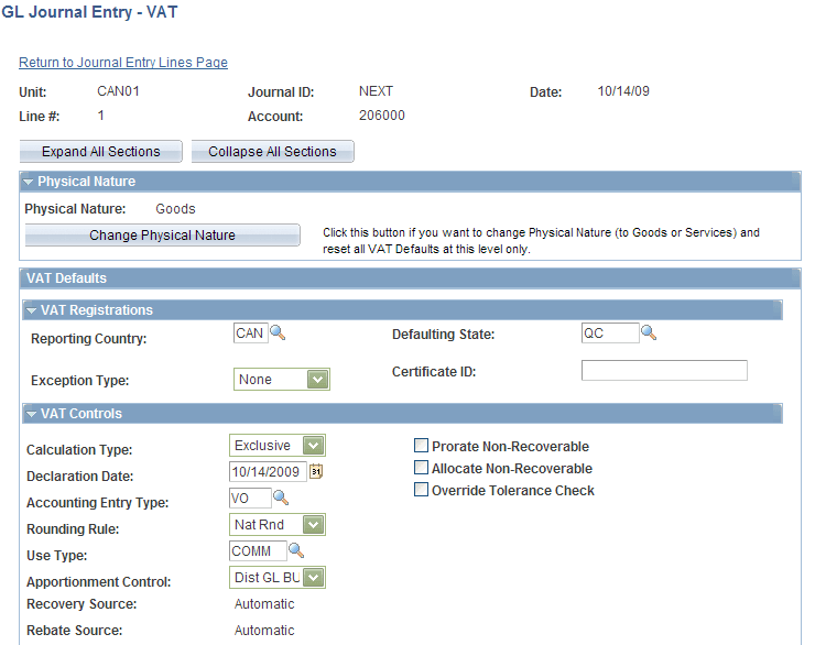

GL Journal Entry - VAT Page
Use the GL Journal Entry - VAT page (JOURNAL_ENTRY_VAT) to override VAT default information that is generated from the business unit, source, and account entered on the header and lines pages, if necessary.
Navigation:
Click the VAT link on the journal line.
The VAT link appears on a journal line for which the ChartField is a VAT ChartField and the business unit is VAT-enabled.
This example illustrates the fields and controls on the GL Journal Entry - VAT page (1 of 2). You can find definitions for the fields and controls later on this page.
This example illustrates the fields and controls on the GL Journal Entry - VAT page (2 of 2). You can find definitions for the fields and controls later on this page.
Expanding and Collapsing Sections
To manage your VAT data more efficiently, you can expand and collapse sections of this VAT page.
Field or Control Description
Expand All Sections
Click this button to scroll to and access every section on the page. You can also expand one or more sections by clicking the arrow next to the section name.
Collapse All Sections
Click to collapse all sections; you will see only the header information. If you expand one or more sections, you can click the arrow next to the section name to collapse the section.

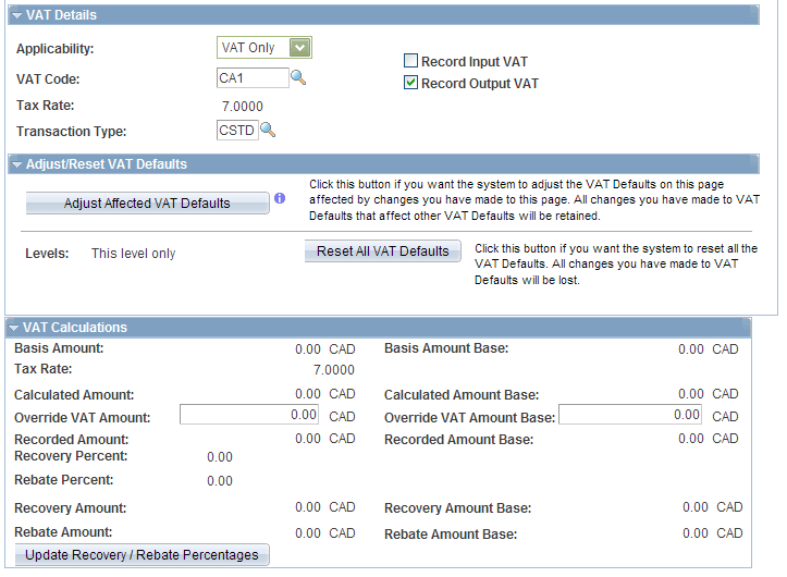

Updating VAT Values
You can modify any of the accessible fields on this page. These are the VAT default values that you defined in the VAT Default Setup page for Account ChartField , Journal Source, GL Business Unit, VAT Entity Registration, and VAT Country VAT Driver.
See PeopleSoft Global Options and Reports: Establishing VAT Defaults.
If you modify any of the VAT values on this page, be sure and use the options in the Adjust/Reset VAT Defaults group box.
VAT Defaults
Adjusting or resetting VAT defaults only affects the fields within this VAT Defaults group box:
  • Adjust Affected VAT Defaults
    If you changed any fields on this page, these changes may VAT defaults on this page. For accuracy and consistency, click this button if you want the system to adjust the VAT defaults that are affected by your changes. All changes you have made to VAT defaults on this page that affect other VAT defaults on this page are retained.
    Click the "i" button to list the fields that will be adjusted.
    Note: Always click the Adjust Affected VAT Defaults button after changing any defaults on the VAT page.
  • Levels
    The levels affected when you click the Reset All VAT Defaults button may be different, depending which application you are working with and the type of VAT page you are working on.
    Note: Reset completely redetermines the VAT defaults, but they are not necessarily reset to their original values. For example, the user may not have changed any VAT default values but if a VAT driver field was changed, then clicking Reset redetermines all defaults based on the new driver value.
    • All lower levels
      Do not select this option for general ledger VAT because it only has one level.
    • This and all lower levels
    • This level only
      Select this field value to reset all VAT defaults on this VAT page.
  • Reset All VAT Defaults
    Click this button if you want the system to reset the VAT defaults based on the Levels value you selected. All changes you made to VAT defaults will be lost.
