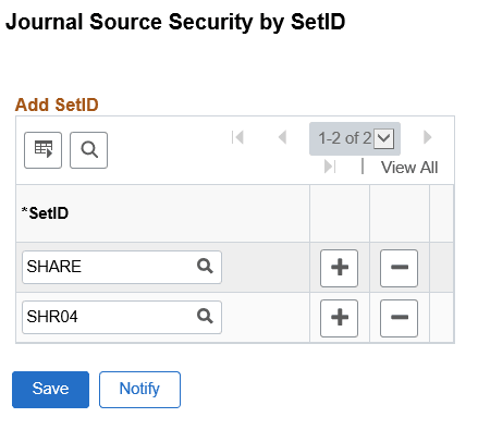

Journal Source Security by SetID Page
Use the Journal Source Security by SetID page (GL_JRNL_SRC_SETID) to add SetID for which the journal source security has to be applied. User cannot delete SetID for which the journal source security has been added based on the Business Unit.
Navigation:
Set Up Financials/Supply Chain , and then Security, and then Journal Source Security SetID
This example illustrates the fields and controls on the Journal Source Security by SetID page. You can find definitions for the fields and controls later on this page.
Field or Control Description
SetID
Click the prompt to select SetID for which the journal source security has to be applied.
Add icon
Click to add a new row for selecting SetID.
Delete icon
Click to delete a SetID from the list.
Save
Click to save the changes.

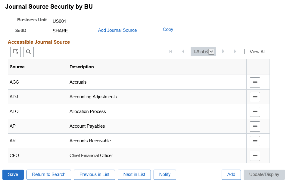

Journal Source Security by BU Page
Use the Journal Source Security by BU page (GL_JRNL_SRC_SEC_BU) to add Business Units for which the journal source security has to be applied. Prior to adding the BU, the SetID for the Business Unit has to be added in the Journal Source Security by SetID page. Once the journal source security is applied to the BU, you have to create at least one source in the Journal Source Security by User/Role page.
Only Business Units that have a SetID in the Record Group FS_11 with security enabled, will be available for selection.
Navigation:
Set Up Financials/Supply Chain , and then Security, and then Journal Source Security by BU
This example illustrates the fields and controls on the Journal Source Security by BU page.
Add Journal Source
Click to open the Add Journal Source modal window. Select required journal sources to be added to the Business Unit.
Copy
Click to open the Copy Business Unit modal window. Select Business Units to which the journal sources have to be copied.
Delete icon
Click to delete a source from the list. If the source deleted is the last one in the list, then the BU will also be deleted after getting confirmation from the user.
Add
Click to add BU for which the journal source security has to be applied.

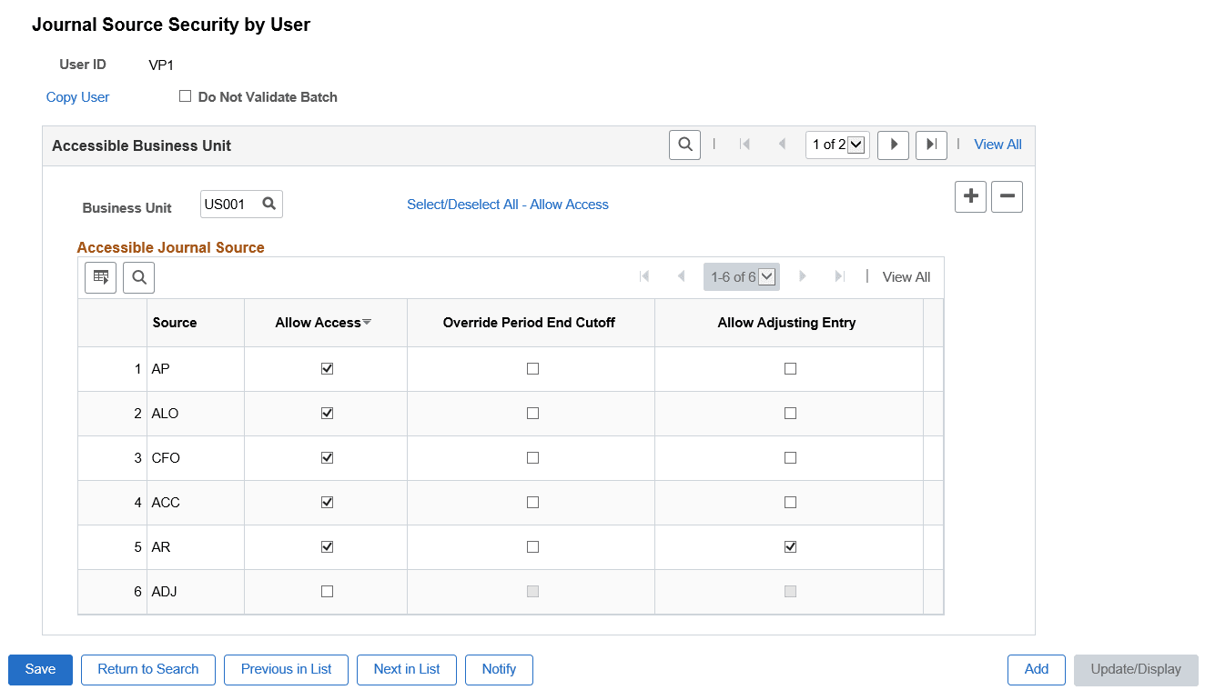

Journal Source Security by User Page
Use the Journal Source Security by User page (GL_JNL_SRC_SEC_USR) to select the business unit and journal source combination that the user can access.
Journal Source Security by User is only applicable for exceptions. The recommended set up is via Journal Source Security by Role.
Navigation:
Set Up Financials/Supply Chain , and then Security, and then Journal Source Security User
This example illustrates the fields and controls on the Journal Source Security by User page . You can find definitions for the fields and controls later on this page.
Copy User
Click to open the Copy User modal window. Select User IDs to which the security sources will be copied.
Do Not Validate Batch
Select this check box to prevent the system from validating the journals during any posting process initiated by the user. This is applicable only to batch posting process, and not online posting of journals.
Business Unit
Select the business unit for which the source security has to be applied.
Add a row to add another business unit.
Select/Deselect All - Allow Access
Click this link to select/deselect all sources populated for the BU for providing/denying access to the source security.
Allow Access
Select the Allow Access check box for the sources for which the user has access to. These sources are associated with the selected BU.
Override Period End Cutoff
Select this check box for required sources for which the user can post journal, even if the period end cutoff date has passed for the associated BU/source. The period end cutoff schedule is defined on the Period End Cutoff Definition page.
Allow Adjusting Entry
Select this check box for required sources to allow the user to select appropriate option for the Adjusting Entry field in the Create/Update Journal Entries - Header Page.
Add
Click to add a new user for enabling journal source security.

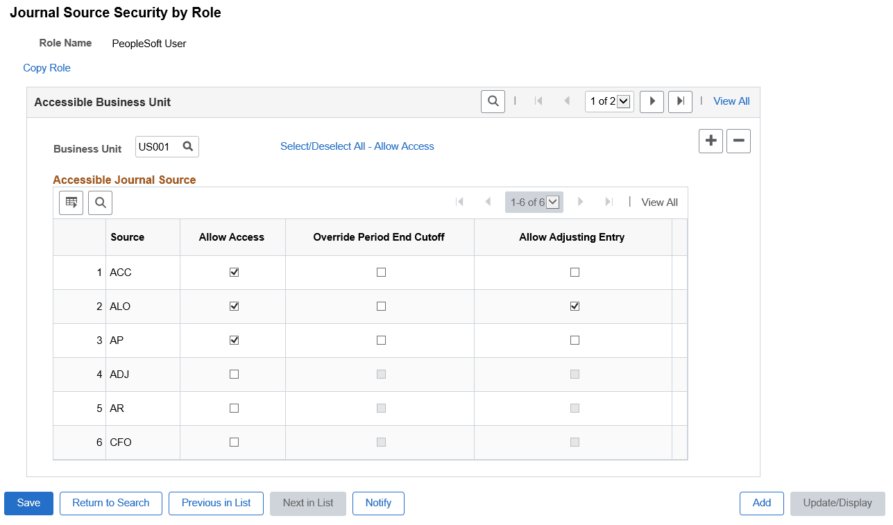

Journal Source Security by Role Page
Use the Journal Source Security by Role page (GL_JRNL_SRC_ROLE) to allow user to add specific roles for which the journal source access has to be provided for the Business Unit and Source. This is the recommended method for allowing access to Business Unit / Source combinations. After selecting the role, add the Business Unit for which the source security access has to be provided.
Navigation:
Set Up Financials/Supply Chain , and then Security, and then Journal Source Security Role
This example illustrates the fields and controls on the Journal Source Security by Role page. You can find definitions for the fields and controls later on this page.
Role Name
Displays the role name selected by the user for enabling journal source security.
Copy Role
Click to open the Copy Role modal window. Select role names to which the data has to be copied.
Allow Access
Select the Allow Access check box for the sources for which the Role has access to, for the associated BU.
Select this check box for required sources for which the Role will be allowed to post journals, although the period end cutoff time has passed for the associated BU/source. The period end cutoff schedule is defined on the Period End Cutoff Definition page.

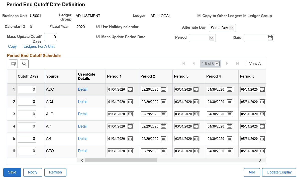

Period End Cutoff Definition Page
Use the Period End Cutoff Definition page (GL_JNL_SRC_PRD_END ) to define the period end cutoff schedule for particular business unit, ledger, and fiscal year.
Navigation:
Set Up Financials/Supply Chain , and then Common Definitions, and then Journals, and then Period-End Cutoff Schedule
This example illustrates the fields and controls on the Period End Cutoff Definition page. You can find definitions for the fields and controls later on this page.
Period End Cutoff Date Definition page
Journal sources are populated from the Journal Source Security BU page and associated with the business unit for which the cutoff schedule is defined.
Period end cutoff dates are calculated based on the calendar ID period end dates, value in the Cutoff Days, Use Holiday calendar, and Alternate Day fields.
Ledger
Displays the primary ledger for the defined ledger group.
Copy to Other Ledgers in Ledger Group
This check box is selected and grayed out when the Keep Ledgers in Sync check box is selected. This check box is deselected and enabled when the Keep Ledgers in Sync check box is deselected. You can choose to select this check box to copy the schedule to all ledgers in the group when the schedule is created. If this check box is not selected before creating the schedule you must manually copy to other ledgers in the group.
Select this check box to enable the alternate day to select, in case the period end date is a holiday.
Alternate Day
Select from the given options as alternate day for period end date. The period end date is recalculated based on the selected alternate day. This field is displayed only when the Use Holiday calendar check box is selected.
Mass Update Cutoff Days
Enter the number of days based that determines when all the cutoff days are to be mass updated, and the period end dates are to be recalculated.
Mass Update Period Date
Select this check box to update all the period end dates for a particular period, and for all the sources present in the cutoff schedule.
Period
Enter the period for mass update.
Date
Enter the date for mass update.
Copy
Select to access the Copy Period End Cutoff Schedule page modal window. Enter BU/Ledger Group/Ledger/Fiscal Year details for copying to.
Ledgers For A Unit
Select to access the Ledgers Groups for a Unit page modal window. Ledger details for the BU can be viewed/edited.
Cutoff Days
Enter cutoff days for the source, based on when the cutoff dates in the schedule for the source are to be calculated and populated.
Detail
Select to open the Source Details page modal window. This page displays all the users/roles that have access to the source for the associated business unit.
Period
You can manually change the period dates for all the given Periods associated with the sources. Manually modified dates are marked in red.
Add
Click to add the BU/Ledger Group/Fiscal Year for which the period end cutoff date is defined. Only ledger groups having 12 to 13 calendar periods can be added.

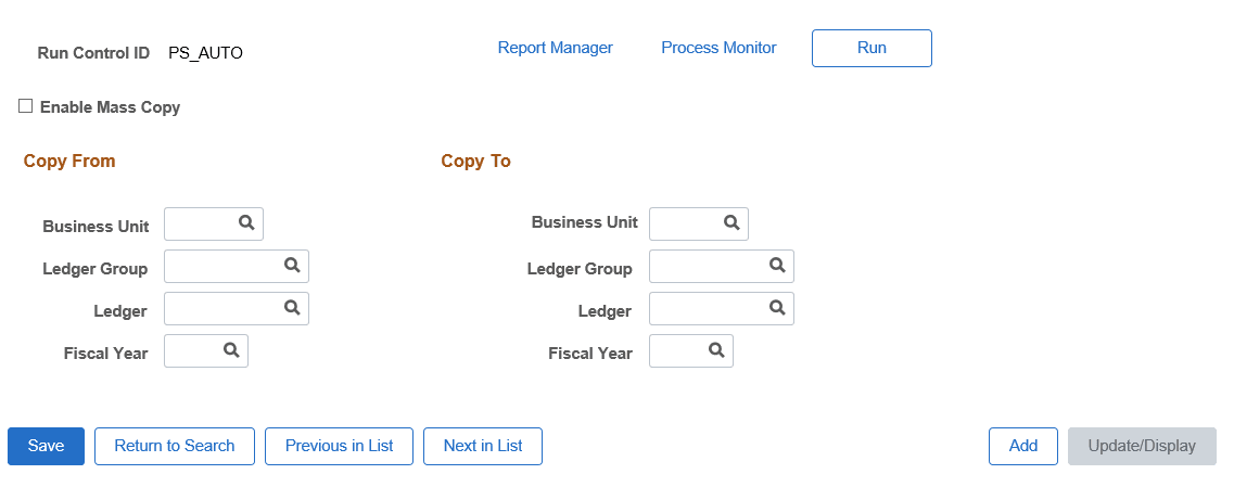

Copy PeriodEnd Cutoff Schedule Page
Use the Copy PeriodEnd Cutoff Schedule page (GL_JSRC_PRDCUT_COP) to copy period end cutoff schedule from one business unit, ledger group, ledger, fiscal year to another. You can also copy to a range of Business units, or a complete copy of all business units from one fiscal year to another.
Navigation:
Set Up Financials/Supply Chain , and then Common Definitions, and then Journals, and then Copy Period End Cutoff Sched
This example illustrates the fields and controls on the Copy PeriodEnd Cutoff Schedule page. You can find definitions for the fields and controls later on this page.
Enable Mass Copy
Select to copy based on these options:
  • By Business Unit Range - Copies the data from a BU/Ledger Group/Ledger/Fiscal Year to a specified Business Unit range.
  • All - Copies all schedules from one specified Fiscal Year to another.
If this check box is not selected, then the user can copy schedules from one BU/Ledger Group/Ledger/Fiscal Year to another.
A log file is generated which includes the details of the schedules that are copied.
