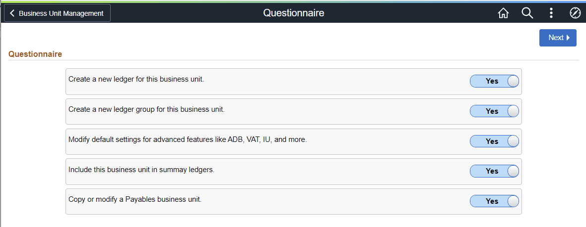

Questionnaire Page
GL_BU_QUES_FL
Answer the first set of questions that determine which steps are displayed in the activity guide.

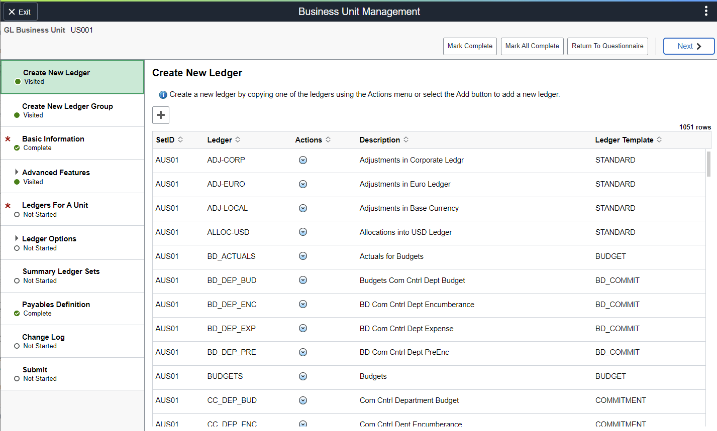

Create New Ledger Page
GL_BU_LED_S_FL
Add or copy a ledger for a new or existing General Ledger business unit.

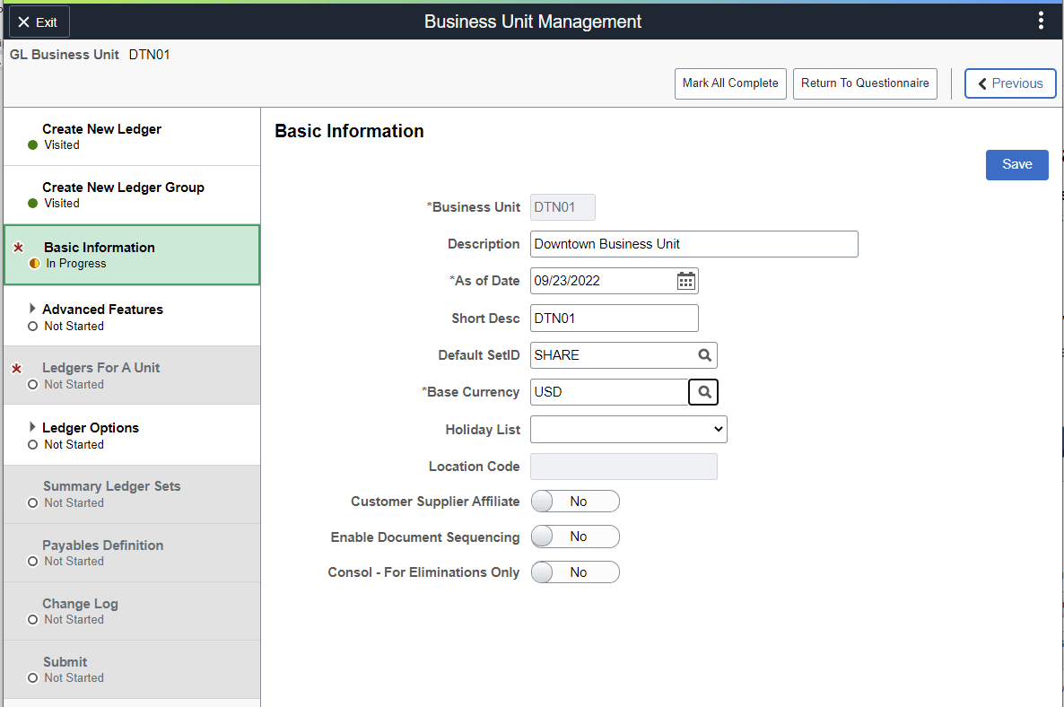

Basic Information
GL_BU_DEFN_FL
Configure basic information for the business unit such as description, default SetID, base currency, and so on.

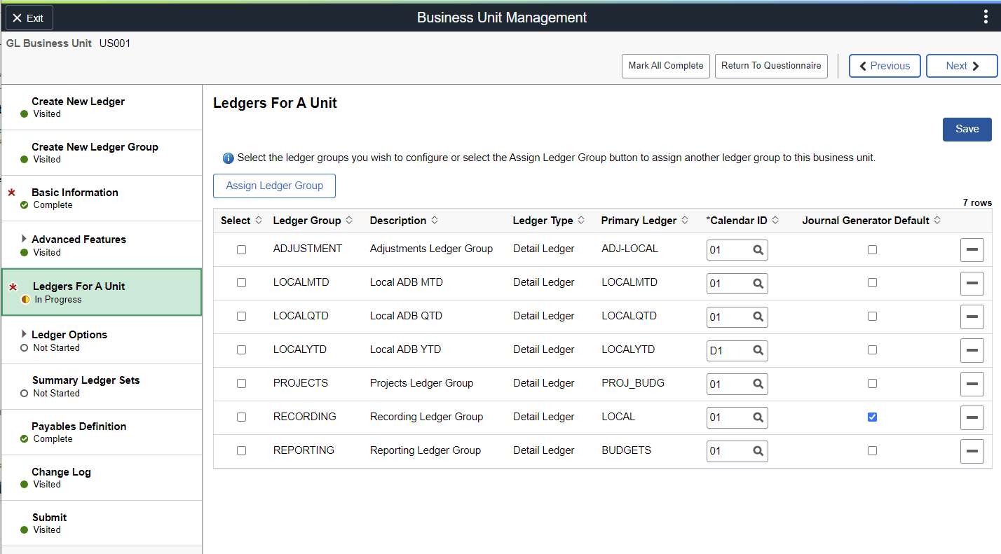

Ledgers For A Unit Page
GL_BU_LED_GRP_FL
View ledger groups assigned to a business unit, including the calendar ID and default journal generator for each ledger group

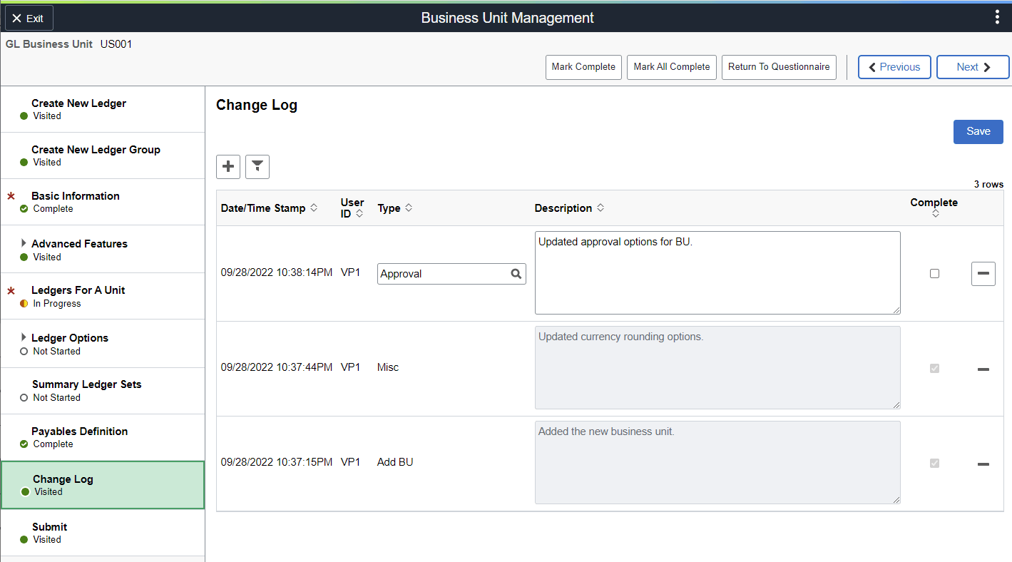

Change Log Page
GL_BU_CHG_LOG_FL
Optionally record an audit trail of changes made.

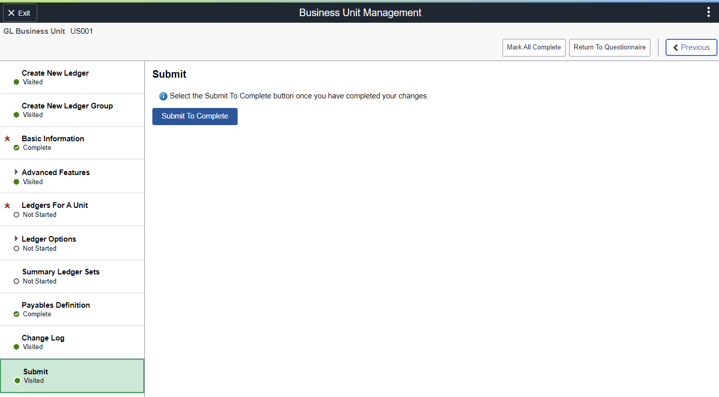

Submit Page
GL_BU_SMT_FL
Complete your changes to the business unit.

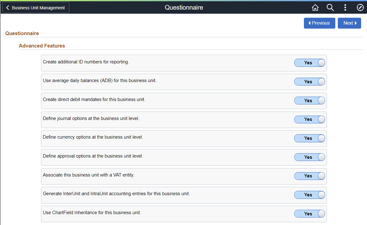

Questionnaire
When adding a new General Ledger business unit, the system prompts you through a series of questions. These questions are associated with one or more steps in the activity guide. How you answer these questions determines whether the system displays or hides associate steps in the activity guide. All answers are saved for the business unit and displayed as the default each time the activity guide questionnaire is accessed. All answers apply to all users.
While you are in the activity guide, you can access the questionnaire from the Return to Questionnaire button.
If you inactivate all steps associated with a question in the activity guide template, that question is no longer displayed. To inactivate steps, select PeopleTools, Portal, Activity Guide, Manage Template, and then select GL Business Unit template. In the configure Action Items, select the General Information tab and deselect the Active check box.
Do not inactivate the Basic Information and Ledgers for a Unit steps because they are required.

Create New Ledger
General Ledger > Ledgers > Detail Ledgers
Application Fundamentals: Detail Ledger Page

Ledgers for a Unit
Setup Financials/Supply Chain > Business Unit Related > General Ledger > Ledgers For A Unit
Application Fundamentals: Ledgers For A Unit - Definition Page

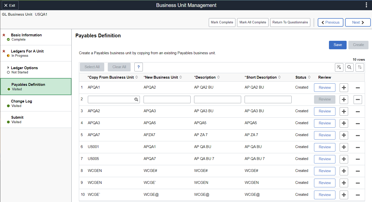

Payables
Set Up Financials/Supply Chain, and then Business Unit Related, and then Payables, and then Payables BU Definition
PeopleSoft Payables: Defining PeopleSoft Payables Business Units

Basic Information
none
none
The status is set to Complete when you save. This enables all dependent steps.

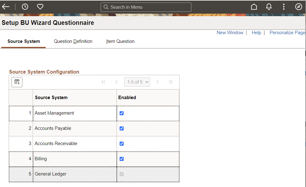

Source System Page
Use the Source System page (GL_BU_QS_SRC) to select which products, or sub-systems you wish to create when creating a new General Ledger business unit.
Navigation:
Set Up Financials/Supply Chain, and then Business Unit Related, and then General Ledger, and then Setup BU Wizard Questionnaire
This example illustrates the fields and controls on the Source System Page.
Source System
Select the source systems that appear on the Question Definition page. The related questionnaire pages for that source sub-system are loaded into the Business Unit Management activity guide.
Source systems that are available at this time are:

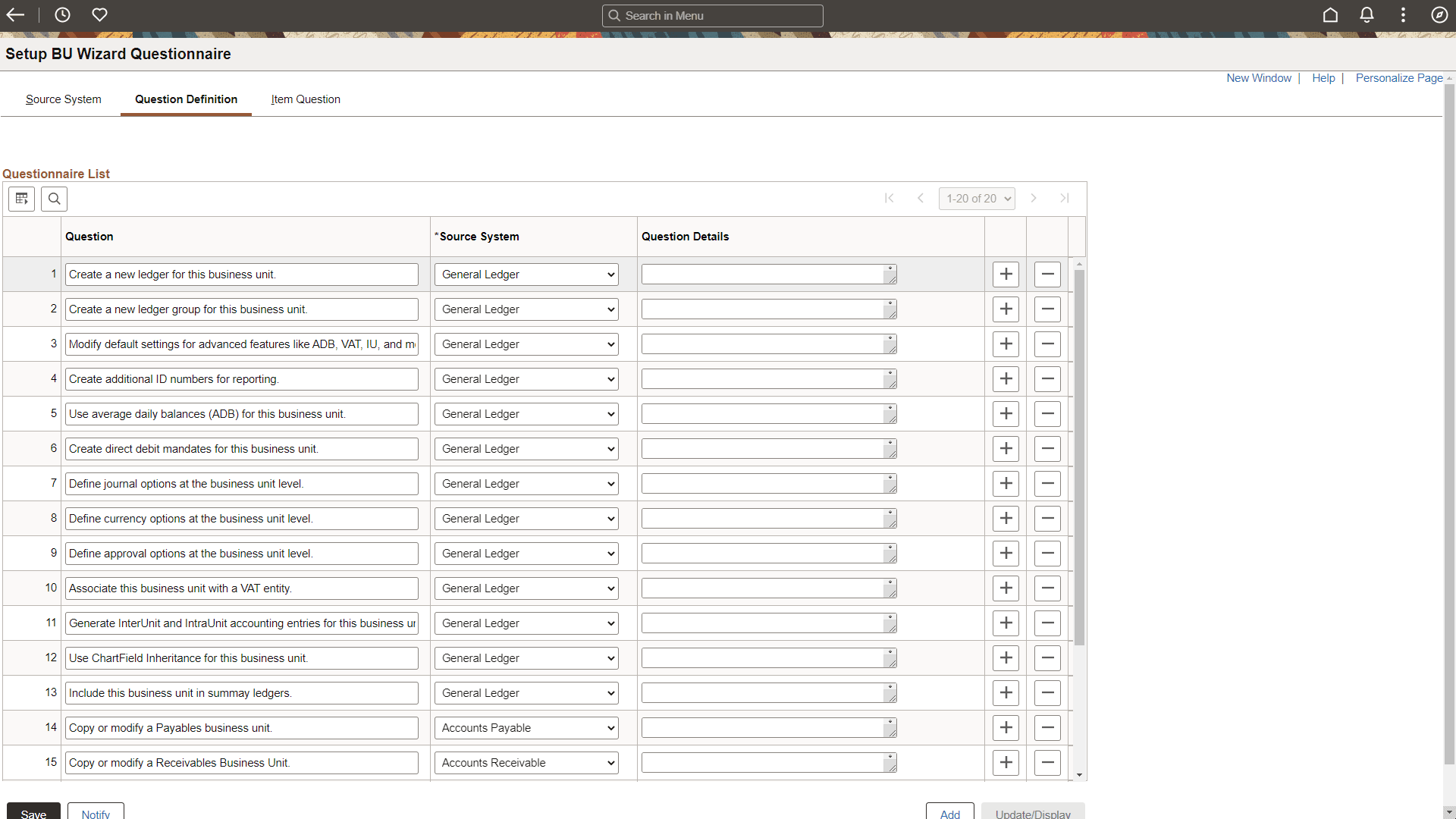

Question Definition Page
Use the Question Definition page (GL_BU_QS_DEFN) to define the business unit questions associated with the activity guide.
Navigation:
Set Up Financials/Supply Chain, and then Business Unit Related, and then General Ledger, and then Setup BU Wizard Questionnaire. Select the Question Definition tab.
This example illustrates the fields and controls on the Question Definition Page.
Question Definition
When creating new business units using the activity guide, these questions appear to the user. If the user responds "Yes" to the question, the system displays item questions, which are defined on the Item Question Page.
The questions are pre-delivered, but can be changed using the Question Definition Page. You can also add questions if needed.

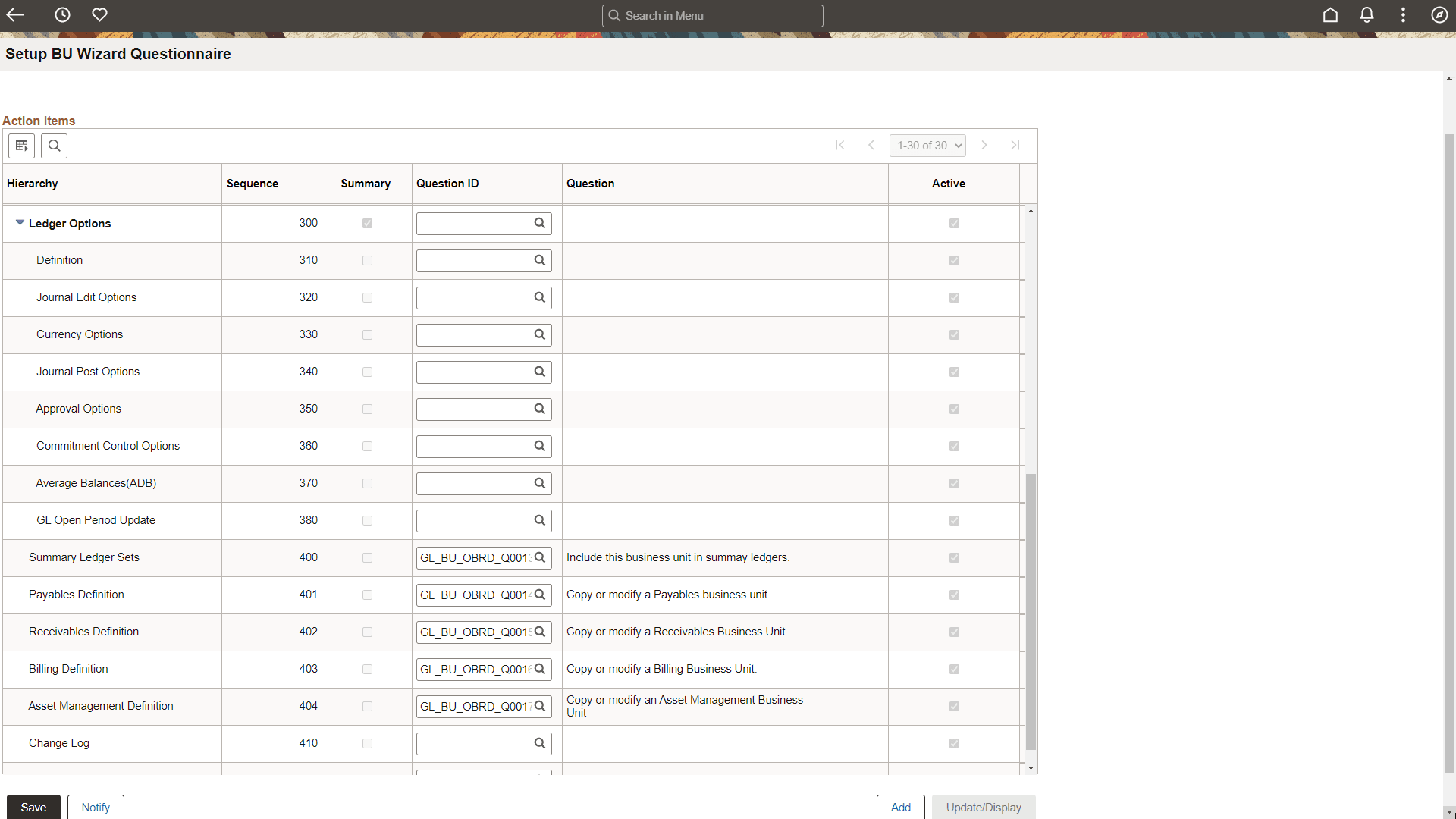

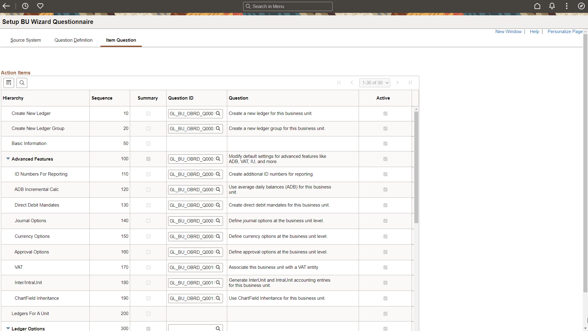

Item Question Page
Use the Item Question page (GL_BU_QS_ASGN) to assign a question ID for each non-required step and sub-step of the activity guide.
Navigation:
Set Up Financials/Supply Chain, and then Business Unit Related, and then General Ledger, and then Setup BU Wizard Questionnaire. Select the Item Question tab.
This example illustrates the fields and controls on the Item Question (1 of 3) page.
This example illustrates the fields and controls on the Item Question (2 of 3) page.
This example illustrates the fields and controls on the Item Question (3 of 3) page.
Field or Control Description
Question ID
Select a question ID, using the search prompt. When you select a Question ID, the question is displayed in the Question column for the row.

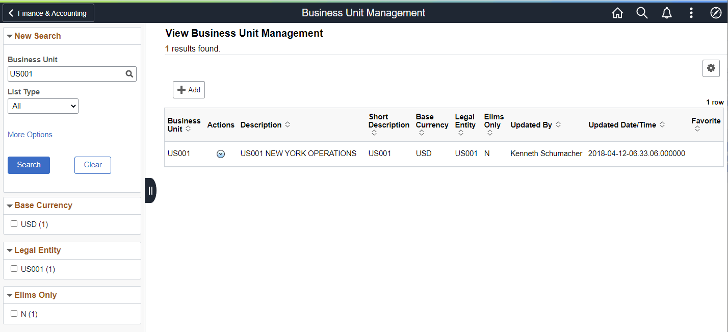

View Business Unit Management Page
Use the View Business Unit Management page (GL_BU_S_FL) to search, modify, add, and copy business units.
Navigation:
Select the Business Unit Management tile.
This example illustrates the fields and controls on the View Business Unit Management page.

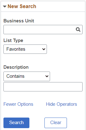

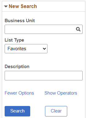

New Search
Use this section to search for an existing business unit.
Business Unit
Enter a business unit or click the Look up business unit option to access the Lookup window.
List Type
Click the drop-down list box to access these options:
  • All: Select to view all business units.
  • Favorites: Select to view your favorites, which are determined by clicking the Actions icon on the right side of the page, and selecting Add to Favorites.
  • Recent Updates: Select to view the last 10 business units updated.
More Options
Click the More Options link to display the Description field and these two links:
  • Fewer Options
  • Show Operators
Show Operators
Click the Show Operators link to display an operator field for the Description field. Operators are: Contains, Does Not Contain, Equal To, In List, Not Equal To, Not in List.
Search
Click this button to initiate your search.
Clear
Click this button to clear all search criteria.
This example illustrates the fields and controls when the New Search - More Options link is clicked.
This example illustrates the fields and controls when the New Search - Show Operators link is clicked.
Filter Options
Use the expandable filter options to expand or reduce the list of business units by facet, displayed on the right side of the page.
View Business Unit Management Options
Click on an individual row to update an existing business unit.
Add a new value
Click to access a page where you enter a new business unit. When you click the Add button, the system accesses the Questionnaire Page.
More Options icon(Options Menu)
Click the Options Menu button to access additional options to save your search criteria. Options are:
  • Export Filtered Data
  • Threshold Options
  • Save: Select to indicate that you want this criteria as your default search criteria.
  • Save As: Select to indicate that you want to name this criteria so that it can be selected for future searches.
  • Add to Homepage
Actions buttonActions
Click the Actions button for and existing business unit to access these options:
  • Copy: Select to create a new business from the business unit selected.
    The system takes you to the Questionnaire page. Activity guide field values are copied from the source business unit.
  • Add to Favorites: This option is only available for business units that have not been previously identified as a favorite for the user.
  • Remove from Favorites: this option is only available for business units that were previously identified as a favorite for the user.
Questionnaire Page
Use the Questionnaire page (GL_BU_QUES_FL) to answer the first set of questions that determine which steps are displayed in the activity guide.
Navigation:
Select the Business Unit Management tile. From the View Business Unit Management page, select the Add button. Enter a business unit code and select the Add button.
The appearance of this page depends on the options selected on the Source System Page, the Question Definition Page, and the Item Question Page.
This example illustrates the fields and controls on the Questionnaire page.
Questionnaire
The questions that appear on this page are configured on the Question Definition Page.
Yes or No
Select an option that determines the questions on the Questionnaire: Advanced Features Page as well as the tasks on the activity guide.
  • Select Yes to perform the setup task for the new business unit(s).
  • Select No to bypass the setup task for the new business unit(s).
Next
Select to access the Questionnaire: Advanced Features Page.
Use the Questionnaire: Advances Features page (GL_BU_QUES_SEC_FL) to answer questions that determine which sub-steps are displayed in the Advanced Features step of the activity guide.
Navigation:
Select the Business Unit Management tile. From the View Business Unit Management page, select the Add button. Enter a business unit code and select the Add button. Answer yes to the third question on the Questionnaire page and select the Next button.
This example illustrates the fields and controls on the Questionnaire: Advanced Features page.
The questions that appear on this page are configured on the Item Question Page.
After answering all questions, select the Next button to access the activity guide.

Use the Basic Information page (GL_BU_DEFN_FL) to configure basic information for the business unit such as description, default SetID, base currency, and so on.
Navigation
Select the Business Unit Management tile. From the View Business Unit Management page, select the Add button. Enter a business unit code and select the Add button. Answer all questions on the Questionnaire and the Questionnaire: Advanced Features pages and select the Next button.
This example illustrates the fields and controls on the Basic Information page.
Basic Information
See the fields and controls on the General Ledger Definition - Definition Page.
Use the Create New Ledger page (GL_BU_LED_S_FL) to add or copy a ledger for a new or existing General Ledger business unit:
Navigation:
This example illustrates the fields and controls on the Create New Ledger page.
Create New Ledger
The activity guide is displayed on the left side of the page. When you make a selection in the activity guide, the page selected is displayed on the right side of the page.
The pages in the activity guide relate to existing pages. The table in the Understanding How to Manage Business Units, Activity Guide section above provides the PeopleSoft Classic navigation for each option listed in the activity guide.
Add a New Value button(Add a New Value)
Click the Add a New Value button to access the Ledger Definition page.
Use the Ledgers For A Unit page (GL_BU_LED_GRP_FL) to view ledger groups assigned to a business unit, including calendar ID and default journal generator for each ledger group.
Navigation
From the Business Unit Management activity guide, select Ledgers For A Unit.
This example illustrates the fields and controls on the Ledgers For A Unit page.
Ledgers For A Unit
Select one or more ledger groups to assign to the business unit.
If you do not assign a ledger group to a business unit, the steps that depend on this step are inactive.
Save
Select after selecting one or more ledger groups to activate dependent steps.
Assign Ledger Group
Select this button to assign a new ledger group to the business unit.
When copying from an existing business unit, select this button to select from a list of existing ledger groups that exist for the source business unit.
Select
Select one or more ledger groups to configure for the business unit. These ledger groups are configured in the Ledger Options steps.
Calendar
Select the calendar associated with the ledger group.
Journal Generator Default
Select only one ledger group in the list. The ledger group selected as the default is used when subsystem accounting entries do not contain a ledger group.
Sub-ledger Definition Page
Use the <Sub-ledger> Definition page (this value varies by sub-ledger) to create a sub-ledger business unit that is associated with the selected General Ledger business unit.
Navigation
From the Business Unit Management activity guide, select the <Sub-ledger> Definition option on the left side of the page.
This example illustrates the fields and controls on the Sub-ledger Definition page.
Business Unit Management: Sub-ledger Definition
The <sub-ledger> Definition page allows you to create a new sub-ledger business unit by copying from an existing sub-ledger business unit. The new sub-ledger business unit is not created until you select the Create button. When the Create button is selected, the Review button is available to proceed to the sub-ledger Questionnaire page. The system then proceeds to the sub-ledger configuration pages.
See the links provided in the Source System Page section to access documentation about business unit definition pages for each source system.
Save
Select to save changes. This allows you to return to this page at a later time while not loosing your changes.
Business units are not created until you select the Create button.
Create
Select to create all selected business units.
Note: When you select the Create button the system creates the Table Set Control values from the sub-ledger source business unit. Oracle's PeopleSoft recommends that you verify these values after the sub-ledger business unit is created.
Review
Select to access the Questionnaire page for the sub-ledger business unit. From this Questionnaire page you can access the business unit configuration pages.
(delete row)
Select to delete a row prior to selecting the Create button.
This button is disabled after selecting the Create button and creating the business unit.
Change Log Page
Use the Change Log page (GL_BU_CHG_LOG_FL) to optionally record an audit trail of changes made.
Navigation:
From the Business Unit Management activity guide, select the Change Log option on the left side of the page.
This example illustrates the fields and controls on the Change Log Page.
Change Log
Type
Enter or select the type of change. The system retains values entered in this field for future selection.
Complete
Select this check box and Save to indicate that the row is complete and cannot be edited.
When this check box is not selected, the row can be edited and deleted.

Use the Submit page (GL_BU_SMT_FL) to complete your changes to the business unit.
Navigation:
From the Business Unit Management activity guide, select the Submit option on the left side of the page.
This example illustrates the fields and controls on the Submit Page.
Submit
Submit to Complete
Click this button to indicate that you have completed your changes. The system resets the activity guide so it can be used for future changes.
Although clicking this button is not required for your changes to take effect, it is highly recommended that you do so after you have completed your changes.
Note: When you click this button and then re-access the business unit, the system takes you to the Question Definition Page so you can determine which steps are displayed for the changes you intend to make.
