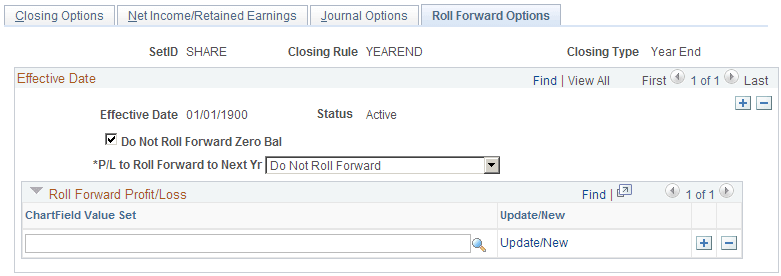

Closing Rules - Roll-Forward Options Page
CLOSE_DEFN3
For year end close only, identify whether to roll forward accounts with zero balances. Also, indicate whether to roll forward none, some, or all of the profit and loss accounts. (Normally only balance sheet accounts are rolled forward.)

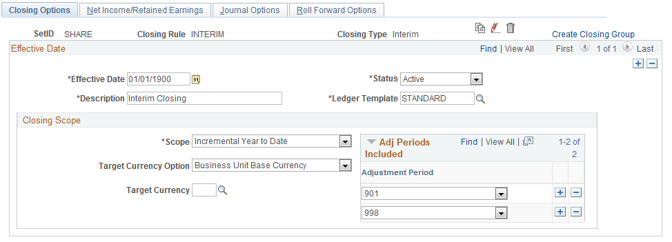

Scope
For interim closings only, enter the scope of the interim close. Values are:
Incremental Current Period: Includes current period balance (from period start date to the end of period date).
Incremental Year to Date: Used for daily close, includes transactions that you have posted since the last closing process, up to the as of date entered on the Close Request page. The closing process marks the journals that it processes as Closed, and the journals are not processed in future runs.
Incremental Year to Curr Period (incremental year to current period): Includes transactions starting with period 1 (that is, period 1 through the end of the current period).
Target Currency Option
For interim closings, identify which base currency is used for the closing journal entries and offsets. Values are:
Base currency of Prim Ledger (base currency of primary ledger): Uses the base currency of the primary ledger in the ledger group (as entered on the Detail Ledger Group page). The ledger group is automatically entered on the Close Request page.
Business Unit Base Currency: Uses the base currency of the business unit.
Retain currency: Uses the source transactions' currency.
Specify Target Currency: Uses the currency that you specify in the Target Currency field.
To retain the offset entry in the original currency, select the Currency Code ChartField on the Journal Options page, and select Retain Value.
Target Currency
If you select Specify Target Currency in the Target Currency Option field, enter the currency for the system-generated closing journals. Be sure that it is a base currency for one of the ledgers in the ledger group that you select on the Close Request page.
Be careful when you enter a target currency. Because you have not yet identified the ledger group that is processed for the closing, the system cannot validate that the currency is valid for the ledger group.
Adj Periods Included (adjustment periods included)
Select the adjustment period that the system closes in the interim closing. Click the Add button to close additional adjustment periods. (Adjustment periods are defined on the Defining Detail Calendars page.)

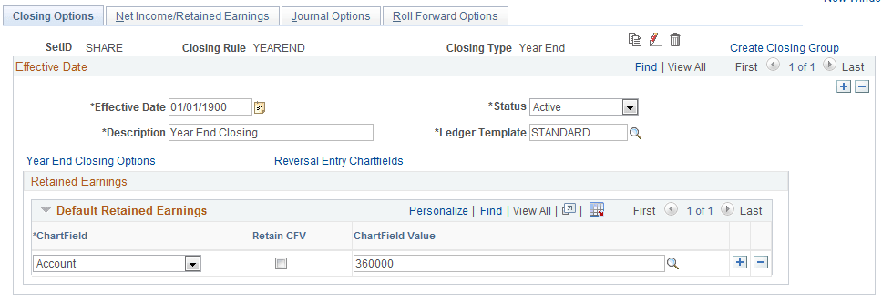

Year End Closing Options
Click to access the year end close options. The link is available only for year end closings.
Click the Year End Closing Options link.
Year End Close Options Page
Year End Close Options page

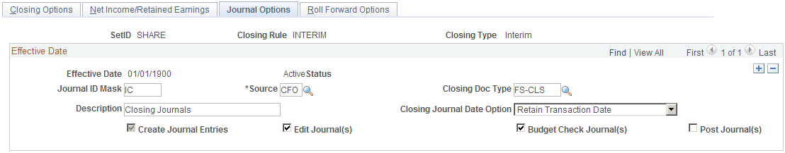

Closing Rules - Journal Options Page
Use the Closing Rules - Journal Options page (CLOSE_JOURNAL) to define journal options for system-generated journals created during the close.
Also, specify whether to create journal entries for year end close.
Navigation:
General Ledger, Close Ledgers, Closing Rules, Journal Options
This example illustrates the fields and controls on the Journal Options page. You can find definitions for the fields and controls later on this page.
Field or Control Description
Journal ID Mask
Enter a prefix for naming closing journals. Journals are identified by a 10-character alphanumeric ID. The system automatically appends the prefix that you specify here to the journal IDs. For example, if you specify the journal ID mask as YEC, the year end closing journal IDs might be YEC0001, YEC0002, and so on.
Alternatively, the value NEXT causes the system to assign the next available journal ID number automatically, without including the mask. (This option makes it more difficult to identify the closing journals.)
Reserve a unique mask value for closing to ensure that no other process creates identical journal IDs.
Source
Enter a code to identify the origin of the journal entries that are created.
Closing Doc Type (closing document type)
If you use the Document Sequencing feature, select a predefined closing document type for the closing journals. The Document Sequencing feature requires that you identify a document type for all created journal entries.
Description
Enter a description of the journals that are created (for example, Daily Close Journals).
Closing Journal Date Option
Values are:
Retain Transaction Date: Sets the output journal date to equal the original transaction date.
Use Process Date: Sets the output journal date to equal the process date of the closing process run.
Create Journal Entries
Select to create journal entries for year end close transactions only. Interim close always creates journal entries.
Note: When the Application Engine process (GL_YC) is used to close ledgers, this option is ignored, regardless of your selection.
The following three fields are for interim close only (because year end close directly updates the ledgers and interim close does not). If you select these fields, the system processes the journals without any intervention by you. If you want to edit and post the journals through journal processing, do not select the fields.
Edit Journal(s)
For interim close only, select to have the journals automatically undergo the edit process.
If you do not select this option, the closing process designates the journals as No Status - Needs to be Edited.
Budget Check Journal(s)
For interim closings only, select to have the journals automatically checked against the Commitment Control budget for the business unit and account.
To select this option, you must have the Commitment Control feature enabled for the ledger group, and you must have selected the Edit Journal(s) option.
Post Journal(s)
For interim closing only, select to have the journals automatically posted to the ledger.
To select this option, you must have selected the Edit Journal(s) option and the Budget Check Journal(s) option if the Commitment Control feature is enabled for the ledger.
Use the Roll Forward Options page (CLOSE_DEFN3) for year end close only, to identify whether to roll forward accounts with zero balances.
Navigation:
General Ledger, and then Close Ledgers, and then Closing Rules, and then Roll Forward Options
This example illustrates the fields and controls on the Roll Forward Options page . You can find definitions for the fields and controls later on this page.
Closing Rules - Roll Forward Options page
These fields appear for year end closings only. They are not available for interim closings.
Do Not Roll Forward Zero Bal (do not roll forward zero balances)
Select to prevent the system from creating balance-forward amounts (period 0) for accounts with a zero-ending balance.
If you run the (GL_YC) Application Engine process to close ledgers with this option deselected, and then rerunning the (GL_YC) Application Engine process close process with this option selected, the system does not remove the zero balances in Period 0 from the ledger table.
Note: As of Update Image 55, this option applies to the Application Engine process (GL_YC).
P/L to Roll Forward to Next Yr (profit and loss to roll forward to next year)
Normally, only balance sheet accounts are rolled forward, and their balance forward amounts stored in period 0. Options are:
  • Do Not Roll Forward: Do not roll forward any amounts from prior year accounts with the Balance Forward field on the Account Type page set to the value Not Carry Forward.
  • Partial RollForward 1 Year: For selected ChartField Value Sets, closing rolls forward the amounts from the first period through 998 of the year being closed to period 0 of the new year.
  • Partial RollForward Cumulative: For selected ChartField Value Sets, closing rolls forward amounts from periods 0, and periods 1 through 998 of the year being closed to period 0 of the new year.
  • Roll Forward All 1 Year: Closing rolls forward all account with the Balance Forward field equal to Not Carry Forward balances from period 1 through 998 for the year being closed to period 0 of the new year.
  • Roll Forward All Cumulative: Closing rolls forward all accounts with the Balance Forward field equal to Not Carry Forward balances for period 0, and 1 through 998 for the year being closed to period 0 of the new year.
Roll Forward Profit/Loss
If you elect to roll forward in the P/L to Roll Forward to Next Yr field, select the ChartField value set for the P/L accounts that you want to roll forward. To roll forward more than one ChartField value set, click the Add button and select additional ChartField value sets.
Update/New
Click to access the Setup ChartField Value Sets page, where you can create or update a ChartField value set to use as the roll-forward P/L ChartField value set.
