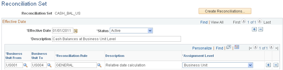

Reconciliation Set Page
Use the Reconciliation Set page (GLRN_RECON_SET) to define the parameters for creating one or several account reconciliations.
Navigation:
General Ledger, and then Perform Reconciliation, and then Define Reconciliation Set
This example illustrates the fields and controls on the Reconciliation Set page. You can find definitions for the fields and controls later on this page.
The Reconciliation Set page
Scroll Area
Field or Control Description
Effective Date
Select a date from which the Reconciliation Set is effective, making sure that the date is inclusive of the effective date of the Reconciliation Rules that you want to process.
Business Unit From and Business Unit To
Select the desired business unit range for which to create the reconciliation.
Reconciliation Rule
Select the desired Reconciliation Rule to create reconciliation for the set.
Assignment Level
Select the desired assignment level from the options to create reconciliation. The available options are those that are enabled on the Define Assignment Levels Page.
Create Reconciliations

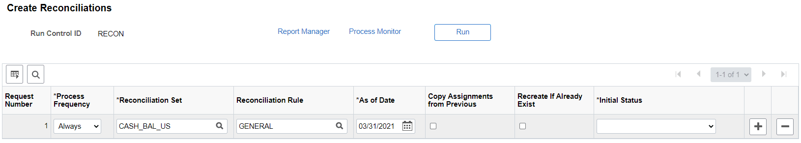

Create Reconciliations Page
Use the Create Reconciliations page (GLRN_CREATEUOW_REQ) to run the process that creates each reconciliation as defined in the specified Reconciliation Sets.

This example illustrates the fields and controls on the Create Reconciliations page.
As of Date
Select the date for the system to use in calculating account balances for the selected reconciliation set. The appropriate fiscal year and accounting periods are determined based on the calendar for the Business Unit, Reconciliation Rule and Ledger being processed.
Reconciliation Set
Select the reconciliation set for which you want to create reconciliations. Leave this field blank to select all sets. Insert a row for multiple sets.
Reconciliation Rule
Select a reconciliation rule for which you want to create reconciliations. Leave this field blank to select all rules for the Reconciliation Set. Insert a row for multiple rules. Only the rules for the selected Reconciliation Set are displayed.
Copy Assignments from Previous
Select this check box to copy the assignments from a previous As of Date that was processed for this reconciliation set. Assignments can also be updated using the Reconciliation Assignment Page.
Previous Recon As Of Date
This field appears if you selected the Copy Assignments from Previous check box. Specify the As of Date of the previous reconciliation so that the system processes the assignments from the correct data set.
Recreate If Already Exist
Select this option to delete and recreate existing reconciliations if the same request has been processed before. If one or more reconciliation rows have statuses that do not allow recreation (for example, already In Progress), then the process will stop to prevent the system from accidentally overriding reconciliation works.
Initial Status
Select the status that you want to assign initially to the reconciliations created. The process will populate the new reconciliation rows with this status that you select. Only the statuses that are enabled to Allow Recreate (from the Reconciliation Statuses and Reasons page) can be selected here. See Reconciliation Statuses and Reasons Page.
