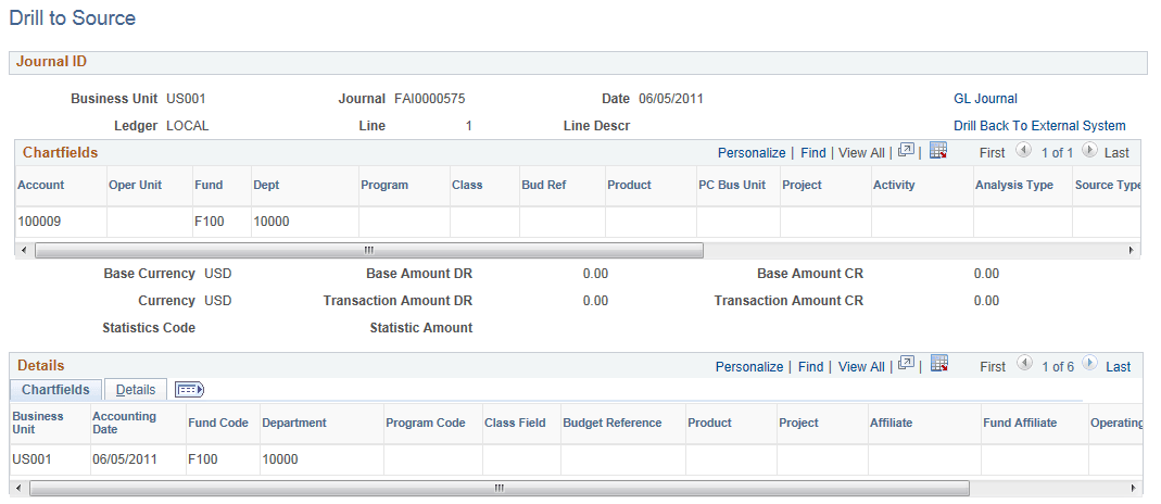

Drill to Source Page
Use the Drill to Source page (FAI_GL_DRILL) to drill back to the to external system journal lines from GL journal line directly.
Navigation:
General Ledger, and then External System Integration, and then Review Journal Details
This example illustrates the fields and controls on the Drill to Source page.
While drilling back from a PeopleSoft journal line to the Fusion Accounting Hub detailed lines, you may retrieve multiple, but around the first 50 Fusion Accounting Hub lines for each PeopleSoft line.
To enable this drillback capability, see Specifying the Drilldown URL.

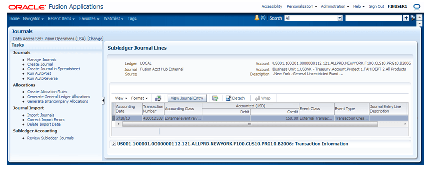

Subledger Journal Lines Page (Fusion Accounting Hub)
Use the Subledger Journal Lines page to view accounting transactions in the Fusion Accounting Hub application.
Navigation:
Select the Drill to Source icon from the Accounting Line Results group box of the External Accounting Integration Workbench.
This example illustrates the fields and controls on the Drill Back page. You can find definitions for the fields and controls later on this page.
Drill Back page
You can view a summarized journal line in PeopleSoft, and drill directly to the Fusion Accounting Hub journal line Inquiry page to see all the original lines with any additional detail captured there.

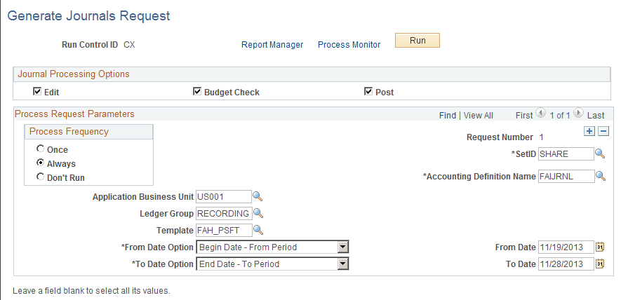

Generate Journals Request Page
Use the Generate Journals Request page to apply the Accounting Entry Definition and Journal Generator Template to Fusion Accounting Hub entries and create PeopleSoft General Ledger journals.
Navigation:
General Ledger, and then Journals, and then Subsystem JournalsGenerate Journals
This example illustrates the fields and controls on the Generate Journals Request Page. You can find definitions for the fields and controls later on this page.
Although you can configure the request to run at regular intervals, you may find it beneficial to review the transferred Fusion Accounting Entries prior to generating the PeopleSoft General Ledger journals.

SetID
Enter the SetID for which the delivered Accounting Definition Name, FAIJRNL, is defined. If the SetID value is not SHARE in this case, you will be unable to select the correct Accounting Definition Name since that is the SetID for the delivered value.
For the Fusion Accounting Hub integration, select “FAIJRNL” (the delivered accounting entry definition).
Application Business Unit
Select an application business unit that the system will use to derive the prompt values for selection. Journal Generator uses the system source from the Accounting Entry Template to derive the prompt table for the application business unit defined for the request.
Ledger Group
Select the ledger group that includes the ledgers that you would like to process. You can leave this field blank to process all ledger groups.
Template
Journal Generator creates journal entries for the specified journal generator template. The SetID of the prompt values is derived from the SetID entered earlier on the page. For the Fusion Accounting Hub integration, select the delivered Journal Generator Template, FAH_PSFT.
From Date Option
Select a value to further define which accounting entries that the Journal Generator extracts with this request. Journal Generator compares these dates to the accounting dates associated with each accounting entry. Select from the following values:
  • Specify Date: Uses the date specified to identify the period.
  • Current Date: Uses the date on which Journal Generator is run.
  • Begin Date - From Period: Uses the beginning date of the From Period in the ledger.
  • Begin Date - To Period: Uses the beginning date of the To Period in the ledger.
  • No From Date: Uses all open dates of the ledger before the chosen to date. This means that the system processes all dates up to the date in the To Date field.
Process Date: Date specified on the business unit journal process date option. It can be a specified date defined on the business unit, or it can be the current date.
From Date
Enter a begin date in this field if you selected the Specify Date option.
To Date Option
Select a value to further define which accounting entries Journal Generator extracts with this request. Journal Generator compares these dates to the accounting dates associated with each accounting entry. Select from the following values:
  • End Date - From Period: Uses the ending date of the From Period in the ledger.
  • End Date - To Period: Uses the ending date of the To Period in the ledger.
To Date
Enter an end-of-range date in this field if you selected the Specify Date option.
