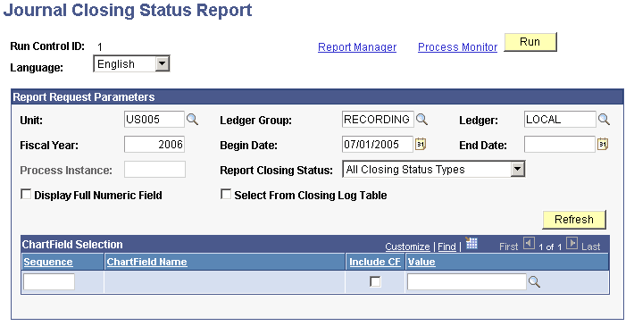

Journal Closing Status Report Page
RUN_GLS1004
Specify the run parameters for the Journal Closing Status report.
Use the Journal Closing Status Report page (RUN_GLS1004) to specify the run parameters for the Journal Closing Status report.
Navigation:
General Ledger, and then Close Ledgers, and then Journal Closing Status Report
This example illustrates the fields and controls on the Journal Closing Status Report. You can find definitions for the fields and controls later on this page.
This page is discussed in detail because it involves more parameters than the system usually requires for generating reports.
Field or Control Description
Display Full Numeric Field
Select to display the full numeric value if it is larger than the report column size. The number wraps to a second line.
Select From Closing Log Table
Select to have the scope of the report defined by the process instance stored in the closing log table. The Process Instance field becomes available.
Process Instance
Enter the process instance number of the Close process run.
Report Closing Status
Select one of the following to:
All Closing Status Types: Include all journals, regardless of their closing status.
All Except Not Processed: Include only journals that the close process has processed.
Closed Journals: Include only journals that the close process has closed.
Not Processed: Include only journals that the close process did not process.
Unclosed Journals: Include only journals that the close process processed but did not close.
