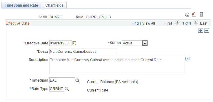

Translation Rules - TimeSpan and Rate Page
Use the TimeSpan and Rate page (TRANS_RULE_TIME_RT) to define TimeSpans and rates for a translation rule.
Navigation:
General Ledger, and then Process Multi-Currency, and then Define and Process, and then Define Translation Rules, and then TimeSpan and Rate
This example illustrates the fields and controls on the Translation Rule - TimeSpan and Rate page.
Translation Rules - TimeSpan and Rate page
Field or Control Description
TimeSpan
General Ledger generates journal entries for amounts that represent the period of time indicated by the TimeSpan for the translation rules being processed. The TimeSpan commonly used is ITD (inception-to-date profit and loss accounts) or BAL (balance sheet accounts). Using these TimeSpans, the system sums the account balances in periods 1 through n for profit and loss accounts and in periods 0 through n for balance sheet accounts.
Rate Type
Select the applicable exchange rate type.

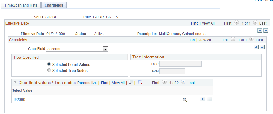

Translation Rules - Chartfields Page
Use the Chartfields page (TRANS_RULE_CF) to specify the ChartFields for the translation rule.
Navigation:
General Ledger, and then Process Multi-Currency, and then Define and Process, and then Define Translation Rules, and then Chartfields
This example illustrates the fields and controls on the Translation Rule - Chartfields page.
Translation Rules - Chartfields page
ChartField
Select the ChartField to be translated using the TimeSpan and rate type specified. For example, assets and liabilities are typically translated as balances (BAL) at the current exchange rate (CRRNT), while retained earnings are translated at a historical exchange rate (HSTRE).
How Specified
Select the Selected Detail Values option to list asset accounts individually or, more likely, select the Selected Tree Nodes option to activate the Tree Information fields, where you can specify a tree from which to select nodes.
Tree Information
Enter each tree node in the Tree field. The Level field is optional. If the tree has levels, you can limit prompting to selected levels. Using trees establishes rollups for the account values so that you can select particular types of accounts according to the structure of your business unit. It is best to use trees whenever possible, which reduces future maintenance when your ChartField values change.
