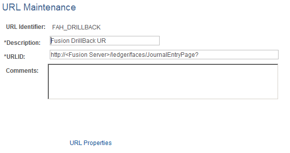

This example illustrates the fields and controls on the URL Maintenance page. You can find definitions for the fields and controls later on this page.
The URLID provides a link from PeopleSoft General Ledger to Fusion Accounting Hub. The value to be used varies based upon your implementation of Fusion Accounting Hub.
The URL Identifier, FAH_DRILLBACK, is selected on the External System Setup page.
Hypertext Transfer Protocol Fusion Ledger Uniform Resource Locator (URL) Location Location
This is determined by the system administrator
  • Either: “http:// “
  • Or: “https://”
The URL is determined by the system administrator. It is the URL to the Fusion Journal Entry work area. To determine the URL to the Journal Entry work area: log into Fusion Accounting Hub. Navigation: Setup and Maintenance àRegister Domain à Locate the URL for “Ledgerapp” under “FinancialDomain.”
This will always end with “/ledger/faces/JournalEntryPage?”
The “?” is required at the end so that PeopleSoft General Ledger can append the identifier information to the URL during drilldown to obtain the correct Fusion Accounting Hub journal entry.
