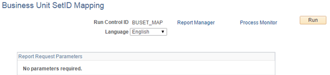

Use the Business Unit SetID Mapping page to submit the business unit SetID mapping request process. This process determines and stores the correct SetID to be used for each ChartField so this does not need to be determined at run time which should improve performance.
Navigation:
Set Up Financials/Supply Chain, and then Operational Reporting, and then Request to Map BU and SetID
This example illustrates the fields and controls on the Business Unit SetID Mapping page.
As this process also performs Business Unit SetID Mapping for Trees associated with additional SetIDs, it needs to be executed whenever a new tree definition is flattened in Tree Flattener that needs to be used in PeopleSoft General Ledger Reporting
