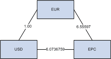

This graphic represents the three component visual rates in an exchange rate from USD to a euro participating currency (EPC), triangulating through the EUR.
Sample component visual rates
Display all three visual rates of a triangulated exchange rate by clicking the icon next to the Rate field to open the Exchange Rate Detail page.
