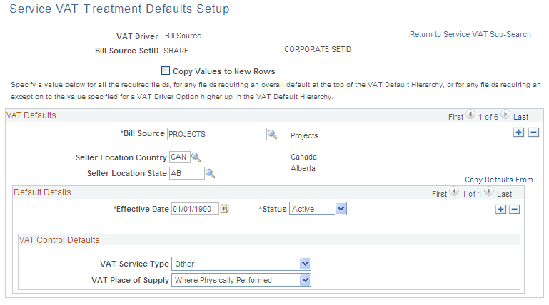

Service VAT Treatment Defaults Setup Page
VAT_DEFAULTS_DTL
Enter VAT default information for service VAT treatment.

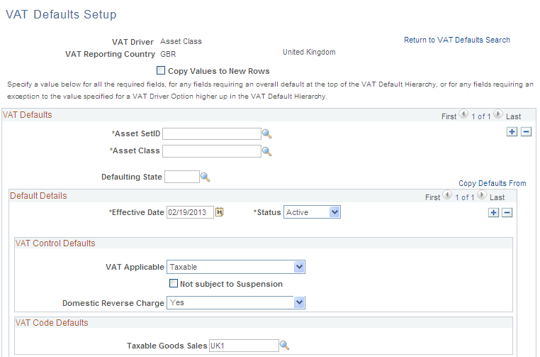

VAT Defaults Setup Page
Use the VAT Defaults Setup page (VAT_DEFAULTS_DTL) to enter VAT default information.
The fields displayed, default values, and data required vary based on the VAT driver and VAT driver keys entered.
Navigation:
Enter search criteria on the VAT Default Sub-Search page and click Search.
This example illustrates the fields and controls on the VAT Defaults Setup page (1 of 2). You can find definitions for the fields and controls later on this page.
This example illustrates the fields and controls on the VAT Defaults Setup page (2 of 2). You can find definitions for the fields and controls later on this page.
The VAT default fields that appear vary based on the VAT driver. In addition, the VAT default data is based on the VAT driver and VAT driver keys used to access this page.
Use the page to specify a value for all the required fields, for any fields requiring an overall default at the top of the VAT default hierarchy, or for any fields requiring an exception to the value specified for a VAT driver higher up in the VAT default hierarchy.
You can insert rows for any or all of the VAT driver keys as well as the VAT country or state. You can also delete any existing rows.
Field or Control Description
Return to VAT Defaults Sub-Search
Click to return to the sub-search page on which you can enter different VAT driver keys.
Copy Values to New Rows
If you are inserting a row for a VAT driver key, select this check box to copy all the VAT defaults from the previous row to the new row. Otherwise, all VAT default fields for the new row are blank.
Copy Defaults From
Click to access the Copy VAT Defaults From page, which you can use to copy VAT default specifications from another key combination for the same VAT driver.
VAT Reporting Country
Select the country or countries for which you are defining VAT defaults. In general, you obtain defaults for the VAT reporting country. For service VAT treatment, you obtain defaults for the supplier's location country.
Defaulting State
As applicable, enter the state for which you want to define defaulting values.
Default Details
Enter the effective date, status and, if applicable, the VAT SetID.
The remaining fields on the page vary based on the combination of VAT driver and VAT driver keys. See the section on VAT fields for details of the fields that appear and the VAT drivers for which they appear in hierarchy order.

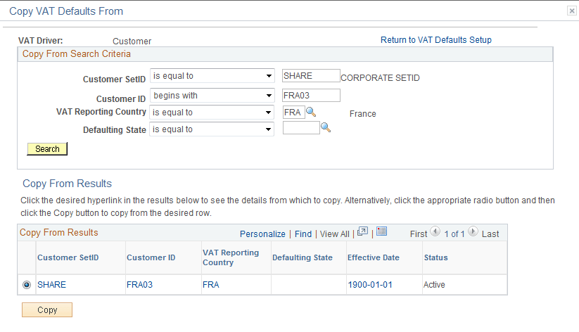

Copy VAT Defaults Setup Page
Use the Copy VAT Defaults Setup page (VAT_DEFAULT_DTLSEC) to view the details from which to copy.
Navigation:
Click any of the row links returned by the search on the Copy VAT Defaults From page.
This example illustrates the fields and controls on the Copy VAT Defaults From page. You can find definitions for the fields and controls later on this page.
Copy From Search Criteria
Enter the criteria on which you want to search. You can search by SetID, VAT reporting country, and defaulting state.
Search
Click to retrieve the results based on the criteria entered. The results appear in the Copy From Results group box.
Copy From Results
In the Copy From Results group box, click the link for any of the results returned to view the details of the VAT setup from which to copy on the Copy VAT Defaults Setup page. Once you have viewed the details, you can click Copy to copy the VAT setup. The system returns you to the VAT Defaults Setup page with the copied fields.
Or you can select the appropriate option for any of the results returned and click Copy to copy from the selected row. The system returns you to the VAT Defaults Setup page with the copied fields.

VAT Code Defaults
VAT codes specify the rate at which VAT is calculated. The following table lists the available VAT code default fields and the VAT driver for which they are available. Select the most frequently used VAT code for each VAT code field at the highest level of the VAT default hierarchy, and then specify exceptions at the lower levels of the hierarchy as necessary.
Default Field Description VAT Driver
Taxable Goods Purchases VAT Code
Select the VAT code for purchases of taxable goods.
VAT Country
PO Options
AP Options
Expenses Business Unit
Voucher Origin
Voucher Control Group
Supplier
Supplier Location
Item Category
Expense Type
Item
Taxable Services Purchases
Select the VAT code for purchases of taxable services.
VAT Country
PO Options
AP Options
Treasury Options
Voucher Origin
Supplier
Bank
Supplier Location
Bank Branch
Accounting Template
Item Category
Expense Type
Item

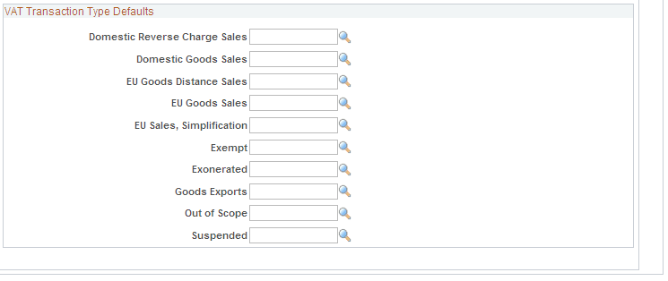

VAT Transaction Types Defaults
VAT transaction types classify and categorize transactions at a more detailed level for both VAT reporting and accounting. The following table lists the available types of VAT transaction type defaults and the VAT drivers for which they are available. Select the most frequently used VAT transaction type for each VAT Transaction Type field at the highest level of the VAT default hierarchy, and then specify exceptions at the lower levels of the hierarchy as necessary.
Default VAT Transaction Type Field Field Description VAT Driver Option
Domestic Goods Purchases
Purchase of goods within the same country.
VAT Entity Registration (required)
PO Options
AP Options
Voucher Origin
Supplier
Supplier Location
Item Category
Expense Type
Item
Domestic Goods Reverse Charge Purchases
Purchases of goods within the same country that are subject to the domestic reverse charge.
PO Options
AP Options
Voucher Origin
Supplier
Supplier Location
Item Category
Item
Domestic Goods Sales
Sale of goods within the same country.
AR Options
Order Management Business Unit
Billing Business Unit
Asset Management Business Unit
Bill Type
Bill Source
Customer
Customer Location
Asset Class
Sales Line Identifier Group
  • Product group
  • Charge code VAT group
  • Generic identifier group
  • CRM Service Type (CRM only)
  • Inventory Item Group (CRM only)
  • Product
  • Charge code
  • Discount code
  • Surcharge code
Use the Service VAT Treatment Defaults Setup page (VAT_DEFAULTS_DTL) to enter VAT default information for service VAT treatment.
Navigation:
Enter search criteria on the Service VAT Treatment Defaults Sub-Search page and click Search.
This example illustrates the fields and controls on the Service VAT Treatment Defaults Setup page showing the Bill Source driver. You can find definitions for the fields and controls later on this page.
You can insert rows for any or all of the VAT driver keys as well as the supplier's location country or state. You can also delete any existing rows.
Return to Service VAT Sub-Search
If you are inserting a row for a VAT driver key, select this check box to copy all the VAT defaults from the previous row to the new row. Otherwise, all VAT defaults for the new row will be blank.
Copy Defaults From
Click to access the Copy Service VAT Treatment Defaults From page, which you can use to copy the VAT defaults from another key combination for the same VAT driver.
Seller Location Country
Displays the location country of the seller (supplier).
Seller Location State
As applicable, enter the seller's location state.
Default Details
Enter the effective date and status.
VAT Service Type
For the applicable VAT drivers, you can set the type of service by selecting one of the following values:
Electronics/Communication
Note: Electronics/Communication services are taxed in the location where the customer is residing regardless of where the services are being rendered from.
Freight Transport
Other
VAT Place of Supply
For the applicable VAT drivers, you can specify the usual place of supply (the place where VAT liability most often occurs) by selecting one of the following values:
Buyer's Countries
Supplier's Countries
Where Physically Performed.
Copy Service VAT Treatment Defaults From Page
Use the Copy Service VAT Treatment Defaults From page (VAT_DFLT_SRCH_COPY) to copy data from an existing VAT default or service VAT treatment default setup to the current VAT driver and driver keys combination.
Navigation:
  • Click the Copy Defaults From link on the VAT Defaults Setup page.
  • Click the Copy Defaults From link on the Service VAT Treatment Defaults Setup page.
Enter the criteria on which you want to search. You can search by SetID, seller location country, and seller location state.
Search
Copy From Results
In the Copy From Results group box, click the link for any of the results returned to view the details of the VAT setup from which to copy on the Copy VAT Defaults Setup page. Once you have viewed the details, you can click Copy to copy the VAT setup. The system returns you to the Service VAT Treatment Defaults Setup page with the copied fields.
Or you can select the appropriate option for any of the results returned and click Copy to copy from the selected row. The system returns you to the Service VAT Treatment Defaults Setup page with the copied fields.

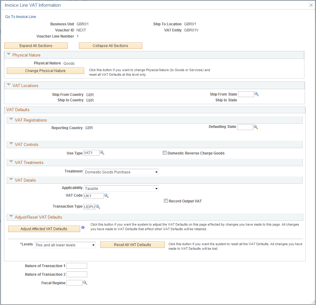

Applicable Transaction Entry VAT Page
Access the applicable transaction entry VAT page from the PeopleSoft application. The name of the page varies based on the application. The following example shows the Invoice Line VAT Information page accessed from a voucher line in PeopleSoft Payables.
This example illustrates the fields and controls on the Invoice Line VAT Information page (1 of 2) accessed from the voucher line in PeopleSoft Payables. You can find definitions for the fields and controls later on this page.
This example illustrates the fields and controls on the Invoice Line VAT Information page (2 of 2) showing all the sections expanded. You can find definitions for the fields and controls later on this page.
Selecting or deselecting the Reverse Charge Goods check box and then clicking the Adjust button adjusts the VAT Treatment, Record Output VAT, and other related defaults.
You can override default VAT settings on individual transactions from the applicable PeopleSoft application pages. For example, you can override VAT settings for a voucher line by accessing the Invoice Line VAT Information page from the Voucher component. While the fields that appear on this page may vary based on the application, the page acts in much the same way.

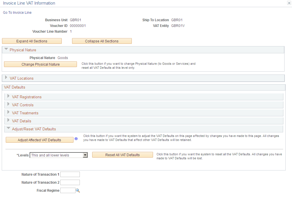

The VAT defaults appear in descending order of effect. If you change any settings on this page, you should work from the top of the page to the bottom, clicking the Adjust Affected VAT Defaults button as appropriate.
Expand All Sections
Click to expand all the VAT default sections on the page. The sections are collapsed by default.
Collapse All Sections
Click to collapse all the VAT default sections on the page.
Adjust/Reset VAT Defaults
A section at the bottom of the page enables you to adjust the VAT defaults based on changes you make on this page or to reset all VAT defaults.
Click this button to retain certain changes to VAT defaults while adjusting other VAT defaults affected by the changes. The changes retained depend on the changes you have made as described subsequently. Two examples are provided at the end of this section.
Reset All VAT Defaults
Click this button to reset all the VAT defaults. You can reset the defaults at This and all lower levels in the transaction hierarchy, All lower levels only, or This level only.
Transaction hierarchy can vary. For example, if you are dealing with the voucher header VAT page, all lower levels refers to the voucher lines and the distribution lines. However, if you are on the voucher line VAT page, all lower levels refers to the distribution lines.
Physical Nature
Physical Nature
Indicates whether an object is a good or a service. For many countries, a requirement exists to report the sale or purchase of goods, or both, separately from services.
Change Physical Nature
Click to override the default physical nature. This changes the value of the physical nature which determines the VAT treatment and resets all the VAT defaults at this level.
VAT Locations
The VAT location fields are populated by the applications. Values in these fields are never affected by changes to any of the VAT default fields and are never updated when you click the Change Physical Nature, Adjust Affected VAT Defaults, or Reset All VAT Defaults button. The possible VAT locations are:
  • Bank Country
  • Buyer's Location Country
  • Buyer's Location State
  • Consumption Country
  • Consumption State
  • Location Country
  • Location State
  • Seller's Location Country
  • Seller's Location State
  • Service Performed Country
  • Service Performed State
  • Ship From Country
  • Ship From State
  • Ship To Country
  • Ship To State
  • Ship To VAT Rgstrn Country
VAT Registrations
The fields for VAT registration defaults include:
  • Reporting Country
  • Default State
  • Bank, Customer, or Supplier Registration Country
  • Bank, Customer, or Supplier Registration ID
  • Exception Type
  • Exception Certificate ID
Any changes that you make to these values with the exception of the exception type and exception certificate ID affect all VAT default settings if you click the Adjust Affected VAT Defaults button after making changes.
If you change the exception type, only the VAT transaction type and VAT code defaults are adjusted when you click the Adjust Affected VAT Defaults button.
VAT Controls
If you change the default setting in the Calc on Advance Payments field or the Domestic Reverse Charge Goods check box, and click the Adjust Affected VAT Defaults button, the system updates all VAT default settings.
Changes to any other VAT control fields do not affect other VAT defaults. Also, if you change any of the following fields and click the Adjust Affected VAT Defaults button, your changes will be lost if you have also changed fields that affect the VAT control fields:
  • Calculate at Gross or Net
  • Recalculate at Payment.
  • Calculation Type
  • Declaration Point
  • Declaration Date
  • Accounting Entry Type
  • Rounding Rule
  • Non-Recovery Charge
  • Use Type
  • Apportionment Control
  • Recovery Source
  • Rebate Source
  • Reclaim Percent
  • Include Freight
  • Include Miscellaneous
  • In Reporting Currency
  • No VAT Receipt
  • Prorate Non-Recoverable
  • Allocate Non-Recoverable
VAT Treatments
Place of Supply Country
If the transaction is for a service, these fields show the place of supply (the place where VAT liability occurs) country and state for the service. This value is used to help determine the VAT treatment.
If you change these settings and click the Adjust Affected VAT Defaults button, the system changes all VAT default settings.
Treatment
If you change this value and click the Adjust Affected VAT Defaults button, the system updates only the VAT transaction type and VAT code, Record Input VAT, and Record Output VAT, where applicable.
Treatment Group
This field is available on the voucher header, AR pending item, and Billing invoice header VAT pages. It is also tracked on purchase orders, sales orders, and asset retirements so that the value can be copied to vouchers and bills, but it is not shown on the VAT pages.
For the transactions in which treatment group is shown on the header VAT page, the VAT treatment values on all the lines for a given transaction must be members of the treatment group on the header. Clicking the Adjust Affected VAT Defaults button after making a change to the treatment group does not update any other VAT defaults. The main impact of changing the value is on the validation of the VAT treatment on the lines. In addition, changing the treatment group on the header does not affect or change the value of the treatment on the lines.
