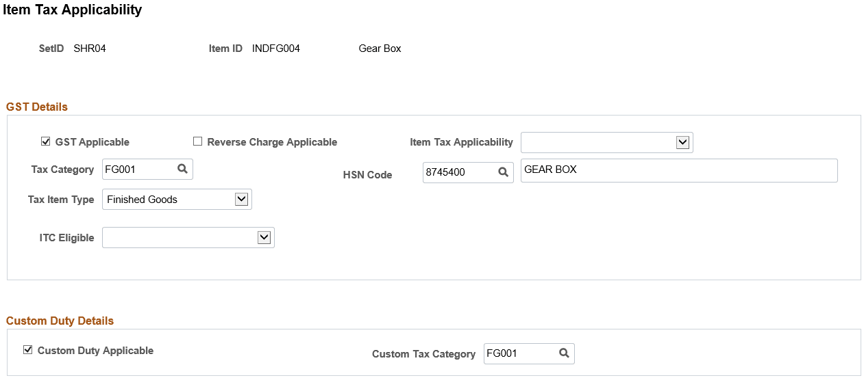

Item Tax Applicability Page
ITEM_MASTER_EX_GST
Define GST applicability details for items.
Use the Item Tax Applicability page (ITEM_MASTER_EX_GST) to define GST applicability details for items.
Navigation:
Set Up Financials/ Supply Chain, and then Common Definitions, and then India GST, and then Item Tax Applicability
This example illustrates the fields and controls on the Item Tax Applicability page. You can find definitions for the fields and controls later on this page.
GST Details
Field or Control Description
GST Applicable
Select this check box to indicate that if this item is used on a transaction, then the item is subject to GST.
Reverse Charge Applicable
Select this check box to enable GST on a reverse charge basis for the item.
Select an option that indicates how to report zero rated GST or non-GST transactions.
Options include:
  • Composite Taxable Person
  • Exempt
  • Nil Rate
  • Non GST
Tax Category
Select an option that indicates the tax rate code to use in a transaction.
HSN Code
Enter the HSN code specific to the item.
Tax Item Type
Select an option that indicates which tax determination rules to use for GST items.
ITC Eligible
Select an option that indicates how to group and report a transaction when the item is used.
Options include:
  • Capital Goods
  • Ineligible
  • Input Services
  • Inputs
Custom Duty Details
Custom Duty Applicable
Select to indicate that Custom Duty is applied when this item is imported to India.
Custom Tax Category
Select an option that indicates which custom tax category to use for the item. Tax categories are defined on the Tax Category Page.

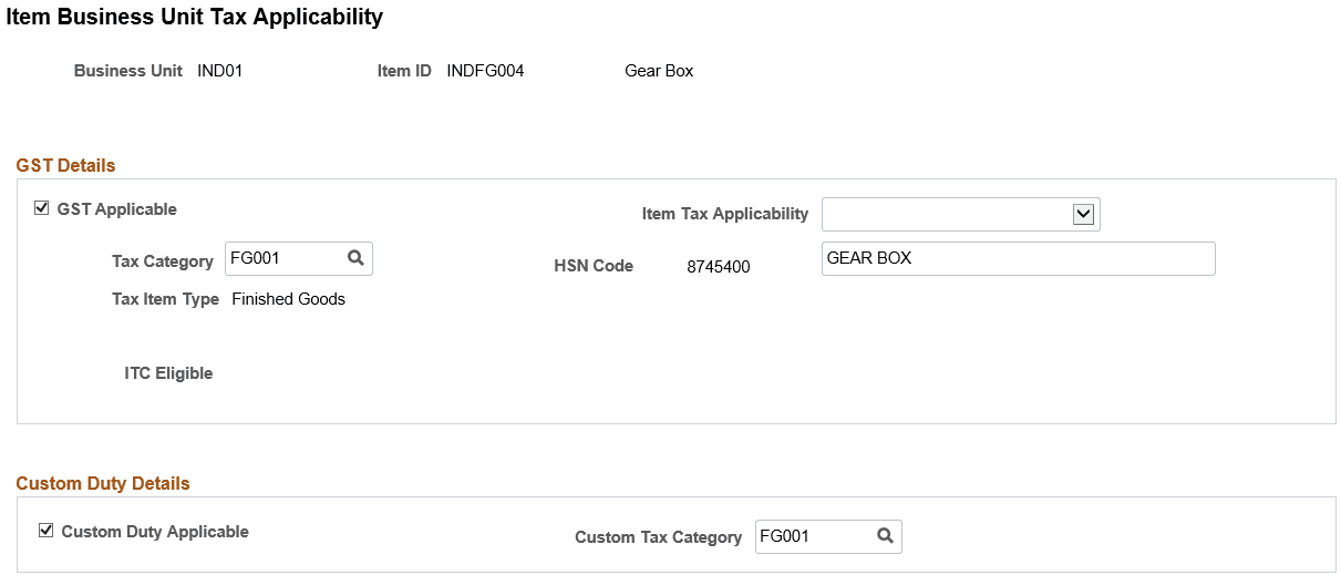

Item Business Unit Tax Applicability Page
Use the Item Business Unit Tax Applicability page (ITEM_BU_EXS_GST) to define business unit-level GST applicability details for items.
Navigation:
Set Up Financials/ Supply Chain, and then Common Definitions, and then India GST, and then Item BU Tax Applicability
This example illustrates the fields and controls on the Item Business Unit Tax Applicability page. You can find definitions for the fields and controls later on this page.
The Item Business Unit Tax Applicability page is similar to the Item Tax Applicability page. You define the GST applicability details for items at the business unit level.
GST Details
GST Applicable
Select this check box to enable GST for the transaction. If the business unit uses this item on a transaction, GST is applicable.
Options include:
  • Exempt
  • Nil Rate
  • Non GST
Item Tax Type
Displays the option selected on the Item Tax Applicability page.
HSN Code
View the HSN code specific to the item.
ITC Eligible
Custom Duty Details
The field definitions are the same as those on the Item Tax Applicability Page above.
