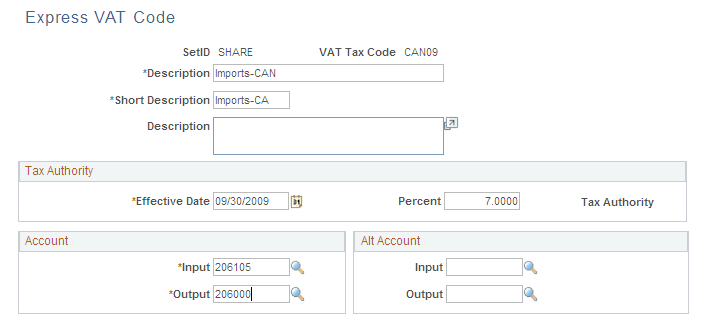

Express VAT Code Page
Use the Express VAT Code page (EX_TAX_CD_VAT) to quickly set up a VAT code by entering the required tax rate and having the system automatically create the associated VAT authority.
Navigation:
Set Up Financials/Supply Chain, and then Common Definitions, and then VAT and Intrastat, and then Value Added Tax, and then Express VAT Code
This example illustrates the fields and controls on the Express VAT Code. You can find definitions for the fields and controls later on this page.
Express VAT Code
For the VAT code you are adding, enter the VAT code, a description, and a short description.
If you have PeopleSoft Billing, the short description prints on the bills.
Field or Control Description
Effective Date
Enter the effective date for the tax percentage.
Percent
Enter the tax rate as a percentage.
Tax Authority
When you save this page, the system automatically assigns a tax authority and populates this field.
Input and Output
Enter the default account for input and output tax in the Account group box.
You can also enter a default account for input and output tax in the Alt Account (alternate account) group box.
After you create a VAT code using this page, use the VAT authority and VAT code setup pages to complete setup of VAT authority and tax code and to make any adjustments. For example, for Canada, you can set rebate rates for each public service body.

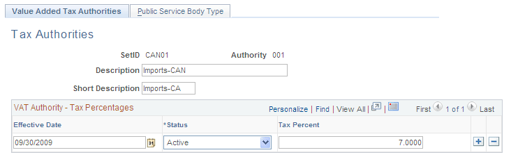

Value Added Tax Authorities Page
Use the Value Added Tax Authorities page (TAX_AUTHORITY_VAT) to create VAT authority tax percentages by effective date.
Create one VAT authority for each different tax rate.
Navigation:
Set Up Financials/Supply Chain, and then Common Definitions, and then VAT and Intrastat, and then Value Added Tax, and then VAT Authority, and then Value Added Tax Authorities
This example illustrates the fields and controls on the Value Added Tax Authorities page. You can find definitions for the fields and controls later on this page.
  1. Enter a description and a short description.
  2. Enter the effective date, status, and tax percent.
    You can add multiple rows to this page enabling you to enter new values if tax rates change.
Create a different tax authority for each VAT rate used in a country.

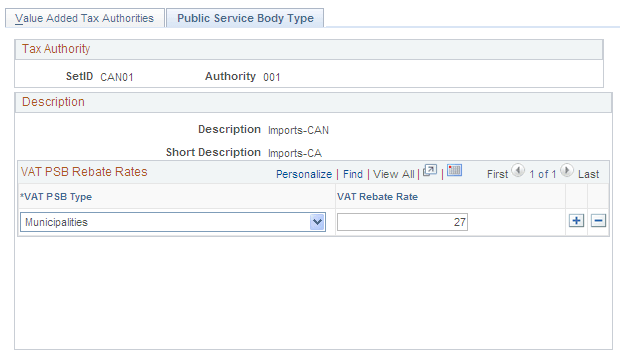

Establishing Public Service Body Type Rebates (CAN)
For Canadian public service organizations, access the Public Service Body Type page (Set Up Financials/Supply Chain, Common Definitions, VAT and Intrastat, Value Added Tax, VAT Authority, Value Added Tax Authorities, Public Service Body Type).
This example illustrates the fields and controls on the Public Service Body Type page. You can find definitions for the fields and controls later on this page.
VAT PSB Type (VAT public service body type)
Select the appropriate public service body type. Valid values are Charitable, Colleges, Hospital, Municipal, Non-Profit, School, and University.
VAT Rebate Rate
Enter the percentage set by Canadian law for rebates on input (nonrecoverable) VAT.
You must create at least one VAT use type using the VAT Use Type component for each public service body type that you create.

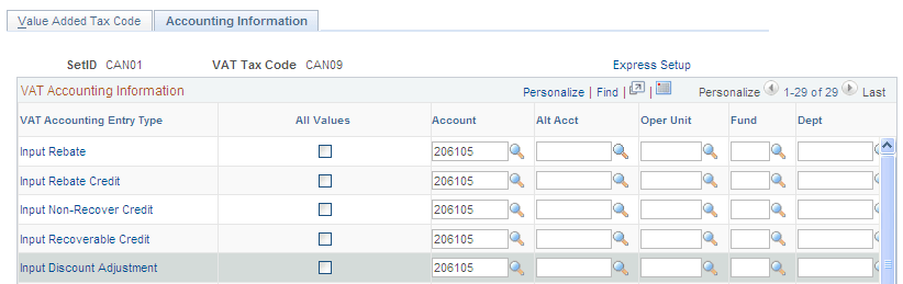

Accounting Information Page
Use the Accounting Information page (TAX_ACCTG_VAT) to specify accounts and ChartFields used when recording VAT for a VAT code.
Navigation:
Set Up Financials/Supply Chain, and then Common Definitions, and then VAT and Intrastat, and then Value Added Tax, and then VAT Code, and then Value Added Tax Code, and then Accounting Information
This example illustrates the fields and controls on the Value Added Tax Code - Accounting Information page. You can find definitions for the fields and controls later on this page.
Express Setup
Click to access the VAT Accounting Express Setup page to quickly set up default values for input and output VAT ChartFields. The system applies these defaults to all the applicable VAT accounting entry types.
VAT Accounting Entry Type
Lists all the VAT accounting entries that apply to the PeopleSoft applications that you installed. For example, if your installation includes only sales-related applications (such as PeopleSoft Order Management, Billing, and Receivables), you see only accounting entry types that are related to output VAT on sales.
Clicking any of the VAT accounting entry types listed opens the VAT Accounting Exceptions page on which you can define specific ChartFields for VAT transaction type exceptions.
Note: You can specify a single set of ChartFields for a VAT code using the Accounting Information or Express Setup page, and the system uses those values for all VAT transaction types used with that VAT code. However, if a certain type of transaction must be reported separately, then it is easier to reconcile the VAT reports to the general ledger if these transactions are posted to separate ChartFields.
All Values
Select to display all values when you click account. Otherwise, the system displays only those accounts that have been flagged in PeopleSoft General Ledger as VAT accounts.
Account
You must provide values for all the account ChartFields listed. You cannot save the page without recording an account number for each available field. If a particular account type is not applicable in your environment based on the applications installed, complete the Account field with a dummy value.
Alt Act (alternate account), Oper Unit (operating unit), Fund, Dept (department), Program, Class, Bud Ref (budget reference), Product, Project, Affiliate, Fund Affil (fund affiliate), and Oper Unit Affil (operating unit affiliate)
Complete these optional ChartFields as needed.

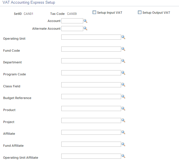

VAT Accounting Express Setup Page
Use the VAT Accounting Express Setup page (TAX_BUACT_EXPRESS) to specify a set of input and output VAT ChartFields as the default for a VAT code and general ledger business unit.
Navigation:
Click the Express Setup link on the VAT Accounts by Business Unit page.
This example illustrates the fields and controls on the VAT Accounting Express Setup page. You can find definitions for the fields and controls later on this page.
Setup Input VAT
Select to specify the ChartField information to be used for recording input VAT.
Setup Output VAT
Select to specify the ChartField information to be used for recording output VAT.
Specify the appropriate ChartField values. Click OK to return to the Accounting Information page.

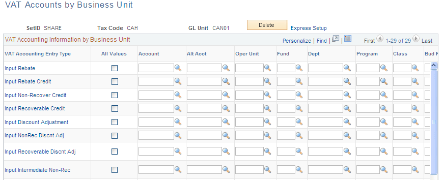

VAT Accounts by Business Unit Page
Use the VAT Accounts by Business Unit page (TAX_BUACT_VAT) to set up VAT accounts by VAT code and general ledger business unit.
Navigation:
Set Up Financials/Supply Chain, and then Common Definitions, and then VAT and Intrastat, and then Value Added Tax, and then Accounts by Business Unit, and then VAT Accounts by Business Unit
This example illustrates the fields and controls on the VAT Accounts by Business Unit page. You can find definitions for the fields and controls later on this page.
Delete
Click to delete all entries for this combination of general ledger business unit and VAT code. For example, if you entered a set of defaults for a general ledger business unit and later decided this was not necessary, you would access this page for the general ledger business unit and use the Delete button to delete all entries.
Express Setup
Clicking any of the VAT accounting entry types listed opens the VAT Accounting Exceptions page, on which you can define specific ChartFields for VAT transaction type exceptions.
Note: You can specify a single set of ChartFields for a VAT code using the Accounting Information or Express Setup page, and the system uses those values for all VAT transaction types used with that VAT code. However, if a certain type of transaction must be reported separately, then reconciling the VAT reports to the general ledger is easier if these transactions are posted to separate ChartFields.
All Values
Account
Populate these optional ChartFields as needed.
