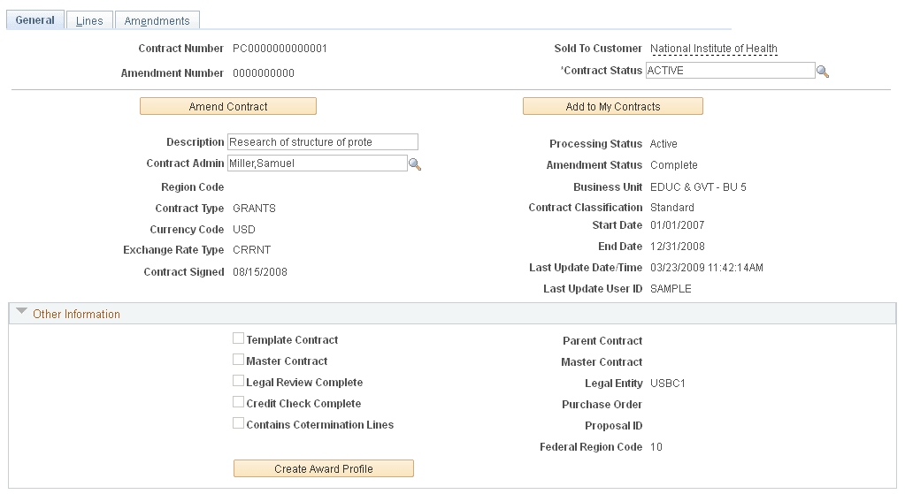

Contract - General Page
Use the Contract - General page (CA_HDR_PNL) to close out award lines.
Navigation:
Customer Contracts, and then Create and Amend, and then General Information, and then General
This example illustrates the fields and controls on the Contract - General page. You can find definitions for the fields and controls later on this page.
Change the contract status to Closed to indicate that either the contract has been terminated midstream (the status went directly from Pending to Closed or was canceled after processing) or archived (all contractual obligations have been fulfilled and all entitlements received). Contracts that are set to Closed are removed from processing and views, but the historical contract data is still available by query.
For as-incurred billing plans, you must manually change the status on the Billing Plan General page because the system doesn't know when the last transactions have been accumulated in PeopleSoft Project Costing and processed through to PeopleSoft Billing.
For as-incurred revenue recognition (award revenue), you must manually change the revenue recognition plan status to Done because the system does not know when the last transactions were accumulated in PeopleSoft Project Costing and processed through to revenue recognition. If your as-incurred revenue recognition plan has events associated with it, you must wait until all events are complete before you can change the revenue recognition plan status to Done.

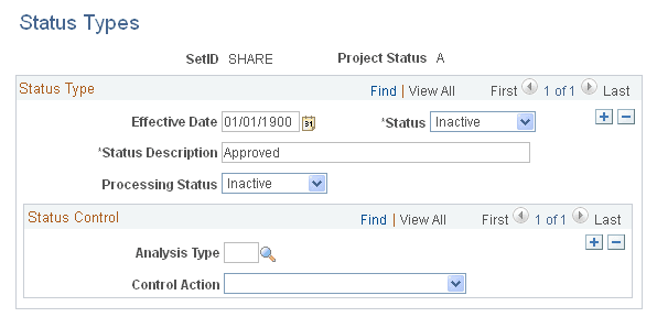

Status Types Page
Use the Status Types page (PROJ_STATUS_DEFN) to create status types and set control actions to limit transactions coming into PeopleSoft Project Costing from cost-feeder applications.
Navigation:
Setup Financials/Supply Chain, and then Product Related, and then Project Costing, and then Project Options, and then Status Types
This example illustrates the fields and controls on the Status Types page. You can find definitions for the fields and controls later on this page.
Status Types page
You can identify the project statuses that you want to use.
Field or Control Description
Effective Date
Select the date when the status change goes into effect. Status types are effective-dated, so multiple statuses can be defined and applied sequentially to a project or activity over time.
Status
Active appears by default. Select Inactive to deactivate the status control options that are associated with the effective date.
Processing Status
Select a system-delivered value of Active, Inactive, or Pending. Each project status also needs to be associated with a processing status in the system.
Analysis Type
Select an analysis type to specify the transactions used by a feeder application that you want to exert control over. The analysis type from each feeder application is defined on the Installation Options - Project Costing Integration page.
Control Action
Select a value to associate with the analysis type. Values include:
  • Warning: A warning appears before PeopleSoft Project Costing accepts transactions that are specified in the Analysis Type field.
  • Reject: Transactions that are specified in the Analysis Type field are rejected by PeopleSoft Project Costing.
  • None (blank): No project control action occurs if the Project Control Action check box is blank
Note: Status type flags (project control actions) do not prevent feeder system transactions from being posted to PeopleSoft General Ledger because the transactions are already part of the PeopleSoft Financials system. The Reject Project Control action prevents the transaction from being entered in PeopleSoft Project Costing only.

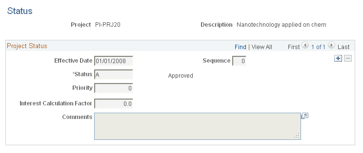

Project - Status Page
Use the Project - Status page (PROJECT_STATUS) to set the status for a project.
Navigation:
Project Costing, and then Project Definitions, and then Update Project Status
This example illustrates the fields and controls on the Project - Status page. You can find definitions for the fields and controls later on this page.
This page drives the processing status on the Project General page. To activate a project, you add a new row with the status that is listed on the Project Setup page as Active. This is how you activate the project during the Award Generation process with prespending.
To restrict incoming transactions, set the Status field to Closed. A closed project does not appear in prompt lists in PeopleSoft feeder systems.

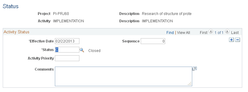

Activity - Status Page
Use the Activity - Status page (PROJECT_ACT_STATUS) to set the status for an activity.
Navigation:
Project Costing, and then Activity Definitions, and then Update Activity Status
This example illustrates the fields and controls on the Activity - Status page. You can find definitions for the fields and controls later on this page.
To restrict incoming transactions, set the Status field to Closed. A closed activity does not appear in prompt lists in PeopleSoft feeder systems.

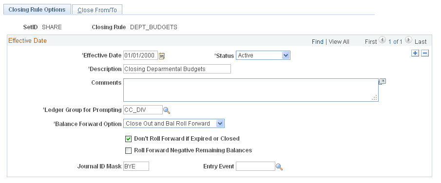

Closing Rule Options Page
Use the Closing Rule Options page (KK_CLOSE_DEFN1) to define the closing rules for the PeopleSoft Commitment Control budget, specifically whether to roll forward remaining budget amounts and how that roll-forward amount is calculated.
Navigation:
Commitment Control, and then Close Budget, and then Define Closing Rule, and then Closing Rule Options
This example illustrates the fields and controls on the Closing Rule Options page. You can find definitions for the fields and controls later on this page.
Use this page to define the closing rules for the PeopleSoft Commitment Control budget, specifically whether to roll forward remaining budget amounts and how that roll-forward amount is calculated.
After you identify the closing rules for a PeopleSoft Commitment Control budget, you can process the close when you need to by using the Budget Close Request page. The Budget Close process (FSPYCLOS) applies the closing rules to the selected PeopleSoft Commitment Control budget ledgers. You can review the results on the Calculation Log on the Budget Closing Inquiry page.
If you make a mistake, use the Budget Close Request page to undo a close.

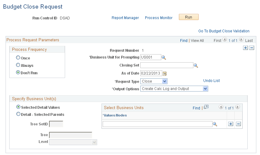

Budget Close Request Page
Use the Budget Close Request page (KK_CLOSE_REQUEST) to initiate the Budget Close process.
Navigation:
Commitment Control, and then Close Budget, and then Process Budget Close
This example illustrates the fields and controls on the Budget Close Request page. You can find definitions for the fields and controls later on this page.
Instructions for using the Budget Close Request page appear in the PeopleSoft Commitment Control documentation.
