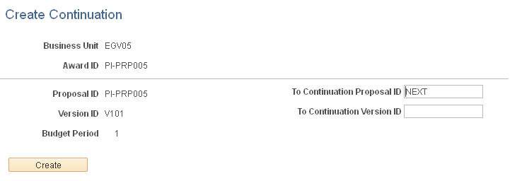

Create Continuation Page
Use the Create Continuation page (GM_CONT_ID_CREATE) to create a continuation.
Navigation:
Grants, and then Awards, and then Create Continuation
This example illustrates the fields and controls on the Create Continuation page. You can find definitions for the fields and controls later on this page.
Field or Control Description
Proposal ID
Displays the proposal ID that is associated with the selected award.
To Continuation Proposal ID
Enter the continuation proposal ID. Enter NEXT to have the system increment the proposal ID.
To Continuation Version ID
Budget Period
Displays the budget period.
Create
Click Create to create the continuation proposal.

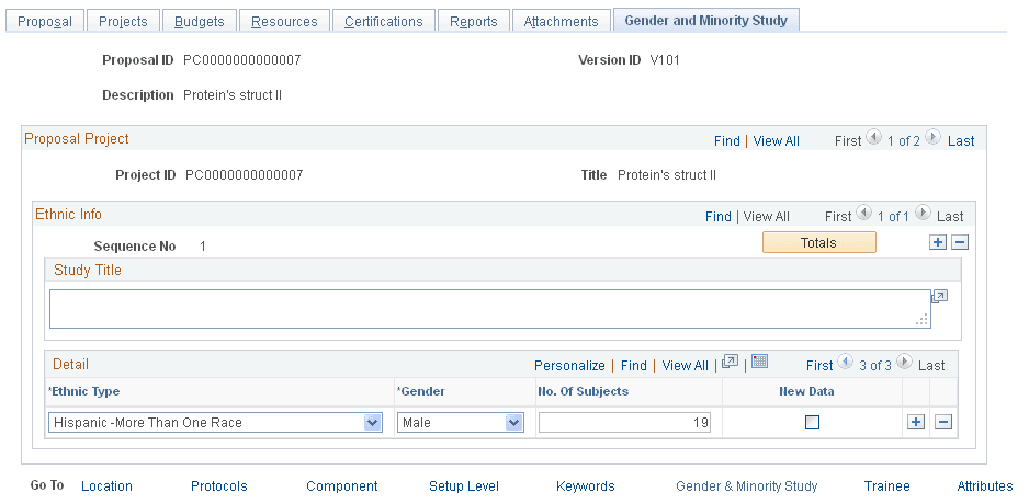

Gender and Minority Study Page
Use the Gender and Minority Study page (GM_CONT_PRJ_ETHNIC) to document information regarding the gender and ethnic status of persons who are used in human research.
Navigation:
Grants, and then Proposals, and then Maintain Proposal, and then Gender and Minority Study
This example illustrates the fields and controls on the Gender and Minority Study page. You can find definitions for the fields and controls later on this page.
Ethnic Type and Gender
Select a value to represent the subject's ethnicity and gender. This data comes from a translate table and maps to continuation proposal forms.
No. Of Subjects (number of subjects)
Enter the number of people who are involved in the study who match the ethnic type and gender on the grid line. This information maps to continuation proposal forms.
New Data
Select if this is new data. All existing gender and minority information becomes old data when you create the Non-Competing Continuation proposal. If you modify this proposal and add a new gender, then that information becomes new data. The Forms Print process uses the presence of new data to determine whether to print this gender information on the Target/Planned Enrollment table or the Inclusion Enrollment report.
Totals
After you enter information regarding gender and ethnicity, the system enables this button. Click to display a page that lists totals by ethnic type, race, and gender.

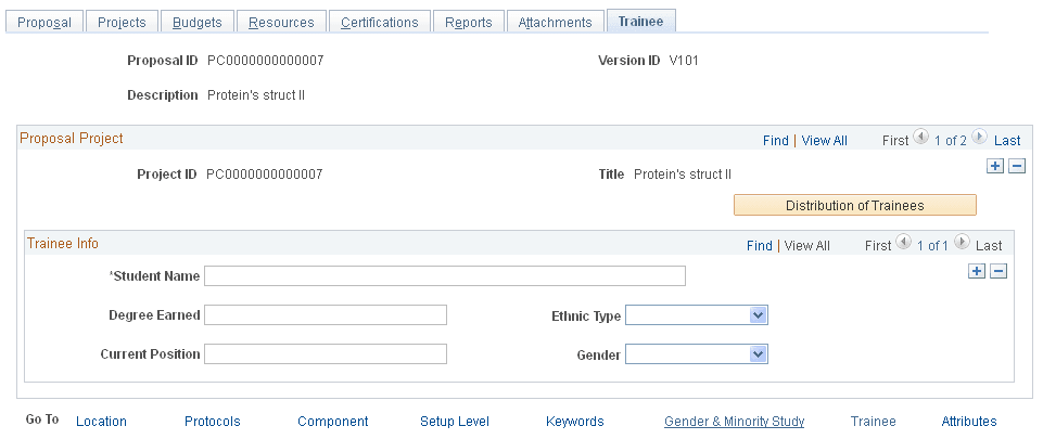

Trainee Page
Use the Trainee page (GM_CONT_PRJ_TRAIN) to summarize information about student trainees who are participating in a continuation project.
Navigation:
Grants, and then Proposals, and then Maintain Proposal, and then Trainee
This example illustrates the fields and controls on the Trainee page. You can find definitions for the fields and controls later on this page.
Trainee page
Enter the student name, degree earned, and current position for each trainee participating in the project. You can enter multiple lines for multiple trainees.
Distribution of Trainees
Click to access an inquiry page that lists totals by ethnic type, race, and gender.
Select a value to represent the student's ethnicity and gender. This data comes from a translate table and maps to the continuation proposal forms.
