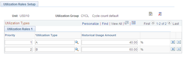

Utilization Rules Setup Page
To define calculation rules for utilization types, use the Utilization Rules Setup component.
Use the Utilization Rules Setup page (UTIL_RULES_INV) to specify parameters for the Utilization Type Calculation process for a specified utilization group.
Navigation:
Inventory, and then Inventory Counts, and then Prepare Counting Event, and then Setup Utilization Rules, and then Utilization Rules Setup
This example illustrates the fields and controls on the Utilization Rules Setup page. You can find definitions for the fields and controls later on this page.
Field or Control Description
Required Rule Parameters
Click to access the Utilization Type Setup Parameters page, where you can select attributes to use in the utilization type calculation. Click this button if you are entering data for this business unit and utilization group for the first time or if you want to make changes.
Clone Utilization Rules
Click to access the Copy Utilization Rules page, where you can copy this business unit's rules to other business units.
Priority
Enter a priority ranking to each calculation rule. The Utilization Types Calculation process assigns items to the highest-rank priorities first.
Utilization Type
Enter an ABC classification and enter the minimum values for the attributes that you defined on the Utilization Type Setup Parameters page. The Utilization Type Calculation process uses these values to determine which items to assign to a utilization type.
The system categorizes an item into a particular utilization type classification (such a A) when the item meets just one of the parameters that you defined here. The Utilization Type Calculation process assigns each item to the highest utilization type that it meets. For example, if an item meets the A classification for on-hand quantity and the B classification for unit cost, then the system classifies the item as an A item.

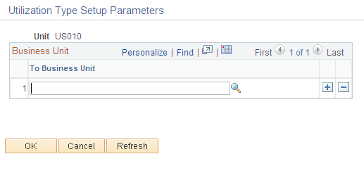

Copy Utilization Rules Page
Use the Copy Utilization Rules page (UTIL_CLONE_SEC) to copy the utilization rules from the current business unit to other business units.
Navigation:
Click the Clone Utilization Rules button on the Utilization Rules Setup page.
This example illustrates the fields and controls on the Copy Utilization Rules page. You can find definitions for the fields and controls later on this page.
