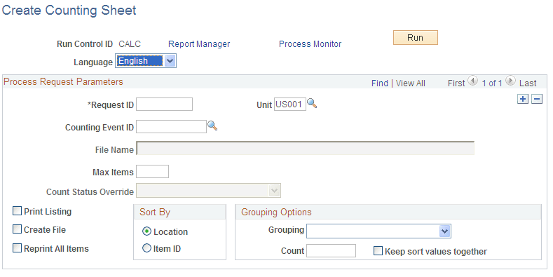

Create Counting Sheet Page
Use the Create Counting Sheet page (RUN_INS9051) to generate a file to download to an electronic data collection device or to print a counting sheet listing.
Navigation:
Inventory, and then Inventory Counts, and then Prepare Counting Event, and then Create Counting Sheet, and then Counting Sheet
This example illustrates the fields and controls on the Create Counting Sheet page. You can find definitions for the fields and controls later on this page.
Field or Control Description
File Name
Defines the counting sheet file.
Max Items (maximum number of items)
Defines the largest number of items to include in a file or printed count sheet. Leave the field blank to include all items. You can enter a number greater than the number of items specified on the Counting Event Setup - Count Options page if you are unsure of the number of items available to count. You can also enter a smaller number to minimize the number of items in the counting event. To include the remaining items in the file or printed count sheet listing, run the Counting Sheet process again.
Print Listing
Includes all counting event detail lines with a status of New on the counting sheet listing if you are collecting count quantity data on paper.
Create File
Creates an electronic counting sheet file to download to the device if you are counting with an electronic data collection device. The file name must be an eight-character name. Do not include a directory, drive name, or file extension. Your environment settings define where to create the file. The Counting Sheet process appends a .DWN extension to the file name. If the file already exists, an error message appears.
Reprint All Items
Includes all counting event detail lines in the printout regardless of their counting status.
Sort By
Sorts information on the Item Counts page. Values are:
Location: Sorts by storage location (storage area, storage level 1, storage level 2, storage level 3, storage level 4), item ID, lot ID, serial, container, staged date, and UOM.
Item ID: Sorts by item ID, storage location (storage area, storage level 1, storage level 2, storage level 3, storage level 4), lot ID, serial, container, staged date, and UOM.
Grouping Options
Defines how to group the list of Counting Sheet report.
  • Grouping: Available options are:
    • Max rows per group - Indicates the total number of rows for a group in a report.
    • Number of groups - Indicates the total number of groups in a report.
  • Count: Defines the number of rows in a group or total number of groups in a report.
  • Keep sort values together: Defines whether to create a new group or page when the Sort By value changes.
    For example, if you select the Sort By value as Item ID, and then select the Keep sort values together check box, the system creates a new group or page when the current item ID is not the same as the last.
    If you do not select the check box, the system creates new group or page regardless of the change in the Sort By value.

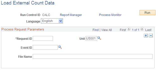

Load External Count Data Page
Use the Load External Count Data page (RUN_INS9050) to upload the data file to the database if you collect count quantity data with electronic data collection devices.
Navigation:
Inventory, and then Inventory Counts, and then Perform Count, and then Load External Count Data
This example illustrates the fields and controls on the Load External Count Data process page. You can find definitions for the fields and controls later on this page.
Event ID
Select an ID for the counting event if you are loading count quantity data for a previously created, system-defined counting event. PeopleSoft Inventory updates the counting event detail lines with the quantities from the electronic data collection device and changes the status of the items to Ready to Update Stock Quantity.
Leave the Event ID field blank to load the count data into the Manual Count table if you are loading count quantity data for a manual count. The Event Creation process moves the detail lines in the Manual Count table to the Counting Event table during the creation of the manual counting event.
File Name
Enter the count data file to load. Do not include a directory, drive name, or file extension. Your environment settings indicate where to find the file.

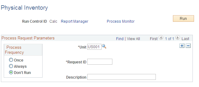

Physical Inventory Page
Use the Physical Inventory page (BCT_INV_REQPHYS) to establish run control parameters for the Physical Inventory process.
The process moves counting event data, staged by third-party applications using the Physical InventoryEIP to the Counting Event table in PeopleSoft Inventory.
