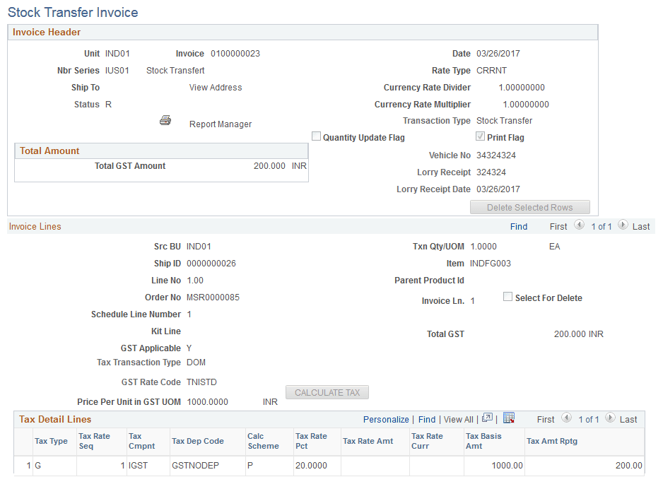

Stock Transfer Invoice Page
Use the Stock Transfer Invoice page (EXD_SHP_INVOICE) to add or update stock transfer invoices by adding invoice lines to this page.
Navigation:
Inventory, and then Fulfill Stock Orders, and then Stock Transfer IND, and then Stock Transfer Invoice
This example illustrates the fields and controls on the Stock Transfer Invoice page. You can find definitions for the fields and controls later on this page.
Invoice Header
Field or Control Description
Unit
Enter the PeopleSoft Inventory business unit that shipped the stock.
Invoice
Displays the stock invoice number assigned to this stock transfer invoice.
The number is from the Document Number Series and the PeopleSoft Inventory business unit defined in the Unit field. The system validates the appropriate tax location for the unit to identify the format for the document number, such as prefix and length. If the Overwrite Allowed check box has been selected on the Document Number Series page, then the user is allowed to add the invoice number. If the overwrite option has not been selected, the excise invoice number field displays NEXT until you save the stock transfer invoice.
Date
Displays the date this stock transfer invoice was created. When adding a new invoice, the system automatically uses the current system date. This value cannot be changed.
Nbr Ser (Number Series)
Displays the stock transfer number.
Ship To
This field does not pertain to GSC and does not display a value.
View Address
Select to view the shipping address of the Ship To Customer ID. The address that appears (and used) is the address specified for the address sequence number selected, not any address overrides entered.
Rate Type, Currency Rate Divider, Currency Rate Multiplier
Displays the sales order header information linked to the shipping lines added to this invoice.
Add New Lines
Click this link to access the Select Shipping Lines page (EXD_SHP_INV_SRCH), where you can search and select the shipping lines to be added to this stock transfer invoice.
Print
Click this button to print the completed stock transfer invoice. The invoice must have a status of Ready or Posted to be printed.
Status
Displays the status of the stock transfer invoice. Values are:
  • N (New): The invoice has been entered and saved. The user can return to the Stock transfer invoice page and make further changes to the invoice.
  • R (Ready to post): The invoice has been entered and the user has manually changed the status to ready. The user can no longer make changes to the invoice.
  • P (Post): The invoice has completed the Invoice Posting subprocess of the Register Update process.
  • C (Cancel): The invoice has been canceled. Canceled invoices are saved for audit purposes and to insure the invoice numbers are sequential.
Transaction Type
Displays the type of transaction to be entered (Stock Transfer).
Quantity Update Flag
This field does not pertain to GSC.
Print Flag
Indicates the stock transfer invoice has been printed. Any additional prints are identified as duplicates.
Delete Selected Rows
Click to delete selected invoice lines.
You must select the ‘Select for Delete’ option before you can use this button.
Enter the required information about the shipment vehicle including vehicle number, lorry receipt number, and lorry receipt date.
Total Amount
Total GST Amount
Displays the total GST amount for all lines in this stock transfer invoice.
Invoice Lines
Displays the stock transfer invoice lines added using the Select Shipping Lines page. The fields are populated from the shipping ID, sales order, or interunit transfer.
Src BU (Source Business Unit)
Displays the business unit that originated the order. For an interunit transfer it is the shipping PeopleSoft Inventory business unit and for a sales order it is the PeopleSoft Order Management business unit.
Txn Qty/UOM (Taxation quantity/Unit of measure)
Displays the transaction Quantity and unit of measurement from the material stock request or express issue.
Ship ID (Shipping ID)
Displays the shipping ID from the material stock request or express issue.
Item
Displays the item ID of the material that you are transferring.
Line No (Line Number)
Displays the line number from the material stock request.
Parent Product ID
Order No (Order Number)
Displays the material stock request number.
Invoice Ln (Invoice Line)
Displays the invoice line number from the material stock request.
Select for Delete
Select this option to flag the invoice row for deletion.
You must still click the Delete Selected Rows button to delete the row.
Schedule Line Number
Displays the schedule line number from the material stock request.
Kit Line
Total GST
Displays the total GST for the individual invoice line.
GST Applicable
Indicates whether GST is applicable to the invoice line.
Tax Transaction Type
Defines the type of transaction. Values include:
  • DEB (direct export with bond)
  • DEWB (direct export without bond)
  • DIMP (direct import)
  • DOM (domestic)
  • LEB (local export with bond)
  • LEWB (local export without bond)
  • LIMP (local import)
GST Rate Code
Displays the tax rate code for GST duty as defined on the Tax Determination page.
Price Per Unit in GST UOM (Price Per Unit in GST Unit of Measure)
Displays the item price based on the item unit of measure.
Calculate Tax
Click to calculate GST for the invoice line.
Tax Detail Lines
The bottom portion of this page displays the GST calculations for each stock transfer invoice line. When you save the page or click the Calculate Tax button, the results of tax determination and tax calculations appear in this section.
Tax Type
Displays the tax type for the row, as defined on the Tax Component page. For GST the value is Goods and Services Tax.
Tax Rate Seq (Tax Rate Sequence)
Displays the line number for each GST tax line calculated in the Tax Detail Lines grid.
Tax Cmpnt (Tax Component)
Displays tax component codes established for each tax, as defined on the Tax Components page.
Tax Dep Code (Tax Dependency Code)
Indicates the basis for calculating the tax as well as the precedence of taxes of the same tax type that must be included.
Calc Scheme (Calculation Scheme)
Displays the default calculation scheme associated with the selected tax component code. You can override this value. Values are:
  • A (Amount): Ad hoc amount-based tax calculation.
  • P (Percentage): Percentage-based tax calculation. This is the default value.
  • Q (Quantity): Quantity-based tax calculation.
Tax Rate Pct (Tax Rate Percent)
If the Calculation Scheme field value is set to Percentage, this field displays the percentage to be applied against the taxable amount.
Tax Rate Amt (Tax Rate Amount)
If the Calculation Scheme field value is set to Amount, this field displays the amount to be applied.
Tax Rate Curr (Tax Rate Currency)
Displays the currency associated with the GST tax.
Tax Basis Amt (Tax Basis Amount)
If the Calculation Scheme field value is set to Percentage, this field displays the base value used for the tax calculations.
Tax Amt Rptg (Tax Amount Reporting)
Displays the tax reporting currency that appears by default from the Tax Location page.

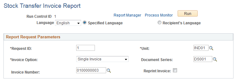

Stock Transfer Invoice Report Page
Use the Stock Transfer Invoice Report page (RUN_INS6801) to create a PDF copy of the stock transfer invoice to accompany the item shipment from PeopleSoft Inventory.
If more than one copy is created, the subsequent copies are marked as duplicates.
Navigation:
Inventory, and then Fulfill Stock Orders, and then Stock Transfer IND, and then Stock Transfer Invoice Report
This example illustrates the fields and controls on the Stock Transfer Invoice Report page. You can find definitions for the fields and controls later on this page.
Invoice Option
Indicates the stock transfer invoices to be printed. Values are:
  • All Invoices
  • Date of Invoice
  • Range of Invoices
  • Single Customer
  • Single Invoice
  • Single Location
Document Series
Enter the document number series for the stock transfer invoice that you want to print. This field is available if you selected Single Invoice for the invoice option.
Invoice Number
Enter the stock transfer invoice number for the invoice that you want to print. This field is available if you selected Single Invoice for the invoice option.
Reprint Invoice
Select to print a second copy of the stock transfer invoice. The invoice is marked as a duplicate. This field is available if you selected Single Invoice for the invoice option. When this option is selected, only invoices that have been previously printed are available in the Invoice Number field.

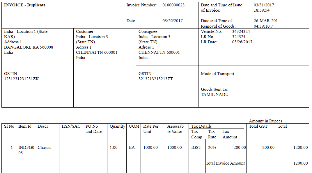

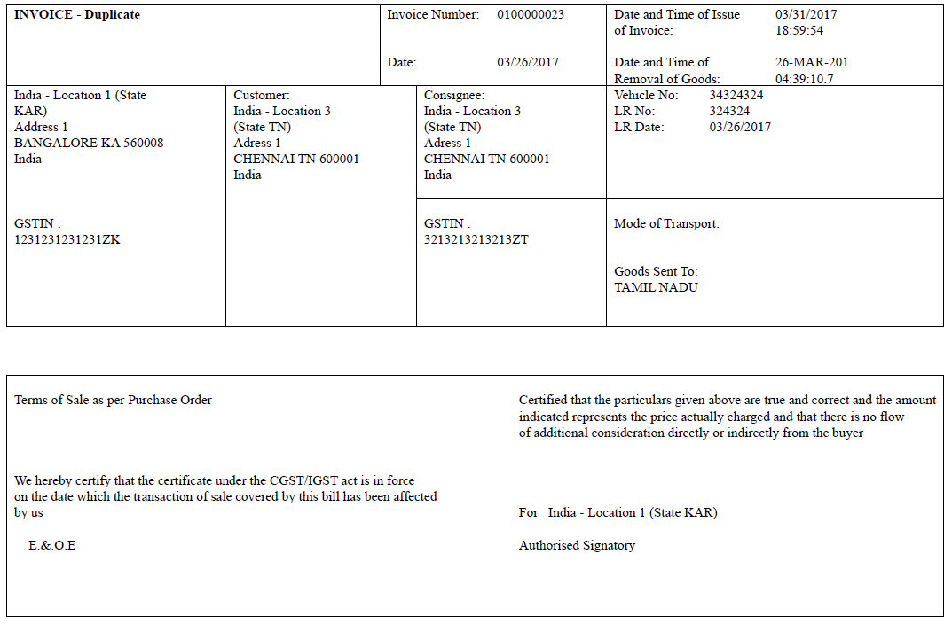

Sample Stock Transfer Invoice Report Output
The following is an example of the Stock Transfer Invoice Report output:
Sample Stock Transfer Invoice Report Output (1 of 2)
Stock Transfer Invoice Report Sample (1of2)
Sample Stock Transfer Invoice Report Output (2 of 2)
Stock Transfer Invoice Report Sample (2of2)
