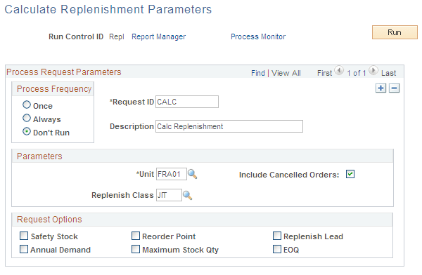

Calc Replenishment Parameters Page
Use the Calc Replenishment Parameters page (REPLEN_PRM_REQ_INV) to define options for the Calculate Replenishment Parameters process.
Navigation:
Inventory, and then Replenish Inventory, and then Calc Replenishment Parameters
This example illustrates the fields and controls on the Calculate Replenishment Parameters page. You can find definitions for the fields and controls later on this page.
Field or Control Description
Replenish Class
Enter a value to calculate the replenishment parameters for items belonging to a specific class. If this field is blank, the replenish lead time will be calculated for all items where the replenish class is not blank. For all other calculations, a blank replenish class on the run control page means to calculate for all items.
Include Cancelled Orders
Select to include canceled orders in the demand history calculations.
Safety Stock
Select to calculate safety stock levels.
Safety stock is equal to the Mean Absolute Deviation Safety Stock (MAD_SFTY_STK) multiplied by the Replenishment Lead Time for the item (REPLENISH_LEAD). The safety stock calculation uses the window of time between today's date and today's date minus the replenishment calculation period.
After you run the Calculate Replenishment Parameters process, the system determines the Average Demand (AVG_DEM_QTY) by taking the sum of the Actual Demand (SUM_DEM_QTY) and dividing it by the Replenishment Calculation Period (REPL_CALC_PERIOD) for the item. Next, the system loops through each day of the calculation period, sums the Actual Demand (DEM_QTY) for the day, and subtracts the Average Demand (AVG_DEM_QTY) to result in the mean absolute deviation as an absolute value (MAD_DELTA_QTY). The Actual Demand (DEM_QTY) is the Sum of Quantity Base for all orders for an item on a specific schedule date. Then the system adds all of the deviations: the sum of the average absolute deviation (MAD_SUM_QTY) is equal to the sum of the mean absolute deviations (MAD_DELTA_QTY). Finally, the formula for safety stock is applied as follows:
  • The average absolute deviation (MAD_QTY) is determined by the sum of the average absolute deviations (MAD_SUM_QTY) divided by the Replenishment Calculation Period (REPL_CALC_PERIOD).
  • The Mean Absolute Deviation Safety Stock (MAD_SFTY_STK) is determined by multiplying the average absolute deviation (MAD_QTY) by the stock-in probability (Z_VALUE) specified by the customer.
  • Safety Stock is equal to the Mean Absolute Deviation Safety Stock (MAD_SFTY_STK) multiplied by the Replenishment Lead Time for the Item (REPLENISH_LEAD).
From the window of BETWEEN TODAY & TODAY − (REPL_CALC_PERIOD)
AVG_DEM_QTY = SUM_DEM_QTY / REPL_CALC_PERIOD
This portion loops for every day in the window regardless of DEM_QTY = 0
MAD_DELTA_QTY = |DEM_QTY − AVG_DEM_QTY|
MAD_SUM_QTY = MAD_SUM_QTY + MAD_DELTA_QTY
MAD_QTY = MAD_SUM_QTY / REPL_CALC_PERIOD
MAD_SFTY_STK = Z_VALUE * MAD_QTY
SAFETY_STOCK = MAD_SFTY_STK * REPLENISH_LEAD
Reorder Point
Select to calculate reorder points for the business unit. The Calculate Replenishment Parameters process calculates reorder points as follows: ((sum of the demand during calculation period * lead time) / calculation period) + safety stock.
Replenish Lead
Select to calculate the business unit's replenishment lead time. The Calculate Replenishment Parameters process calculates replenishment lead time for all items except those that have an Under Initialization, Pending Approval, or Denied Approval status. The process averages the difference between an item's PO date and its subsequent put away date. The PO date is required for this calculation. If the transaction date is before the PO date, the transaction will be ignored by the replenish lead calculation.
Annual Demand
Select to calculate the annual demand for the business unit. PeopleSoft Inventory calculates this value as follows: Sum of the demand from (today's date less 365 days) through today's date.
Maximum Stock Qty (maximum stock quantity)
Select to calculate the maximum on-hand quantity for the business unit. This calculation is computed as follows: (average daily demand for calculation period * (lead time + calculation period)) + safety stock.
EOQ (economic order quantity)
Select to calculate economic order quantities for the business unit This option will not be available if the EOQ option is not selected on the Setup Replenishment page. The Calculate Replenishment Parameters process calculates EOQ by using the industry standard calculation. In this formula, d equals the last calculated annual demand for an item, c equals order preparation cost of EOQ defined on the Setup Replenishment page, i equals annual inventory carrying cost percentage defined on the Setup Replenishment page, and u equals the item's standard or average cost, depending on the item's cost method.
EOQ
EOQ
EOQ always calculates to zero unless the reorder point quantities option on the Setup Replenishment page is EOQ.

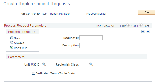

Create Replenishment Reqs (AE) Page
Use the Create Replenishment Reqs (AE) page (REPL_OPT_REQ_INV) to generate replenishment requests by specifying business unit and replenishment class and then running the Create Replenishment Requests process.
Navigation:
Inventory, and then Replenish Inventory, and then Create Replenishment Requests
This example illustrates the fields and controls on the Create Replenishment Requests page. You can find definitions for the fields and controls later on this page.
Replenish Class
Enter a value to replenish items belonging to a specific replenishment class. Leave this field blank to replenish all items in the business unit that are marked for replenishment. Fixed bin replenishment ignores this field.
Dedicated Temp Table Stats
This process stores some of its temporary working data in dedicated temporary tables. This check box is defaulted to make it easier for database administrators to generate accurate table statistics for these types of tables.
