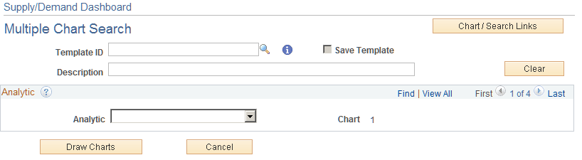

Multiple Chart Search Page
Use the Multiple Chart Search page (IN_SDA_MULTI_SRCH) to create up to four templates.
Navigation:
Inventory, and then Supply/Demand Dashboard. Click the Chart / Search Links button, and then select Multiple Chart Templates.
This example illustrates the fields and controls on the Multiple Chart Search page.
This example illustrates the fields and controls on the Multiple Chart Search page where Analytic is Inventory Demand.
Multiple Chart Search Inventory Demand
Field or Control Description
Template ID
Enter a template ID that indicates the information that is displayed in the template.
Save Template
Select to indicate that the values in the template are to be saved.
Description
Enter a description that identifies the information that is displayed in the template.
Clear
Click the button to clear all values that have been entered in a template.
Analytic
Notice that the system displays 1 of 4 in the Analytic section. The 4 represents the four quadrants of the Supply/Demand Dashboard. You are not required to create four templates.

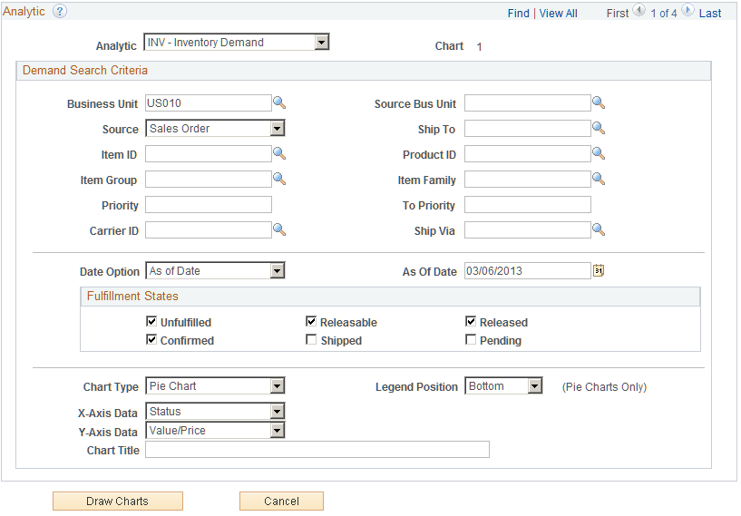

Analytic
Select an analytic option. Options include:
  • INV - Inventory Demand: This chart can display sales orders, material stock requests, material returns, planning requisitions, purchase orders, purchasing requisitions, and maintenance work orders. It is recommended that you create a template and select all the demand options that are applicable to your organization, or specific demand, such as sales order only,
  • INV - Par Location MSRs: This chart can display material stock requests for one or more par inventory business units, par locations, or par groups.
  • MFG – Component Demand (manufacturing – component demand): This chart can display lower level component demand by production type and production area for production ID’s and production areas.
  • MFG – Production Supply (manufacturing – production supply): This chart displays the finished good supply by production type of production area for production ID/s or schedules.
  • PO – Expected Receipts (purchasing – expected receipts): This chart displays purchase orders as a source of supply.
  • PO – PAR Location Orders (purchasing – par location orders): This chart displays purchase orders that are destined as a source of supply for part inventory locations.
When you select an option in this field, the system populates the remaining fields for the template.
Analytic is INV – Inventory Demand
The fields that are displayed represent the search fields and criteria that will be used by the system when displaying the chart. Some field values appear by default based on the Supply/Demand Dashboard User Config – Dashboard Setup Page for your User ID. These fields can be changed on this page.
The fields in the first section are used to search for all demand or a specific demand option. For example, if you want to see all items, then leave the Item ID field blank. If you want to see a specific item, then enter that item in the Item ID field.

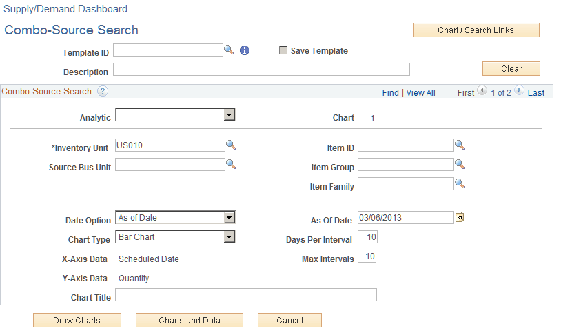

Combo-Source Search Page
Use the Combo-Source Search page (IN_SDA_COMBO_SRCH) to create up to two combination templates.
Navigation:
Inventory, and then Supply/Demand Dashboard. Click the Chart / Search Links button, and then select Combo-Source Search.
This example illustrates the fields and controls on the Combo-Source Search page (1 of 3).
Combo-Source Search (Page 1 of 3)
This example illustrates the fields and controls on the Combo-Source Search page (2 of 3) where Analytic is Supply and Demand.
Combo-Source Search: Supply Demand (Page 2 of 3)
This example illustrates the fields and controls on the Combo-Source Search page (3 of 3) where Analytic is Supply and Demand.
Combo-Source Search: Supply Demand (Page 3 of 3)
The fields that are displayed represent the search fields and criteria that will be used by the system when displaying the chart. Some field values appear by default based on the Supply/Demand Dashboard User Config - Combo Chart Setup Page for your User ID. These fields can be changed on this page.
Combo-Source Search
The system displays 1 of 2 in the Analytic section. The 2 represents the two of the four quadrants of the Supply/Demand Dashboard. You are not required to create four templates.

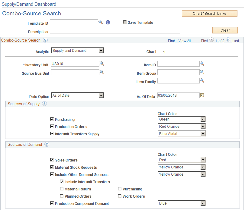

Analytic

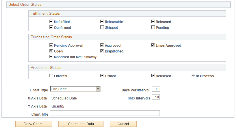

  • Demand: This option displays sections for Sources of Demand and Select Order Status for Fulfillment and Production.
  • Par Replenishment Orders: This option displays sections for Par Replenishment Source and Select Order Status for Fulfillment and Purchasing Order.
  • Supply: This chart displays sections for Sources of Supply and Select Order Status for Fulfillment, Purchasing Order, and Production.
  • Supply and Demand: This chart displays sections for Sources of Supply, Sources of Demand, and Select Order Status for Fulfillment, Purchasing Order, and Production.
When you select an option in this field, the system populates the remaining sections and fields on the page.
Charts and Data
Click this button to have the system create a chart and a table that uses the data selected in your template. Similar to the Draw Charts button, this option provides an opportunity to view the results and make changes to your search criteria.
