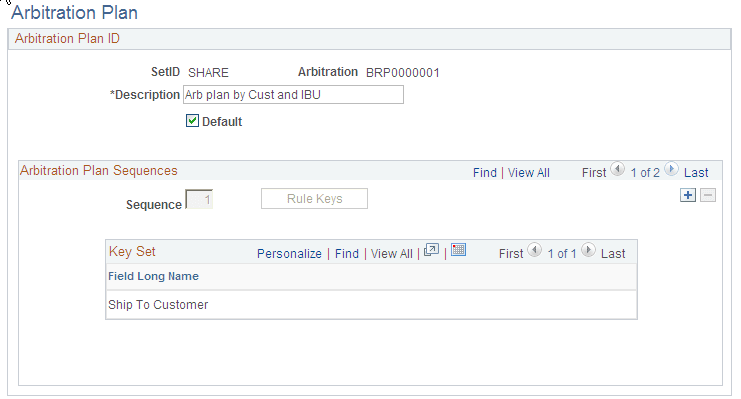

Arbitration Plan Page
Use the Arbitration Plan page (TRFT_RULE_CD) to establish arbitration plans for reservation and backorder defaults.
The arbitration plan determines the sequence in which the system searches for and applies arbitration plans that match to establish reservation and backorder default.
Navigation:
Set Up Financials/Supply Chain, and then Common Definitions, and then Fulfillment Definitions, and then Reservation/Backorder Defaults, and then Define Arbitration Plan Keys
This example illustrates the fields and controls on the Arbitration Plan page. You can find definitions for the fields and controls later on this page.
Field or Control Description
Default
To establish a default arbitration plan, select the check box. After selecting this option and saving the default arbitration plan, the check box no longer appears on this page for other arbitration plans. The system uses the default plan when there isn't an arbitration plan assigned to the PeopleSoft Inventory Business Unit.
Sequence
Displays the sequence number which is automatically generated by the system. You can change this number as long as you do not select a number that has already been used. The sequence number indicates the order in which the system searches the reservation and backorder arbitration plans.
Rule Keys
Click to access the Key Fields page where you can select the combination of elements that determines a match. The keys that you select display in the Key Set group box.

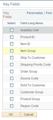

Key Fields Page
Use the Key Fields page (TRFT_KEY_FLD_SEC) to identify key fields for reservations and backorders that determines a match for the arbitration plan.
Navigation:
Click the Rule Keys link on the Arbitration Plan page.
This example illustrates the fields and controls on the Key Fields page. You can find definitions for the fields and controls later on this page.
Key Fields page
Select any number of fields from the available options. The system searches the rules of the arbitration plan for reservations and backorders and applies the rules that match the combination of values that you select.
The key fields available for selection on the arbitration plan are:
  • Customer group
  • Order group
  • Product ID
  • Product group
  • Region code
  • Shipping priority code
  • Ship to customer
  • Sold to customer
  • Source code

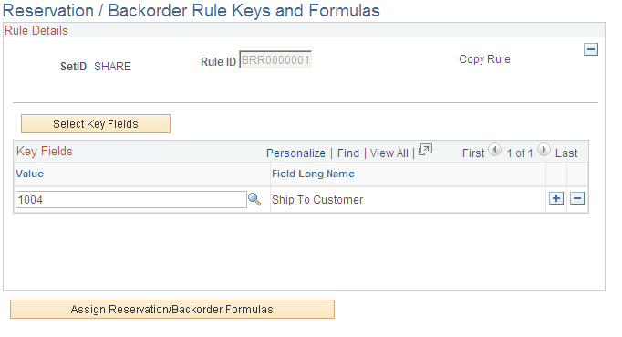

Reservation / Backorder Rule Keys and Formulas Page
To setup reservation backorder rules, use the Rule Defaults (TRFT_SET_GBL) component.
Use the Reservation / Backorder Rule Keys and Formulas page (TRFT_SET) to set up values for the fields that you selected on the Arbitration Plan page.
Navigation:
Set Up Financials/Supply Chain, and then Common Definitions, and then Fulfillment Definitions, and then Reservation/Backorder Defaults, and then Create Fulfillment Rule
This example illustrates the fields and controls on the Reservation / Backorder Rule Keys and Formulas page. You can find definitions for the fields and controls later on this page.
You must first establish an arbitration plan before you can create a rule.
If you are adding a new rule, you will first be directed to the Select Key Fields to add key fields to the rule.
Copy Rule
Use to copy an existing rule to a new rule. In Add mode, click the button after adding a rule sequence and Rule ID. The option is unavailable for selection after you copy a rule.
Select Key Fields
Click to access the Key Fields page. Once they are selected, you can add the value for the key fields in the Key Fields group box.
Values
Use to assign value for the fields you selected on the Select Key Fields page.
Assign Reservation / Backorder Formulas
Click to access the Reservation/Backorder Rule Formulas page.

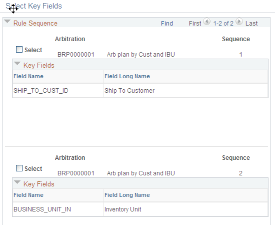

Select Key Fields Page
Use the Select Key Fields page (TRFT_RL_SEQ_SEC) to select a rule sequence for reservation and backorder rules.
Navigation:
Click the Select Key Fields button on the Reservation / Backorder Rule Keys and Formulas page.
This example illustrates the fields and controls on the Select Key Fields page. You can find definitions for the fields and controls later on this page.
Select
Use the check box to select the sequence that contains the key fields that you want to define for the rule.

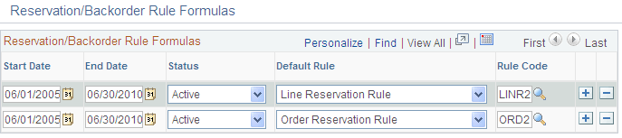

Reservation/Backorder Rule Formulas Page
Use the Reservation/Backorder Rule Formulas page (TRFT_BO_BREAK) to establish reservation backorder rule details.
Navigation:
Click the Assign Reservation/Backorder Formulas button on the Reservation / Backorder Rule Keys and Formulas page.
This example illustrates the fields and controls on the Reservation/Backorder Rule Formulas page. You can find definitions for the fields and controls later on this page.
Start Date, End Date
Enter the dates for the rule.
Status
Choose whether the rule can be Active or Inactive. Only rows with an Active status can be used.
Default Rule
The reservation and backorder rules options are:
Backorder Line Reserve
Line Backorder Rule
Line Reservation Rule
Order Reservation Rule
Rule Code
Add a rule code for the reservation and backorder rule.
The default rules and rule codes are defined in the Fulfillment Rules menu.
