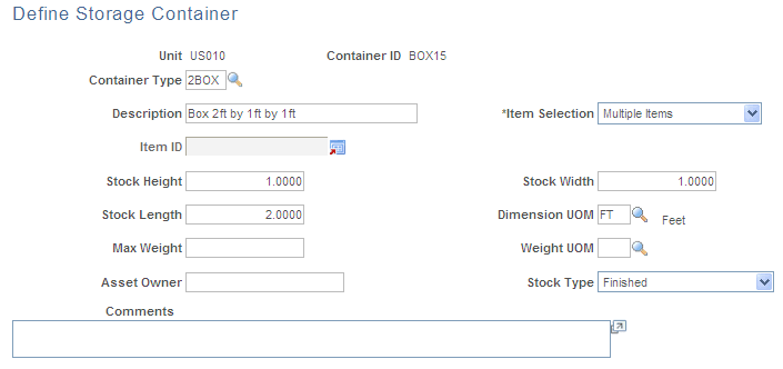

Define Storage Container Page
Use the Define Storage Container page (CNTR_ID_INV) to establish parameters for individual storage containers.
Navigation:
Inventory, and then Maintain Containers, and then Define Storage Container
This example illustrates the fields and controls on the Define Storage Container page. You can find definitions for the fields and controls later on this page.
Use this page if the business unit requires the creation of containers before use, or to override default container values. If the business unit uses only one type of container, and the container does not require detailed attributes, you do not need to enter information here.
Field or Control Description
Asset Owner
Enter the owner of the container. This field is for reporting and inquiry purposes only.
Stock Type
Select the type of stock stored in the container. Values are: Finished, Raw Matl (raw material), and WIP.

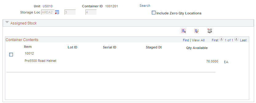

Container Management Page
Use the Container Management page (CNTR_MGMT_INV) to transfer items into or out of a storage container.
Navigation:
Inventory, and then Maintain Containers, and then Container Management
This example illustrates the fields and controls on the Container Management page (1 of 2). You can find definitions for the fields and controls later on this page.
This example illustrates the fields and controls on the Container Management page (2 of 2). You can find definitions for the fields and controls later on this page.
Storage Loc (storage location)
If this is a new container, define a material storage location for the container. If you are managing an existing container, the material storage location information appears. Because a container with quantity can exist in only one location, you cannot modify this information.

Assigned Stock
Displays items currently stored in the container. To remove an item from the container, select its check box and click the Remove from Container button. The selections move to the Unassigned Stock section.
When you remove an item, you can enter the item's new material storage location in the Assigned Stock section. This type of movement is similar to an item transfer.

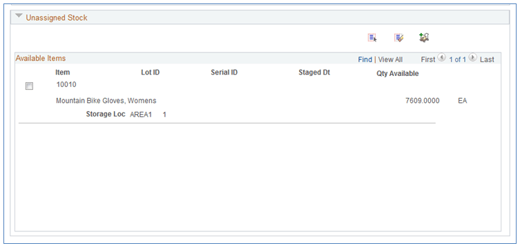

Unassigned Stock
Displays items matching the search criteria. To add an item to the container, select its check box and click the Add to Container button. The selections move to the Assigned Stock section.
You can only move items with available quantity. You can, however, move partial quantities of items, and if negative inventory is allowed, you can choose more than the quantity available by selecting the check box next to a line and overriding the quantity available). In addition, you must move owned items into owned material storage locations and non-owned items into non-owned material storage locations. Finally, to move the entire storage container to a new material storage location, use the Transfers component in the Maintain Inventory menu.
