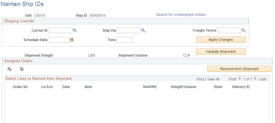

Maintain Ship IDs Page
Use the Maintain Ship IDs page (IN_SHIP_ID_MAINT) to assign demand lines to a shipping ID in order to print various shipping documents before the Shipped or Depleted fulfillment states.
Navigation:
Inventory, and then Fulfill Stock Orders, and then Shipping, and then Maintain Shipping IDs
This example illustrates the fields and controls on the Maintain Ship IDs page (1 of 2). You can find definitions for the fields and controls later on this page.

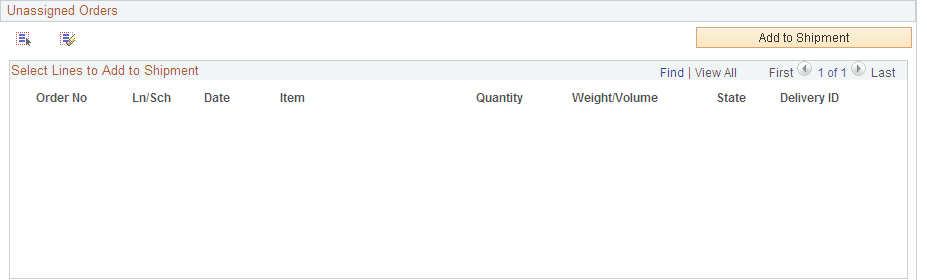

This example illustrates the fields and controls on the Maintain Ship IDs page (2 of 2). You can find definitions for the fields and controls later on this page.
This page updates:
  • The SHIP_HDR_INV table.
  • The IN_DEMAND table. This table stores the SHIP_ID on the demand lines.
  • The SHIP_CNTR_HDR table when the demand lines are in a ship container.
Field or Control Description
Search for Unassigned Orders
Select this link to access the Shipment Selection Criteria page (IN_SHIP_ID_MAINT) where you can enter search criteria for the demand lines to be displayed in the Unassigned Orders group box of this page. Search criteria include the following fields; Ship To Customer, Location Code, Carrier ID, Ship Via Code, Load ID, and Fulfillment State (of the demand line). In addition, you can enter a range of order numbers or a range of scheduled shipment dates and times. Click the OK button to place the search results in the Unassigned Orders group box on the Maintain Ship IDs page.
Shipping Override group box
Enter carrier ID, ship via, freight terms, or scheduled shipment date and time, then click the Apply Changes button to add these values to the demand lines in the Assigned Orders group box. The demand lines are changed when you save this page.
When changing the Carrier ID or Ship Via values on a demand line, be aware that this could impact the current values in the Load ID or Route ID fields for that line. The system issues an online warning when the load ID or route ID will be changed due to a change in the Carrier ID or Ship Via fields.
When changing the scheduled shipment date and time, the system issues an online warning that this invalidates the route ID; if you continue then the system removes the value in the Route ID field on the demand lines.
Weight and Volume
The Shipment Weight and Shipment Volume fields display the current weight and volume of all demand lines assigned to this ship ID. These values use the Weight UOM and Volume UOM defined on the Setup Fulfillment page for the inventory business unit.
See Setup Fulfillment Page.
Validate Shipment
Click the Validate Shipment button to check the shipping information for changes in critical fields. If previously printed shipping documents to do not match the current shipping information, the system can produce an online warning and a warning in the Message Dashboard. You must set up the Message Dashboard functionality to receive any warnings.
See PeopleSoft Events and Notifications Framework
Assigned Orders
This group box displays the demand lines that are currently part of the ship ID.
Remove from Shipment
To remove demand lines from this ship ID, select the lines and click this button. Demand lines with the fulfillment state of Depleted cannot be removed from the ship ID.
Details
Click this link to access the Stock Requests inquiry page for this demand line.
This group box displays demand lines that are not part of the ship ID but have met the search criteria that you have entered on the Shipment Selection Criteria page.
Add to Shipment
To add demand lines to this ship ID, select the lines and click this button. Save the page to finalize your additions. When you add a ship ID to a demand line, the system validates the information using the following rules:
  • You cannot assign the demand lines in a single-ship sales order to different ship IDs. One ship ID must be applied to the entire order.
  • If a product kit must be kept as a whole unit, then only one ship ID can be assigned to all of the component kit demand lines.
  • All demand lines and ship containers inside one ship container must be assigned the same ship ID.
Details
When this page is saved, the system performs a check and displays a warning if a ship ID has been modified after shipping documents have been printed. The system compares the current shipping information to any previously printed shipping documents for the Ship ID. The system compares item ID, quantity shipped, ship ID and line, carrier ID, ship via, ship to customer and address, export flag, and scheduled shipment date and time. If differences are found between the current information and the information printed on the shipping documents, then the system can launch a warning using the Message Dashboard functionality.
