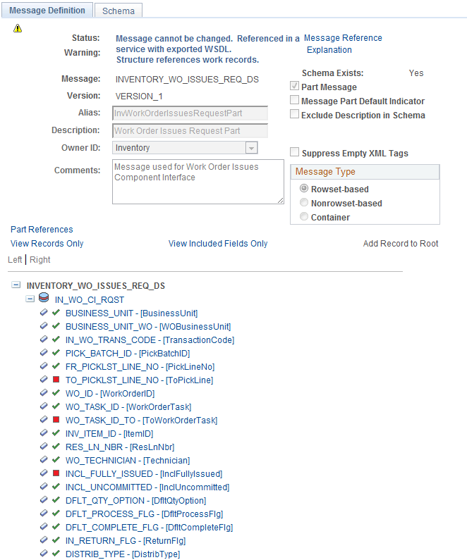

Message Definition Page
Use the Message Definition page (IB_MESSAGE_BUILDER) to view the fields to be used by the service operation within PeopleSoft Integration Broker.
In order to correctly populate the incoming data, review the message definition.
Navigation:
PeopleTools, and then Integration Broker, and then Integration Setup, and then Messages
This example illustrates the fields and controls on the View the fields included in the message used by the INVENTORY_WO_ISSUES service operation (1 or 2). You can find definitions for the fields and controls later on this page.
This example illustrates the fields and controls on the View the fields included in the message used by the INVENTORY_WO_ISSUES service operation (2 or 2). You can find definitions for the fields and controls later on this page.
In order to correctly populate the incoming data, review the message definition. Message definitions provide the physical description of the data that is being sent, including; fields, field types, and field lengths. Messages do not contain any processing logic. All processing logic is defined in service operations, using service operation handlers. In this section, consider some important fields in the INVENTORY_WO_ISSUES_REQ_DS message. This message is used by the INVENTORY_WO_ISSUES service operation to load inventory work order issue transactions into the PeopleSoft system. Once transactions have been loaded into the PeopleSoft system, the IN_WO_ISSUES_CI component interface (CI) populates the correct PeopleSoft component and saves the transaction.
For more information about messages, see the Managing Messages topic of the PeopleTools : PeopleSoft Integration Broker.
The INVENTORY_WO_ISSUES_REQ_DS message consists of three sections:
  • Header section: IN_WO_CI_RQST.
    The header section includes information that applies to the entire transaction. It identifies a specific work order, task, transaction code, and material schedule combination applied to the transaction. If the issue is tied to a pick plan, then this header section also contains the pick batch ID, and pick plan line number. There is always only one header row per transaction. For the Issue Scheduled Part (10) and Issue Pick Line (40) transactions, the Default Complete Flag field and the Default Pick Qty Option field allow you to control the processing of the picking transactions.

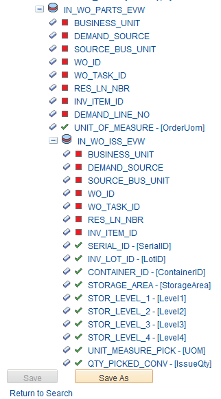

  • Level 1 section: IN_WO_PARTS_EVW.
    The level 1 section identifies a specific work order demand line. There is always only one level 1 row per transaction.
  • Level 2 section: IN_WO_ISS_EVW.
    The level 2 section identifies the material storage location, quantity, lot, and serial ID of the quantity issued or picked. For each header and level 1 row you specify a row for every material storage location, lot, and serial ID that is issued or picked. For example, for one material schedule row on the work order, you issue 10 units from the material storage location A and 5 units from the material storage location B; therefore, two level 2 rows are included, one for 10 units from location A and another row for 5 units from location B.
The following fields are used on the INVENTORY_WO_ISSUES_REQ_DS message:
Field or Control Description
IN_WO_TRANS_CODE (Inventory Work Order Transaction Code field)
Enter a transaction code to define the type of action to be performed. Transaction codes are located in the header section (IN_WO_CI_RQST) of this message. Transaction codes for inventory work order issues are:
  • 10 – Issue Scheduled Part: The Issue Scheduled Parts transaction type issues an item from inventory that is already scheduled on the work order. The item may or may not be committed or reserved in PeopleSoft Inventory.
  • 15 – Issue Unsched Part: The Issue Unscheduled Parts transaction type issues an item from inventory that is not scheduled on the work order. The item is added to the work order schedule parts list and issued to the work order. A new WM_WO_SCHED_MAT row is inserted.
  • 20 – Return to INV: The Return Parts transaction type returns item stock to inventory for an item that was previously issued to the work order. For example, a technician may have unused parts after a repair or maintenance job and these items can be returned to the inventory location.
  • 40 – Issue Pick Line: The Pick Line transaction type enables the technician to enter the picking results (pick line and quantity) for each item picked. A material storage location is entered if the location is different from the location on the pick line. You can use this transaction alone or you can combine it with the Pick Line as Planned and Pick Batch as Planned transactions.
  • 50 – Pick Line as Planned: The Pick Line as Planned transaction type is used to indicate that picking is complete for the pick line. The technician first enters all picking exceptions for the pick line using the Pick Line transaction. Next, the technician sends a Pick Line as Planned transaction from the mobile device to pick the remaining allocations as defined on the pick plan. If the technician picks quantity exactly as the pick line specifies the Pick Line transaction is not needed.
  • 55 – Pick Batch as Planned: The Pick Batch as Planned transaction type is used to indicate that picking is complete for the entire pick batch ID. The Pick Batch as Planned transaction is a good way to report the picking activity for environments in which there are very few exceptions to the picking plan. Any exceptions are entered first using the Pick Line transaction and then the Pick Batch as Planned transaction is used.
  • 60 – Cancel Pick Line: The Cancel Pick Line transaction type enables the technician to cancel a specified pick batch line. A technician may want to cancel a picking plan line for a part that is not needed. If the work order's reservation rule is reserve when the pick list is created, then canceling a pick batch line frees up the item's stock for other orders. If the work order's reservation rule is not reserve when the pick list is created, then PeopleSoft Inventory removes the item allocations to the material storage locations but keeps the item reservations.
  • 65 – Cancel Pick Batch: The Cancel Pick Batch transaction type enables the technician to cancel a specified pick batch ID. A technician may want to cancel a picking plan that has been created in error. Also, a technician may want to cancel a remaining pick batch ID; for example, the technician has entered all the picked quantities, has sent a Pick Line as Planned transaction already, and is not picking any additional parts so he wants to cancel the remaining unpicked parts on the picking plan. If the work order's reservation rule is reserve when the pick list is created, then canceling the pick batch ID frees up the item stock for other orders. If the work order's reservation rule is not reserve when the pick list is created, then PeopleSoft Inventory removes the item allocations to the material storage locations but keeps the item reservations.
DFLT_QTY_OPTION (Default Pick Quantity Option field)
Enter a value of Y or N in this field that is used to control how work order issues process material storage location, lot, and serial ID rows (IN_WO_ISS_EVW rows) that are allocated or pre-allocated. This field is located in the header section (IN_WO_CI_RQST) of this message and is used for the Issue Scheduled Part (10) and Issue Pick Line (40) transactions.
DFLT_COMPLETE_FLG (Default Complete Flag field)
Enter a value of Y or N in this field that is used to control when picking is complete for a Pick Line transaction. This field is located in the header section (IN_WO_CI_RQST) of this message and only used for the Issue Pick Line (40) transaction.
STORAGE_AREA, STOR_LEVEL_1, STOR_LEVEL_2, STOR_LEVEL_3, and STOR_LEVEL_4
Select the material storage location for this transaction. This field is located in the level 2 section (IN_WO_ISS_EVW) of this message.
