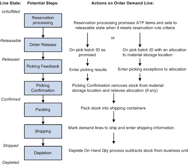

The following diagram illustrates the possible fulfillment steps that you might use for an ATP item The reservations process promises stock to fulfill the order and the Order Release process can (optionally) apply an allocation:
Order Fulfillment Steps for ATP-Items
