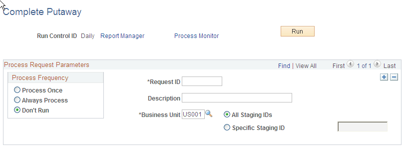

Use the Complete Putaway page (PUTAWAY_REQ_INV) to define parameters for the Complete Putaway process.
Navigation:
Inventory, and then Putaway Stock, and then Complete Putaway, and then Complete Putaway
This example illustrates the fields and controls on the Complete Putaway process page. You can find definitions for the fields and controls later on this page.
The Complete Putaway process uses the Commit Count value that is entered on the Setup Putaway page. This value indicates the number of items to process before issuing a commit statement, which improves performance.
The Complete Putaway process retains the data for the date range specified on the Installation Options - Inventory page and deletes any data past the retention date.
If you are creating custom reports and queries, PeopleSoft Inventory inserts the installation default staged date as the item's staged date for items that do not use staged-date tracking. The default date is established on the Installation Options - Inventory page.
