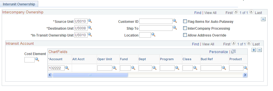

Interunit Ownership Page
DMD_IU_DEFN_INV
Set up all PeopleSoft Inventory business units likely to participate in interunit transfers. Establish the source and destination interunit accounting.
Use this page if you elected on the Installation Options - Inventory page to use PeopleSoft Inventory settings or Both. If you elected to use PeopleSoft General Ledger settings, continue the setup using PeopleSoft General Ledger pages.

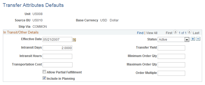

Transfer Attributes Defaults Page
TRANS_UNIT_INV
Define default interunit transfer attributes for a business unit.
To define interunit transfer pairs, use the InterUnit Transfers Accounting component. Use the InterUnit Transfer Accounting component interface (INTERUNIT_DEF_INV) to load data into the tables for this component.
Use the Interunit Ownership page (DMD_IU_DEFN_INV) to set up all PeopleSoft Inventory business units likely to participate in interunit transfers.
Navigation:
Set Up Financials/Supply Chain, and then Product Related, and then Cost Accounting, and then InterUnit Transfers Accounting, and then Interunit Ownership
This example illustrates the fields and controls on the Interunit Ownership page. You can find definitions for the fields and controls later on this page.
If you select Use Both or Use IN BU Settings Only on the Installation Options - Inventory page, then you are using the inventory business unit pairs for some or all of the interunit transfers. If you select Use IN BU Settings Only, you must define all business unit pairs on this page. If you select Use Both, you only need to define the inventory business unit pairs on this page when the intransit account is dependent on the inventory unit, not the GL unit. For pairs not defined on this page, the processes look to the interunit pairs in the centralized interunit and intraunit processor.
Field or Control Description
Source Unit
Enter the Inventory business unit that issues the inventory stock.
Destination Unit
Enter the inventory business unit that receives the inventory stock.
In-Transit Ownership Unit
Enter one of the two business units that owns the intransit inventory.
Flag Items for Auto-Putaway
Select to insert the depleted shipment into the putaway staging tables of the destination business unit automatically. Run the Complete Putaway process to complete the putaway into inventory. Auto-putaway cannot be used for an intercompany transfer.
InterCompany Processing
Select to use the interunit sales approach for transfers between these business units. The system records an intercompany sale with the source inventory business unit recording a sale and the linked billing business unit issuing a voucher (invoice) for the stock transfer to the receiving business unit's payable unit. This approach can be used when transferring stock between separate legal entities. This check box is automatically selected if the business units use different base currencies. If you select this check box, then the intransit ownership unit must be the destination business unit.
Customer ID
If this is an Intercompany relationship, enter the customer ID that you have defined for the destination business unit. PeopleSoft Billing uses this ID to create the voucher (invoice) to send to the destination payables business unit.
Ship To and Location
(Intercompany only) The Ship To Customer ID and Location Code contain the shipping location and shipping defaults for the destination inventory business unit.
Allow Address Override
Select to enable users to override the default shipping address of the interunit stock request.
Intransit Account
Use to define the ChartFields and cost elements for the intransit account. The cost of the inventory stock is stored in this account from shipment to receipt. For each cost element defined, you can enter different intransit ChartFields, thereby capturing each cost separately. Leave the Cost Elmnt field blank to capture all of the costs in the same intransit account (ChartField combination).
To define interunit transfer attributes, use the Transfer Attributes component. To define defaults for interunit transfers, use the Transfer Attributes Defaults component.
Use the Transfer Attributes Defaults page (TRANS_UNIT_INV) to define default interunit transfer attributes for a business unit.
Navigation:
Items, and then Define Items and Attributes, and then Transfer Attributes Defaults
This example illustrates the fields and controls on the Transfer Attributes Defaults page. You can find definitions for the fields and controls later on this page.
For each PeopleSoft Inventory pair, define default transfer attributes for a combination of destination business unit, source business unit, and ship via. PeopleSoft Inventory uses these attributes to calculate the scheduled and arrival dates for interunit transfers. (These dates become the defaults in the Create/Update Stock Request component.) If you integrate with a planning system, that system also uses these attributes when creating automatic interunit transfers.
Intransit Days and Intransit Hours
The time required to transfer stock from the source business unit to the destination business unit for a specified ship via.
Transportation Cost
The cost to transfer stock from the source business unit to the destination business unit. Available if the installation includes PeopleSoft Supply Planning.
Allow Partial Fulfillment
Select to enable the planning system to fulfill interunit transfer requests when the source business unit can only supply part of the request. The system only processes requests for which the partial fulfillment is greater than the minimum defined quantity. Available if the installation includes PeopleSoft Supply Planning.
Transfer Yield
The expected usable portion of the interunit transfer stock, expressed as a percentage. Transfer yield provides a guideline for inflating the planned quantity to account for any loss that may occur during transport. For example, if you have a transfer yield of 90 percent and you enter an interunit transfer with 100 units, the system increases the shipping quantity to 110 units (a 10 percent increase for the expected loss). For the receiving business unit, the system decreases the quantity to the original 100 units, and the amount of the expected loss (10 units) is recorded using the IBU Transfer Adjustments transaction group (042). If you're using auto-putaway processing, the system stages orders automatically in the destination business unit, and the Deplete On Hand Qty (Depletion) process (IN_FUL_DPL) subtracts the expected loss from the shipped quantity to determine the received quantity.
Minimum Order Qty (minimum order quantity) and Maximum Order Qty (maximum order quantity)
The acceptable minimum and maximum quantities for interunit transfers.
Note: PeopleSoft planning products do not use the minimum order quantity.
Order Multiple
The order multiplier for transfers. This value represents the quantity increments that are used when creating new planned orders.
