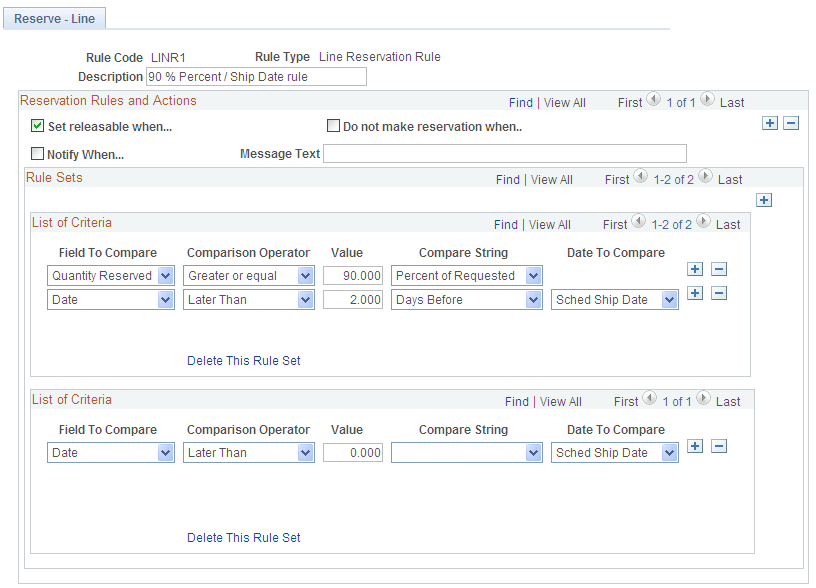

Reservation/Backorder Rules-Reserve Line Page
Use the Reservation/Backorder Rules-Reserve Line page (IN_FL_RULE_SETUP4) to add, change, or review line-level reservation rules and line reservation-backorder rules.
These rules define the specific criteria that must be satisfied by an individual demand line before the demand line is moved to the releasable state.
Navigation:
Inventory, and then Fulfill Stock Orders, and then Fulfillment Rules, and then Reservation and Backorder Rule. Select a Rule Type of Line Reservation Rule.
This example illustrates the fields and controls on the Reservation/Backorder Rules-Reserve Line page. You can find definitions for the fields and controls later on this page.
Defines the specific criteria that must be satisfied by an individual demand line before the demand line is moved to the releasable state. For example, a line reservation rule might be that the reserved quantity must equal or exceed 90 percent of the requested quantity on the line before it is set to the releasable state.
This page defines reservation rules to be applied as line-level reservation rules and line reservation-backorder rules. Whether the rule defined here is applied to a backordered demand line or not, depends on where you add this rule code. The rule code defined here can be applied to the Line Reservation Rule field or the Line Reservation-Backorder field on the Setup Fulfillment-Reservation page or the Create/Update Stock Request-Reservation /Backorder Rules page.
Reservation Actions
Select the action to be performed when the criteria are met by the demand line. Within the Reservation Rules and Actions group box, you can select the Add button just below the title bar and add additional action combinations for this Rule Code. Each combination is evaluated independently.
Field or Control Description
Set releasable when
Select to change the state of the demand line from Unfulfilled to Releasable when the criteria specified in the rule are met. This action releases the demand line for fulfillment processing. If you use line-level (or order level) reservation rules, it is required that one rule use the Set Releasable action.
Do not make reservation when
Select to not reserve inventory stock for this demand line when the criteria specified in the rule are met. The system default is to reserve stock for the demand line even if you cannot yet release the line based on the Set Releasable action. The Do Not Make Reservation action prevents reserving inventory stock when conditions are not yet optimal. For example, you could define a rule to not make reservations if today's date is earlier than the Early Ship Date and the percentage of reservable quantity is less than 90 percent. This prevents stock from being tied up if the condition is not met.
Notify when
Select to send a notification to a specific user or role when the criteria specified in the rule is met. Use the Errors and Warnings Framework to define which user or user role to notify and how the notification should be delivered (Workflow, email, or Message Dashboard).
For example you might wish to notify the warehouse manager if a demand line has reached the late ship date without being fully reserved.
Message Text
If you have selected the action of Notify, enter a specific message to be included in the notification.
The actions of Set releasable when and Do not make reservation when are mutually exclusive since the system always holds the reservation when the releasable action is taken. The Notify action can be used in combination with the other actions. For example, if you release the demand line, then you might want to notify a customer service representative or other individual.
Rule Sets
Within the Rule Sets group box, you can define one or more List of Criteria group boxes for each rule action by selecting the Add button just below the Rule Set title bar. Each List of Criteria group box is evaluated as an OR condition. For example, if you add two List of Criteria group boxes, the action is taken if criteria 1 or criteria 2 are met. Within an individual List of Criteria group box the separate rows are evaluated as AND conditions; both rows must be met to initiate the action.
Field to Compare
Select the type of comparison to be made. For line-level reservation rules, the options are:
  • Date: Compare today's date to a date on the demand line.
    A field displays at the end of the row to enter the demand line dates of; Arrival Date, Early Ship Date, Late Ship Date, or Scheduled Ship Date.
  • Quantity Reserved: Compare the quantity that has been soft-reserved on this demand line to a percentage of the requested quantity or a static value expressed in the item's standard UOM.
    For example, if the reserved quantity is greater than 90 percent of the requested quantity and/or the reserve quantity is greater than 3 units of the item in its standard UOM.
Comparison Operator
Select how the value in the Field to Compare field should be compared to the demand line. If Date is in the Field to Compare field, then your choices are Earlier Than, Earlier or Equal To, Equals, Later Than, or Later or Equal To. If Quantity Reserved is in the Field to Compare field, then your choices are Equal To, Greater or Equal, Greater Than, Less Than, or Less Than or Equal.
Operand
Enter a numeric value (days, percentage, or number of units) for the comparison.
Compare String
Select the compare value. If Date is in the Field to Compare field, then your choices are Days After or Days Before. If Quantity Reserved is in the Field to Compare field, then your choices are Units in Standard UOM or Percentage of Requested.
Delete This Rule Set
Select this link to remove the rule set from this rule.
For example, the above page shot displays a rule that enables you to release a demand line if it is 3 days before the scheduled ship date and at least 90 percent of the quantity has been reserved or if it is past the scheduled ship date then release whatever quantity is reserved.
If the Use Closure Calendar check box is selected on the Setup Fulfillment- Reservation page, then the system takes closure dates into consideration when comparing today's date to the date on the demand line.

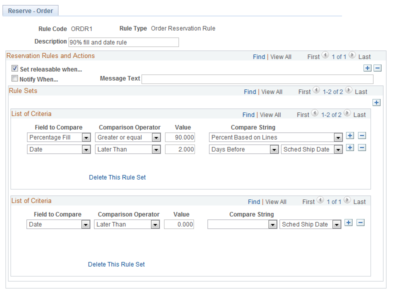

Reservation/Backorder Rules-Reserve Order Page
Use the Reservation/Backorder Rules-Reserve Order page (IN_FL_RULE_SETUP5) to add, change, or review order-level reservation rules.
These rules define the specific criteria that must be satisfied by the entire order or grouping of demand lines before the demand lines are moved to the releasable state.
Navigation:
Inventory, and then Fulfill Stock Orders, and then Fulfillment Rules, and then Reservation and Backorder Rule. Select a Rule Type of Order Reservation Rule.
This example illustrates the fields and controls on the Reservation/Backorder Rules-Reserve Order page. You can find definitions for the fields and controls later on this page.
Defines the specific criteria that must be satisfied by an entire order or grouping of demand lines (unit of work) before the individual demand lines are moved to the releasable state. For example, an order-level reservation rule might be that all the lines in an order must reserve 100 percent of their reserved quantity before the order can move downstream. Order-level reservation rules are evaluated after line-level reservation rules. A demand line must pass both rules to be set the releasable state.
Reservation Actions
Select the action to be performed when the criteria are met by the unit of work. Within the Reservation Rules and Actions group box, you can select the Add button just below the title bar and add additional action combinations for this Rule Code. Each combination is evaluated independently.
Set releasable when
Select to change the state of the demand lines in the order or unit of work from Unfulfilled to Releasable when the criteria specified in the rule are met. This action releases the demand lines for fulfillment processing. If you use line level or order-level reservation rules, it is required that one rule use the Set Releasable action.
Notify when
For example you might wish to notify the warehouse manager if an order has reached the late ship date without all lines in the order being fully reserved.
Message Text
Rule Sets
Field to Compare
  • Date: Compare today's date to a date on the order or unit of work.
    Select Days After or Days Before in the Compare String field.
    Note: If the Use Closure Calendar check box is selected on the Setup Fulfillment- Reservation page, then the system takes closure dates into consideration when comparing today's date to the date on the demand line.
  • Order Volume: Compare the total volume of all reserved items in the order or unit of work.
    This comparison can:
    1. Compare the total volume that has been reserved or promised to the total volume that has been requests by entering Percentage of Requested Volume in the Compare String field.
      For example, releasing the order when 90 percent of the total cubic feet of this order or unit of work has been reserved.
    2. Compare the total volume that has been reserved to a static volume by entering Units in Standard Volume UOM in the Compare String field.
      For example, releasing the order when 10,000 cubic feet of stock has been reserved for this order or unit of work.
      Note: Volume calculations are expressed in the unit of measure entered in the Volume UOM field of the Setup Fulfillment page. This field must be populated in order to use the order volume comparison.
  • Order Weight: Compare the total weight of all reserved or promised items in the order or unit of work.
    1. Compare the total weight that has been reserved to the total weight that has been requests by entering Percentage of Requested Weight in the Compare String field.
      For example, releasing the order when 90 percent of the total weight of this order or unit of work has been reserved.
    2. Compare the total weight that has been reserved to a static weight by entering Units in Standard Weight UOM in the Compare String field.
      For example, release the order if the reserved weight greater than 500 LBS.
      Note: Weight calculations are expressed in the unit of measure entered in the Weight UOM field of the Setup Fulfillment page. This field must be populated in order to use the order weight comparison.
  • Percentage Fill: Compares in two ways:
    1. Compare the number of reserved lines to the total number of lines on the order or unit of work by entering Percentage Fill by Line Count in the Compare String field.
      For example, release the order if 95 percent of all the order lines have reserved quantities.
    2. Compare the number of units reserved for all lines to the total number of units in all the lines on the order or unit of work by entering Percentage Fill by Total Units in the Compare String field.
      This comparison is performed regardless of the unit of measure. For example, if there are two demand lines within the unit of work; the first has a requested quantity of 20 EA and reserved quantity of 8 EA, and the second demand line has a requested quantity of 5 boxes and reserved quantity of 2 boxes, then the total units reserved is 10 and the total units requested is 25; therefore, the fill percentage would be 40 percent.
Comparison Operator
Select how the value in the Field to Compare field should be compared to the demand line. If Date is in the Field to Compare field, then your choices are Earlier Than, Earlier or Equal To, Equals, Later Than, or Later or Equal To. If Order Volume, Order Weight, or Percentage Fill is in the Field to Compare field, then your choices are Equal To, Greater or Equal, Greater Than, Less Than, or Less Than or Equal.
Operand

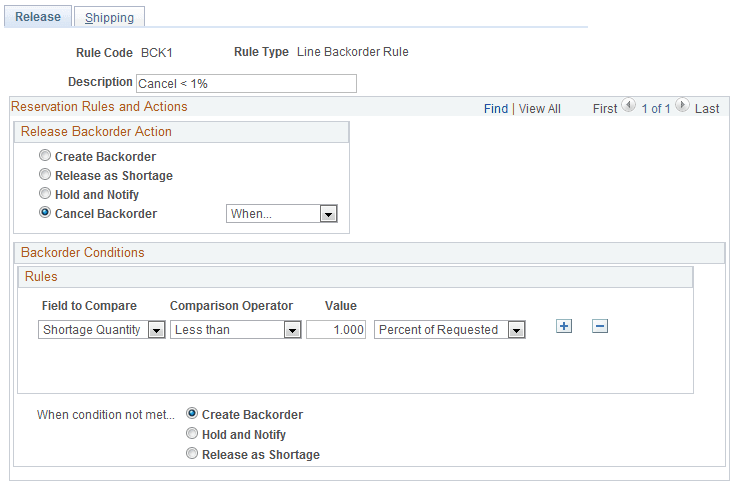

Backorder Rule-Release Page
Use the Backorder Rule-Release page (IN_FL_RULE_SETUPBR) to add, change, or review the backorder rule at release.
Once a demand line has passed the set releasable criteria of both the line-level reservation rule and the order-level reservation rule, the backorder rule at release determines how any unreserved quantities are handed.
Navigation:
Inventory, and then Fulfill Stock Orders, and then Fulfillment Rules, and then Reservation and Backorder Rule. Select a Rule Type of Line Backorder Rule.
This example illustrates the fields and controls on the Backorder Rule-Release page. You can find definitions for the fields and controls later on this page.
Release Backorder Action
Select the action to be performed for shortage demand lines being set to releasable status.
Create Backorder
Select to create a backorder for the shortage quantity. If the entire demand line cannot be reserved then the demand line is backordered. If the demand line can be partially reserved, then the demand line is split into two demand lines.
For example, if you have ordered 100 units of an item but only 80 units are available, the system creates a second demand line for the order to put 20 units on backorder. Demand line number 1, for 80 items, is moved into the releasable state where it can be picked and shipped. Demand line number 2, for 20 units, remains in the unfulfilled state until additional quantity becomes available. If you later put away 25 units of the ordered item, the second demand line is be reserved and set to the releasable state as long as the backordered demand line passes the line-level and order-level reservation rules.
Release as Shortage
Select to enable the demand line with a shortage to flow downstream through the fulfillment process. The shortage demand line is visible on the order release pick plan and shipping pages, enabling the warehouse to fulfill the shortage when stock becomes available. If the shortage cannot be fulfilled, then, at shipping time, the backorder rule for shipping creates a backorder or cancels a backorder for this demand line.
Hold and Notify
Select to hold the demand line with a shortage in the unfulfilled state and send a notification to the user that a backorder decision needs to be made. The demand line is not picked back up again by the Reserve Materials process or online reservations. The demand line stays on hold until a manual decision to release or backorder is made using the Shortage Workbench.
Use the Errors and Warnings Framework to define which user or user role to notify and how the notification should be delivered (Workflow, email, or Message Dashboard). The message text will read A backorder decision is required for this demand line and includes the demand key information.
Cancel Backorder
Select to cancel a backorder for the shortage quantity. Cancel backorder has two options:
  • Always: Cancel the backorder under all conditions.
  • When: Cancel the backorder when the criteria in the Backorder Conditions group box are met and if the conditions are not met, what action should be taken (create backorder, notify, or release shortage).

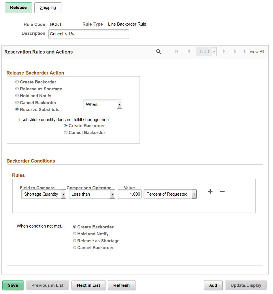

Reserve Substitute
Select to reserve substitutes for the shortage quantity. Reserve Substitute has two actions:
  • Always: Reserve substitutes under all conditions.
  • When: Reserve the substitutes when the criteria in the Backorder Conditions group box are met. If the conditions are not met, you can create a backorder, hold and notify, release shortage, or cancel backorder.
Currently, you can automatically reserve the substitute items when:
  • The original item is not part of a kit.
  • The original item is not a configured item.
  • The demand line is not backordered.
  • Both the original item and substitute item are soft-reserved items.
If you have selected Cancel Backorder using the When option, then enter the criteria to determine when the Cancel Backorder action should be taken.
Field to Compare
Shortage Quantity: Compare the shortage quantity on the demand line to a percentage of the requested quantity or a static value expressed in the item's standard UOM. For example, if the shortage quantity is greater than 90 percent of the requested quantity and/or the shortage quantity is greater than 3 units of the item in its standard UOM.
When condition not met
Select the action that should be taken when a shortage demand line does not meet the criteria to cancel backorder.
