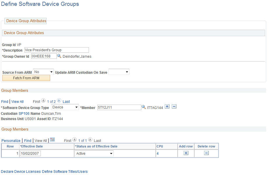

Define Software Device Groups Page
Use the Define Software Device Groups page (IT_SWGRP_DEFN) to define software device groups to associate devices (by Serial ID) to an administrator for the ultimate purpose of linking software licenses to assets rather than users.
Navigation:
Set Up Financials/Supply Chain, and then Product Related, and then IT Asset Management, and then ITAM Device Groups, and then Define Software Device Groups
IT Asset Management, and then IT Asset Definitions Center, and then Resource Settings, and then Device Groups, and then Define Software Device Groups
This example illustrates the fields and controls on the Define Software Device Groups page. You can find definitions for the fields and controls later on this page.
Field or Control Description
Group Id
Assign a software device Group Id.
Group Owner Id
Select the Employee ID of the device group administrator or content manager. The content manager controls the software contents of the machines in the device group.
Source From ARM
Select from the following values:
  • Yes - The Device Group is dynamically defined to include any asset with:
    • IT Subtype that has the Authorize Software by Device attribute/flag selected, AND
    • The Group Owner ID is the Asset Custodian.
  • No - The Members of the Group must be manually entered.
Note: If the Asset Custodian field value is changed in the ARM, then the asset will no longer be included in the Software Device Group.
The page elements that are visible and active on this page depend upon your selection in this field. If you select Yes to populate the machines from the Asset Repository, the resulting grid is entitled Group Owner's Devices in ARM and the data appears as display-only. If you select No to add your own devices, the resulting grid is entitled Group Members.
When accessing a software device group that has a Source From ARM value of Yes, the Group Members grid appears only in Include History or Correct History modes (if there is associated data in the device group).
Note: If you change the Source From ARM field from No to Yes, a new effective-dated row for each active group member (groups included) is inserted with an effective date equal to the current date, a Status as of Effective Date equal to Inactive, and a row-level Source From ARM equal to Yes. Even though the row-level values are ignored due to the Device Group's Source From ARM value, the detail rows provide an audit trail showing the effective date that the group definition Source From ARM value was changed to Yes. If you change the Source From ARM field from Yes to No, a new effective-dated row is added in the Group Members grid for all assets of which the Group Owner is the custodian (all devices in the Group Owner's Devices in ARM grid). The Status as of Effective Date will be Inactive, and the Source from ARM will be equal to No.
Update ARM Custodian On Save
Select Yes to activate a Component Interface that, upon saving, changes the value of the Custodian field within the Asset Repository to this device group's owner for every Device line in the grid where the current effective dated row is Active. Select No to leave the Custodian field in the ARM unchanged.
Note: This field is active only when you select No for the Source from ARM value and there are active devices in the Group Members grid.
Fetch From ARM
Click this button to retrieve the assets assigned to this content manager as custodian from the ARM. This is a one-time event and creates a static list. The difference between this and Source from ARM option is that the Source from ARM selection is dynamic and will continue to source from the ARM when the ARM changes. The Fetch from ARM is static and only retrieves the assets from the ARM at the instant it is invoked. You may also start with an empty list and build a Fetch from ARM group selecting asset by asset.
The Fetch from ARM button inserts an effective-dated row for all assets of which the group owner is the custodian. . If you want to have assets sourced from the ARM and additional assets not associated with this custodian (content manager), select Fetch from ARM first, then manually add additional assets. Fetch from ARM has no impact on groups that have been added to the device group.
Note: This field is active only when you select No for the Source from ARM value.
Display Effective Date
Enter an effective date and click the Display button to view the current effective-dated rows as of the date supplied. The default value is the current date.
Note: This field appears only when selecting Include History or Correct History.
Display button
Click this button to view all current effective-dated rows as of the date entered in the Display Effective Date field. Upon clicking the Displaybutton, all data on the page is presented as display-only, the Save button is no longer effective, and all values are consolidated in the same grid.
Note: Although this field appears only when selecting Include History or Correct History, it is used for query purposes and not for modifying data.
