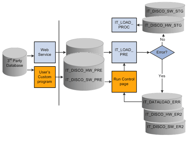

The following diagram represents the process flow for the Agnostic Integration framework:
Agnostic Integration process flow
  • Select an integration option.
  • Run the data load process (IT_LOAD_PRE).
  • Identify preload errors.
  • View preload errors.
Selecting an Integration Option
The following section discusses the two options for Agnostic Integration:
  • Manual
  • Web Service
The two options, Manual and Web Service, are processed as mutually exclusive tasks (TASK_ID). If you elect to use both options to integrate discovery data, you may lose the ability to filter out duplicate Serial ID errors. Since the two sources of data are processed separately, the data validation performed by the IT_LOAD_PROC will only check for duplicate Serial IDs within the one source.
Manual Option
This option is selected when using a custom program to manually load the pre-staging tables for hardware and software discovery data (IT_DISCO_HW_PRE and IT_DISCO_SW_PRE). When using this method, keep in mind the following points:
  • Create a custom program or use a third-party program to populate the pre-staging tables.
  • Fix or remove duplicate or invalid Serial IDs before loading the pre-staging tables. An example of an invalid Serial ID might be a blank value.
  • After ensuring that all discovery data is loaded to the pre-staging tables, use the run control page, Integrate Discovery Data, to submit the IT_LOAD_PRE Application Engine program, which processes data from the pre-staging tables and loads them to the staging tables. This process also calls the IT_LOAD_PROC Application Engine process to perform validations, translations, and transformations of the data.
  • Ensure there is no orphan software data. All integrated software data (IT_DISCO_SW_PRE) must have a parent record (IT_DISCO_HW_PRE). This is consistent with the existing expectation of data that is provided to ITAM from third party systems.
Web Service Option
The web service option uses an asynchronous inbound XML message to populate the pre-staging tables for hardware and software discovery data (IT_DISCO_HW_PRE and IT_DISCO_SW_PRE). When using this method, keep in mind the following points:
  • This method does not require a tightly coupled XML connector or dependence upon a preexisting partnership with a particular discovery supplier to populate the pre-staging tables.
  • The web service (PROCESS_DISCOVERYDATA) populates the pre-staging tables and submits the IT_LOAD_PRE Application Engine process automatically; however, reprocessing of web service errors is submitted from the Integrate Discovery Data run control page.
  • The web service implements an xml file-counting solution, which leverages the xml node FILE_CNT. After receiving all of the xml files, the IT_LOAD_PRE process is submitted automatically.
  • Do not introduce duplicate or invalid Serial IDs in the xml. An example of an invalid Serial ID might be a blank value.
  • Ensure that the BATCH_ID node value is the same throughout the XML file.

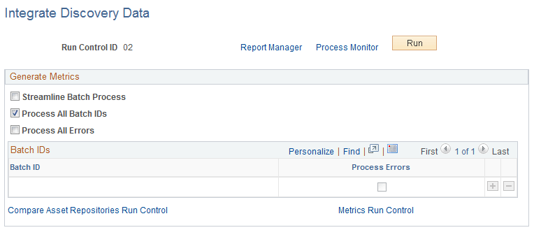

Integrate Discovery Data run control Page
Use the Integrate Discovery Data run control page to submit the IT_ LOAD_PRE Application Engine process when the pre-staging tables are populated manually by a custom program. Additionally, this page can be used to process pre-staging errors resulting from either method (manual or web service).
Use the Integrate Discovery Data page (IT_PLOAD_RUN ) to set run control options to submit the IT_LOAD_PRE Application Engine process, Select to process all Batch IDs and all errors or specific Batch IDs and errors.
Navigation:
IT Asset Management, and then Asset Discovery and Validation, and then Integrate Discovery Data
This example illustrates the fields and controls on the Integrate Discovery Data page. You can find definitions for the fields and controls later on this page.
Field or Control Description
Streamline Batch Process
Select to enable the option to automatically submit (streamline) the Compare Asset Repository and Generate Metrics processes.
Process All Batch IDs
Select to process all the unique Batch IDs in the pre-staging table. When selected, any existing rows in the grid are disabled. The IT_LOAD_PRE batch program processes all data in the pre-staging tables and overrides the Batch IDs that are specified in the grid. However, if there are rows in the grid where Process Errors is selected, the errors related to that Batch ID are also included as input for the IT_LOAD_PRE batch process.
Process All Errors
Select to process all the rows in the pre-staging error tables. When selected, the Process Errors check box is disabled in any existing grid row, The IT_LOAD_PRE batch program processes all data in the pre-staging error tables. It overrides the Process Errors option at the grid level.
Batch IDs
Batch ID
Select one or more specific BATCH_IDs for the IT_LOAD_PRE Application Engine program to process. If the Process All Batch IDs check box is selected, this field is disabled.
Process Errors
Select to specify if pre-stage errors are to be processed for the selected BATCH_ID. If Process All Batch IDs or Process All Errors is selected, this field is disabled.
Compare Asset Repositories Run Control and Metrics Run Control
Click the links that are provided to access the Compare Asset Repository and Generate Metrics run control pages. Verify or change the run control parameters for the two automatically-created run controls.

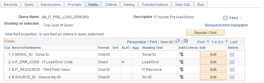

IT Assets Pre-load Errors Page
Run the delivered query, AM_IT_PRE_LOAD_ERRORS, to retrieve a report that lists the Serial IDs of the devices that fail any of the preload (pre-stage) error edits resulting from the IT_LOAD_PRE process. ITAM requires that Serial IDs be unique in each application in order to successfully integrate the discovered assets into ITAM. This query identifies duplicate Serial IDs.
Use the IT Assets Pre-load Errors page (AM_IT_PRE_LOAD_ERRORS) to run this query to identify errors from the IT_LOAD_PRE process.
The query lists the Serial IDs of the devices that fail any of the pre-stage error edits.
Navigation:
Reporting Tools, and then Query, and then Query Manager, and then AM_IT_PRE_LOAD_ERRORS
This example illustrates the fields and controls on the AM_IT_PRE_LOAD_ERRORS query.
The report provides the following fields Serial ID, IT Load Error Code, Third Party Value and Source Key ID.
